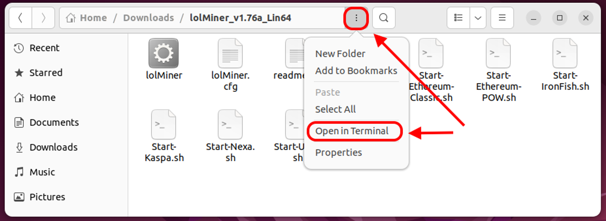

  1. Navigate to the folder containing the downloaded miner.

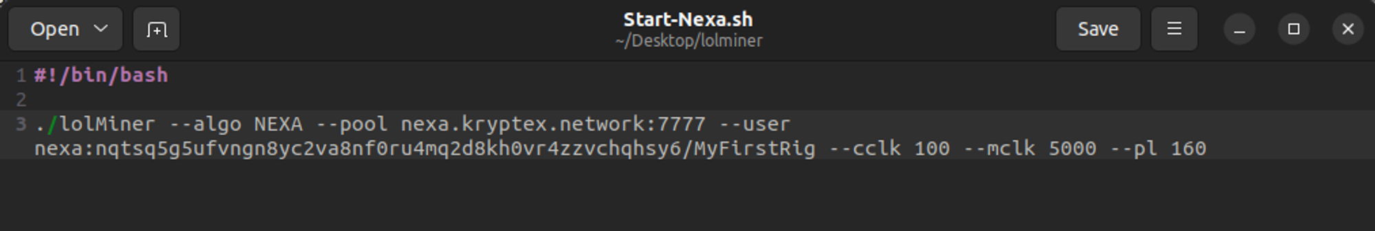

  2. Open the shell script (sh file) corresponding to the cryptocurrency you intend to mine.
  3. Insert the overclocking commands after the wallet address and worker name, separated by spaces. *In this example, we'll overclock the core by 100 MHz, set the memory frequency to 5000 MHz, and limit power consumption to 160 Watts.
    --cclk 100 — increases the core frequency by 100 MHz.
    --mclk 5000 — sets the memory frequency to 5000 MHz.
    --pl 160 — limits the power consumption of the graphics card to 160 Watts.

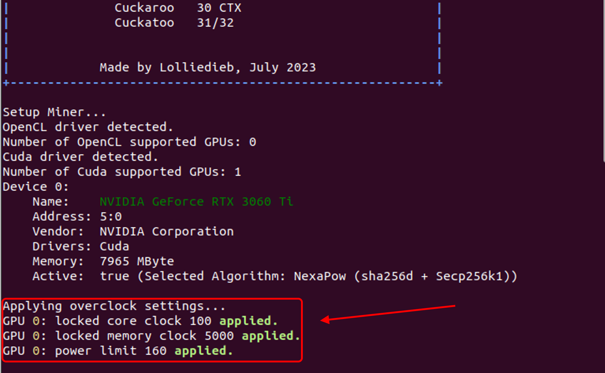

  5. Launch the miner by executing the command ./Start-Nexa.sh. The miner will initiate using the settings from your Start-Nexa.sh script. In the miner window, you'll notice that the specified overclocking settings have been applied.

  1. Open the terminal from your miner directory.

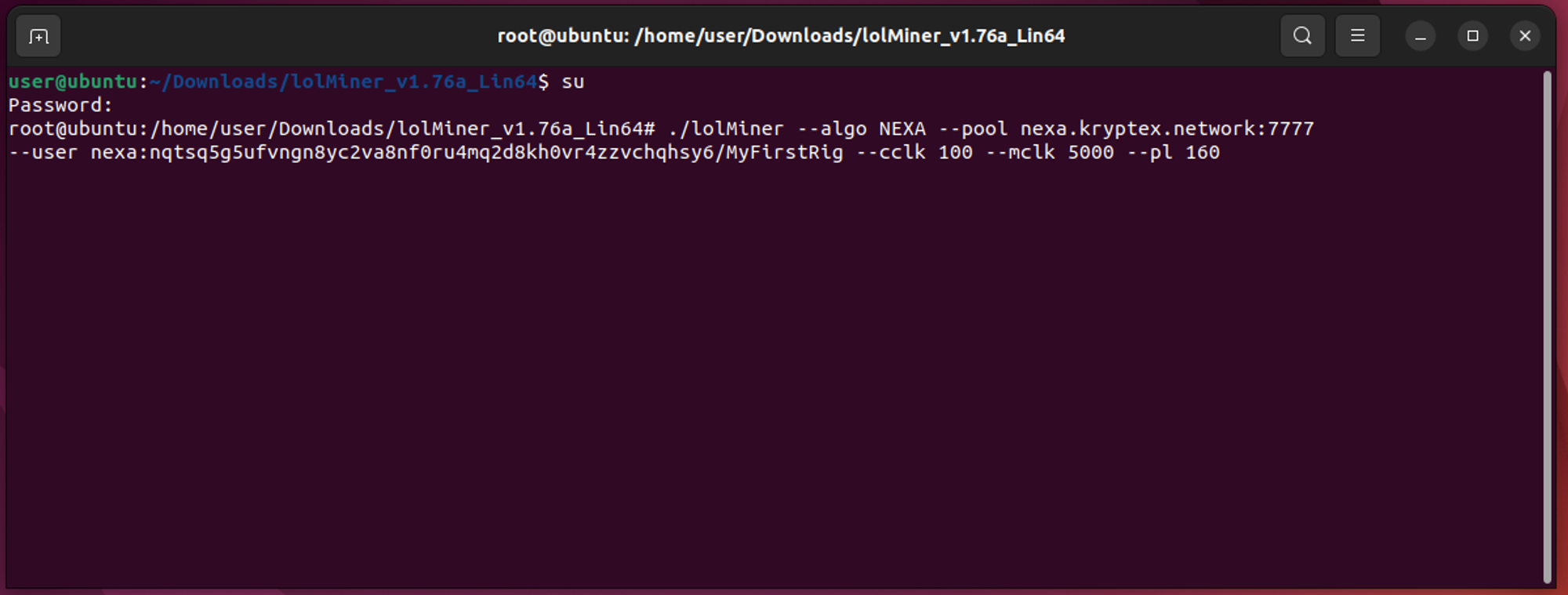

  2. Use the command su or sudo su to gain administrator privileges and enter your account password.
  3. Enter the miner start command in the terminal, adding the overclocking commands after the wallet address and worker name, separated by spaces. *For example, let's increase the core clock by 100 MHz, set the memory frequency at 5000 MHz, and cap the power consumption at 160 Watts.
    --*cclk 100 — increases the core clock by 100 MHz.
    --mclk 5000 — sets the memory frequency at 5000 MHz.
    --pl 160 — limits the graphics card power consumption to 160 Watts.
    Example:
    ./lolMiner --algo NEXA --pool nexa.kryptex.network:7026 --user nexa:nqtsq5g5ufvngn8yc2va8nf0ru4mq2d8kh0vr4zzvchqhsy6/MyFirstRig --cclk 100 --mclk 5000 --pl 160
  4. Press Enter, and the miner will initiate with the specified settings, applying your overclocking configurations.

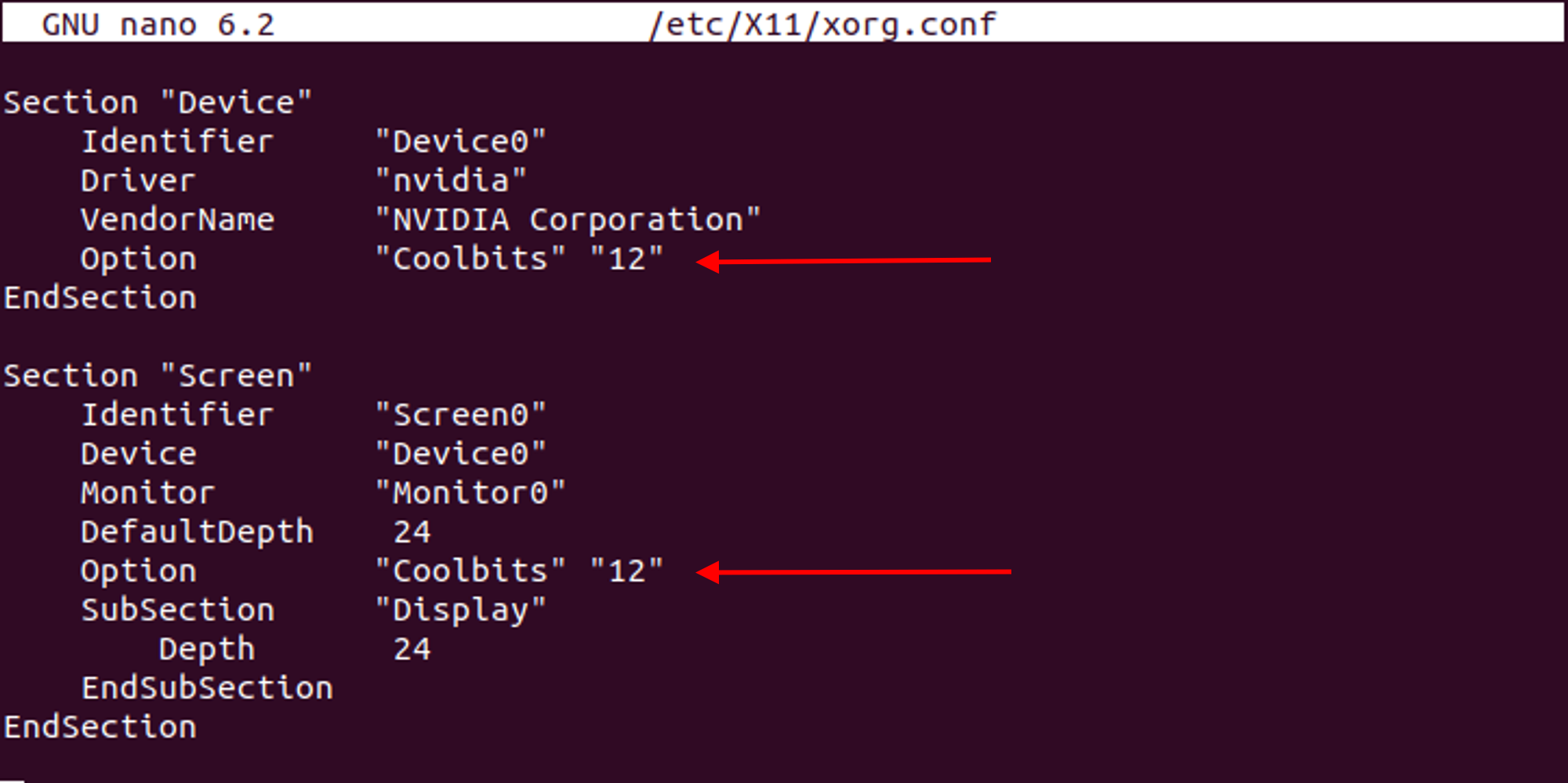

  3. Open the xorg.conf file using sudo nano /etc/X11/xorg.conf.
  4. Locate the sections Section "Device" and Section "Screen" within the file.
  5. Add the following setting to both sections, as shown in the screenshot: Option "Coolbits" "12"
  6. Save the changes to the file by pressing Ctrl+S and close the file with Ctrl+X.

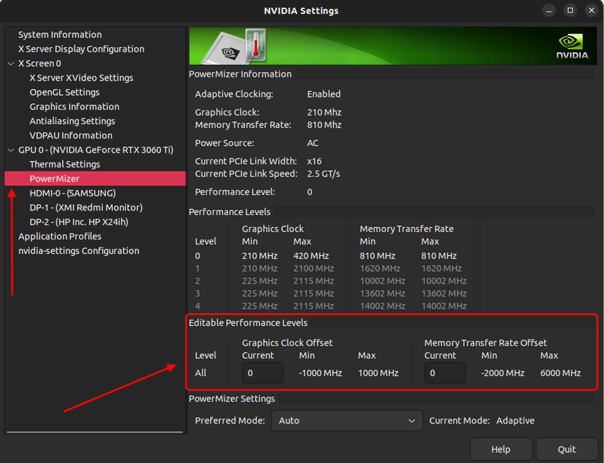

  10. Run the command nvidia-settings.
  11. The nvidia-settings window will open. Navigate to the PowerMizer tab.
  12. Input your desired settings in the Editable performance levels.
  13. Close the program after making the adjustments.
  14. Launch the terminal and execute the command nvidia-smi -i 0 -pl 140 if you wish to change the Power limit.

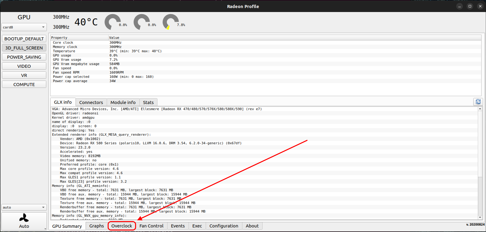

  4. Once the installation is complete, you will see Radeon Profile in the list of applications. You can open it from there or execute the command radeon-profile.

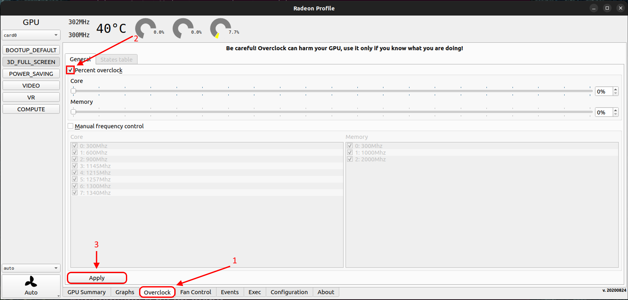

  5. After the Radeon Profile is opened, go to the Overclock tab by clicking on it in the bottom part of the program.
  6. Enable Percent overclock and overclock your graphics card.
    Please note that overclocking is done in percentages. For example, to overclock an RX 580 by 100 MHz, you need to divide 100 MHz by its maximum frequency of 1340 MHz, resulting in 7.5%. You can find the maximum core frequency of your graphics card in the Overclock tab under the Manual Frequency control section, number 7, or for video memory, number 2.
  7. After all is done, press Apply to apply the changes you made. Ready! Your settings will be used for your video card until you change them in the Radeon Profile program.

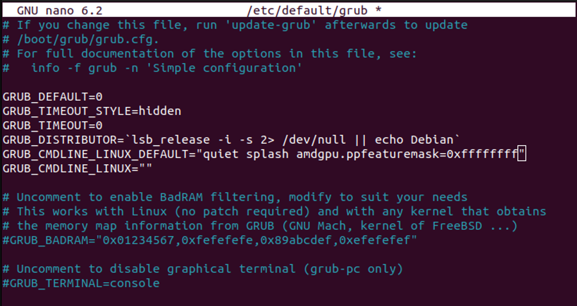

  11. Open the file sudo nano /etc/default/grub.
  12. Find the line GRUB_CMDLINE_LINUX_DEFAULT= and add amdgpu.ppfeaturemask=0xffffffff" at the end as shown in the screenshot.
  13. Save the file using Ctrl+S and exit by pressing Ctrl+X.
  14. Run the command grub-mkconfig -o /boot/grub/grub.cfg.
