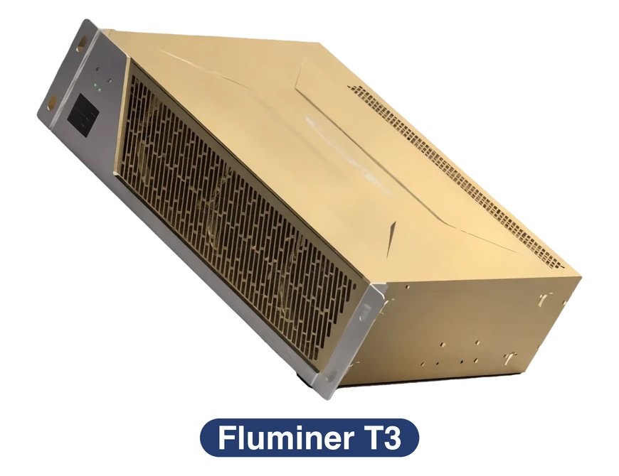

The Fluminer T3 is the first Bitcoin miner from Fluminer, a brand widely known for its popular Litecoin and Dogecoin miners (L1 and L2 series). The device runs on the SHA-256 algorithm, delivers 115 TH/s hashrate at 1700W power consumption, and achieves 14.78 J/TH energy efficiency — significantly better than the Antminer S21's 17.5 J/TH.
The key advantage of the Fluminer T3 is its noise level of ≈50 dB. The device features a proprietary dual counter-rotating turbine fan system with magnetic levitation bearings, making it one of the quietest Bitcoin ASIC miners suitable for bedroom, study room, or small office use.
The device is designed for home and office use — a standard 220–240V outlet, compact size, and quiet operation make it suitable for virtually any room.

| Model | Algorithm | Coin | Hashrate | Consumption | Dimensions (mm) | Weight |
| Fluminer T3 | SHA-256 | BTC, FB, XEC, DGB, BCH, QUAI | 115 TH/s (±5%) | 1700 W (±10%) | 447 × 350 × 131 | 12.8 kg |
Additional specifications:
- Energy efficiency: 14.78 J/TH
- Noise level: ≈50 dB — like a conversation or library. For reference, standard ASICs run at 76 dB (like a vacuum cleaner)
- Input voltage: 220–240V AC, 50–60 Hz, up to 16A
- Network interface: Ethernet RJ45 10M/100M + WiFi 2.4G/5.0G
- Operating temperature: 0°C — 35°C
- Cooling: Air cooling with dual counter-rotating turbine fans and magnetic levitation bearings

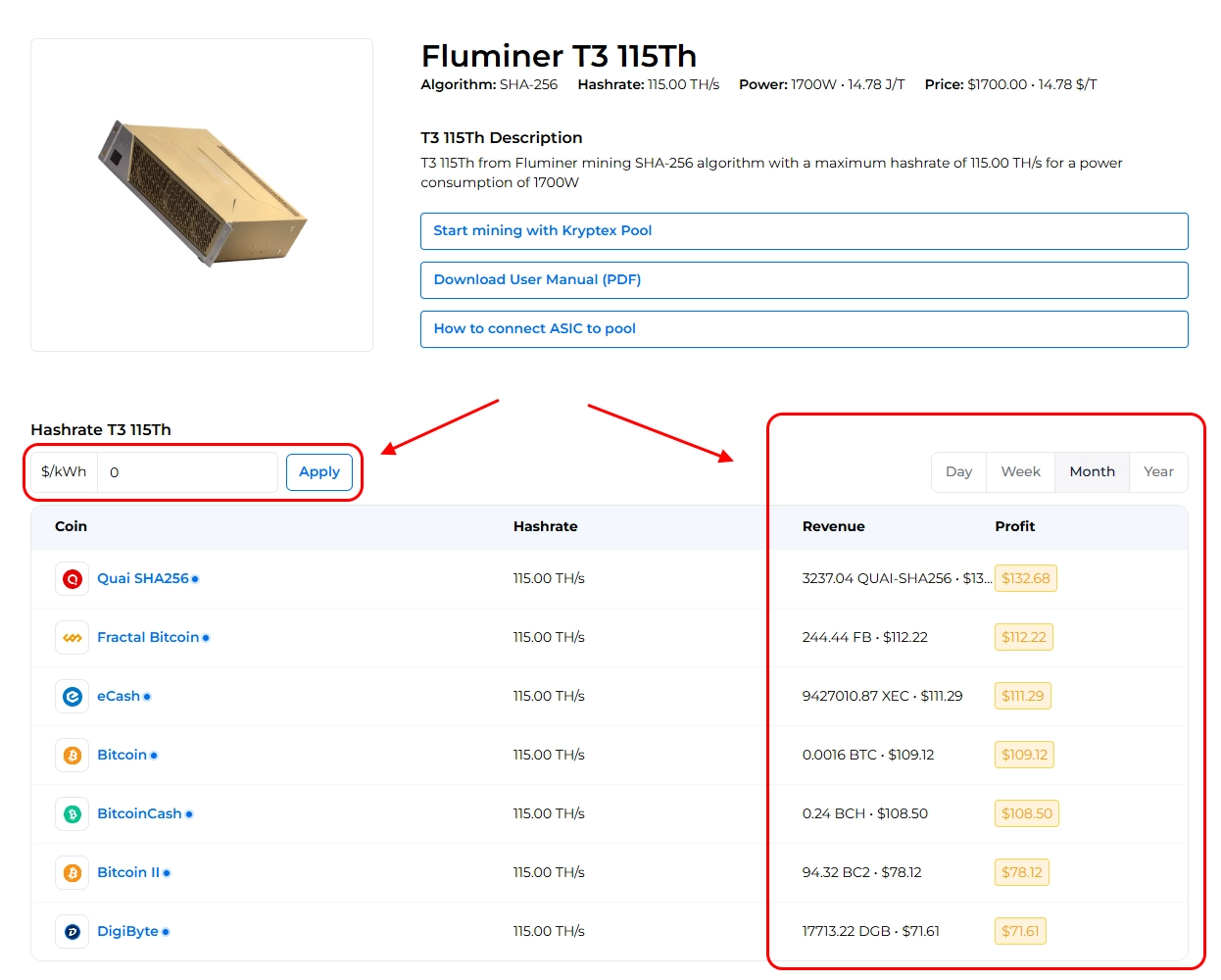

Fluminer T3 Profitability
We recommend checking the actual profitability in our mining calculator, where you can also calculate profit including your electricity costs.
👉 Check the profitability of Fluminer T3 on the mining calculator

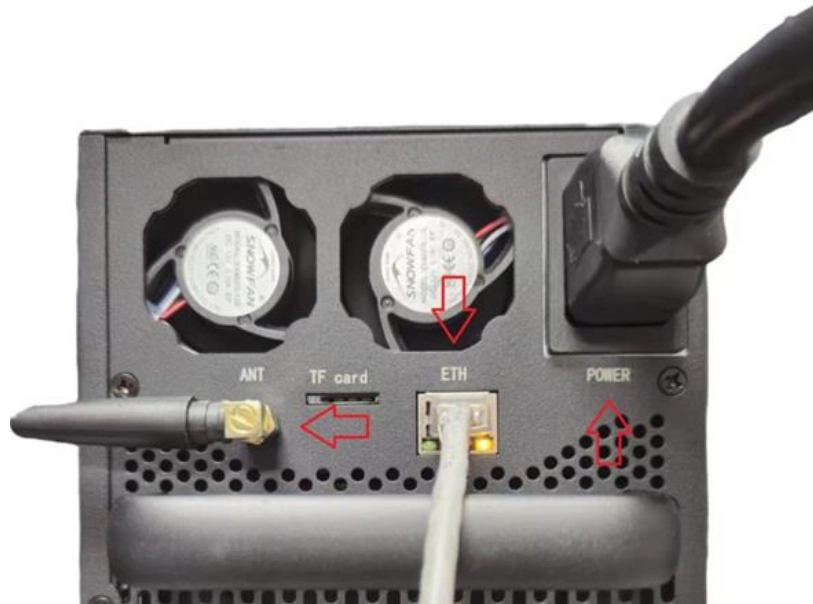

Option 1: Ethernet Connection (Recommended)
- Prepare and power on the device:
Connect an Ethernet cable to the network port on the device and to your router.
Connect the power cable to the device's power connector.
Plug the other end into a 220–240V outlet.
Press the power button — the green indicator will light up as the device boots.

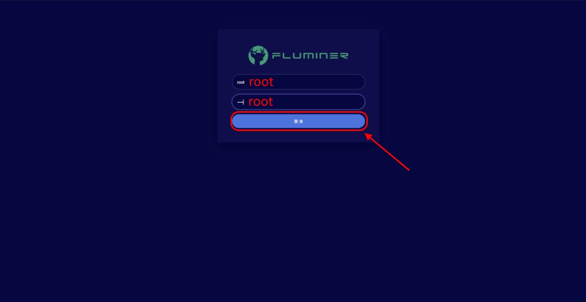

- Access the web interface:
Open a browser on a computer or phone connected to the same network.
Enter the IP address in the address bar:
http://[IP_ADDRESS]Log in with the default credentials: username
root, passwordroot.
On first login, you will be prompted to change the password — create a new strong password.

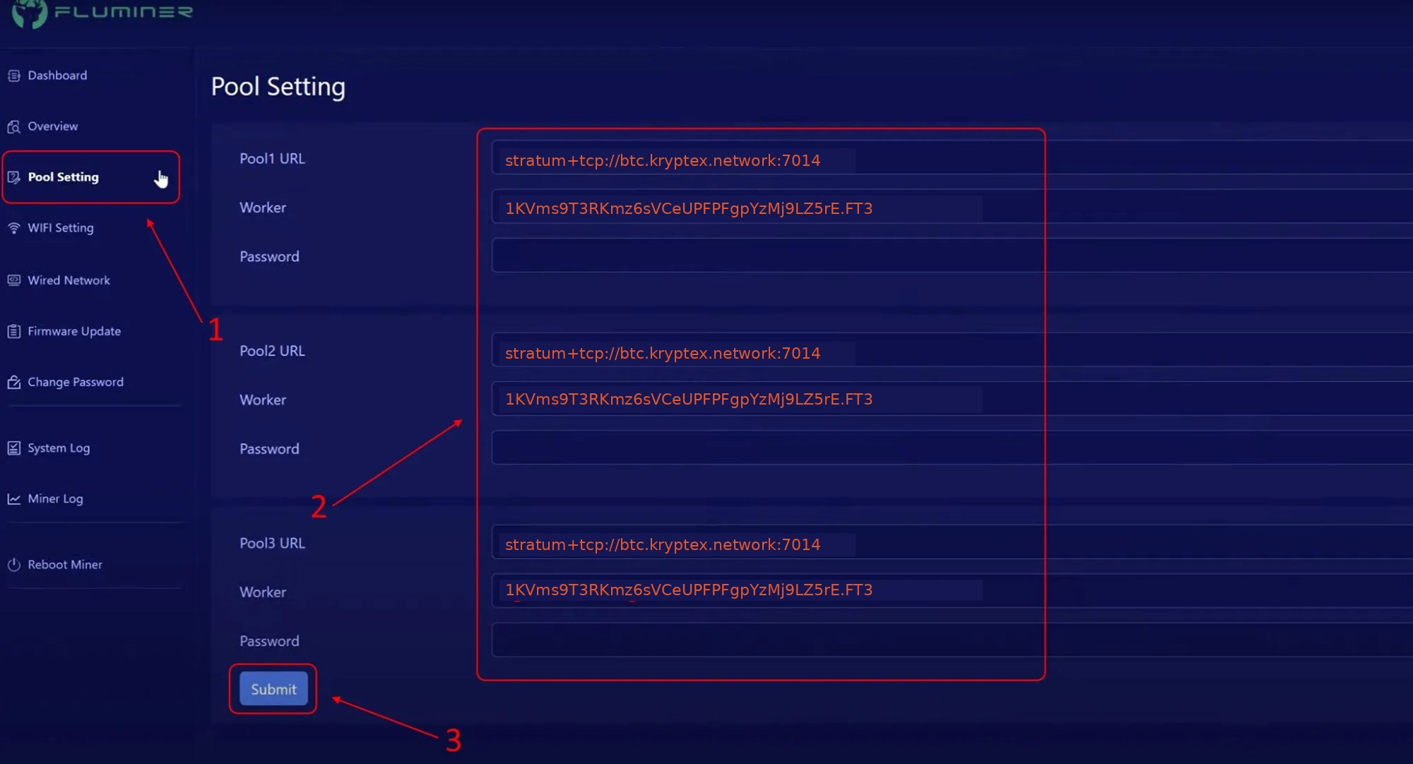

Pool Configuration
Configure pool settings:
In the left sidebar, click "Pool Setting".
Coin Pool Address Worker — Wallet Address and Worker Password BTC+FB stratum+tcp://btc.kryptex.network:7014orstratum+tcp://btc-eu.kryptex.network:7014BTC_WALLET_ADDRESS.WORKER_NAMExor leave blankFB stratum+tcp://fb.kryptex.network:7013orstratum+tcp://fb-eu.kryptex.network:7013FB_WALLET_ADDRESS.WORKER_NAMExor leave blankXEC stratum+tcp://xec.kryptex.network:7036orstratum+tcp://xec-eu.kryptex.network:7036XEC_WALLET_ADDRESS.WORKER_NAMExor leave blankDGB stratum+tcp://dgb.kryptex.network:7037orstratum+tcp://dgb-eu.kryptex.network:7037DGB_WALLET_ADDRESS.WORKER_NAMExor leave blankBCH stratum+tcp://bch.kryptex.network:7015orstratum+tcp://bch-eu.kryptex.network:7015BCH_WALLET_ADDRESS.WORKER_NAMExor leave blankQUAI stratum+tcp://quai-sha256.kryptex.network:7044orstratum+tcp://quai-sha256-eu.kryptex.network:7044QUAI_WALLET_ADDRESS.WORKER_NAMExor leave blankWorker — Specify wallet and worker name in the format:
1KVms9T3RKmz6sVCeUPFPFgpYzMj9LZ5rE.FT3where:1KVms9T3RKmz6sVCeUPFPFgpYzMj9LZ5rEis your wallet address;FT3is the name of your ASIC, written in Latin characters or numbers.
⚠️ Each coin uses its own wallet format: BTC —
1...,3...orbc1...; XEC —ecash:...; DGB —D...; BCH —bitcoincash:.... To get the correct address, go to the relevant coin page on pool.kryptex.com.
Make sure to fill all 3 pool configuration rows with settings of the same pool! Click "Submit" to save settings. The ASIC will reboot automatically.

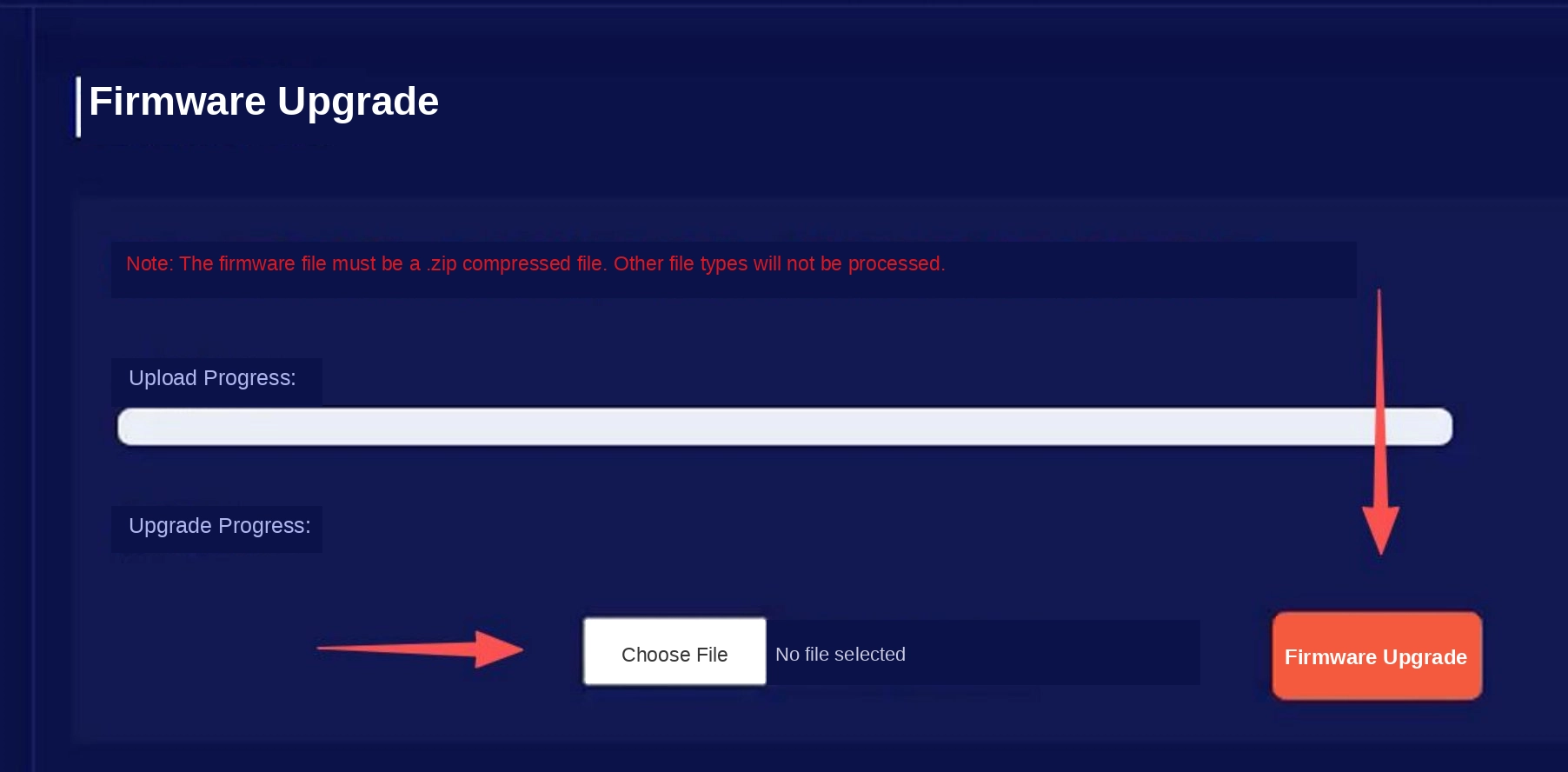

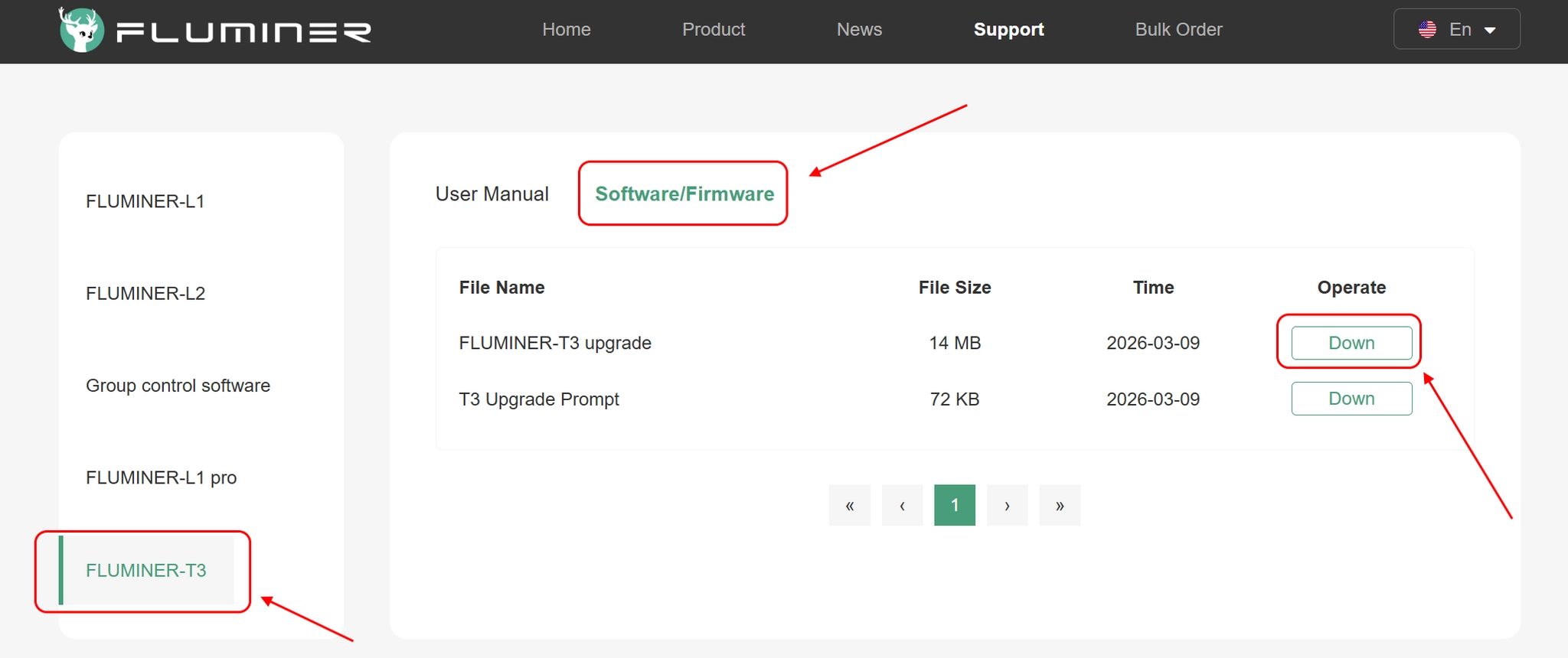

Fluminer T3 Firmware
Fluminer regularly releases firmware updates that improve device performance, stability, and security.
Download the latest firmware and update instructions from the official manufacturer website: fluminer.com
Firmware updates are performed through the device's web interface under "System" → "Firmware Upgrade".
