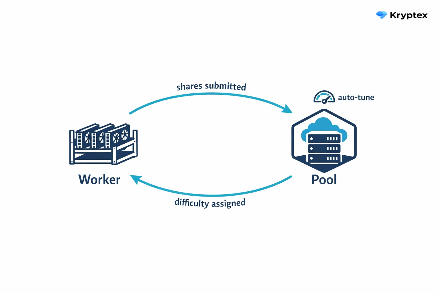

Vardiff loop: the worker submits shares, the pool auto-tunes the difficulty
How vardiff works
Vardiff (variable difficulty) lets the pool set the share difficulty for each worker automatically. It watches how fast your shares come in and tunes the difficulty so a worker submits roughly one share every 60 seconds.

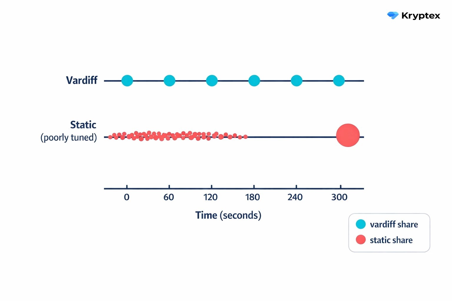

✅ Why vardiff is the better default
Vardiff keeps a steady share rhythm; static difficulty bunches and gaps
The pool sees your worker's actual speed, not a number from a spec sheet. That makes it better at picking the right difficulty than any manual calculation — real performance always drifts, and vardiff accounts for that on its own.
Set the difficulty by hand only when you have a specific reason — measurements, a stratum proxy, or debugging. In every other case, vardiff does a better job.

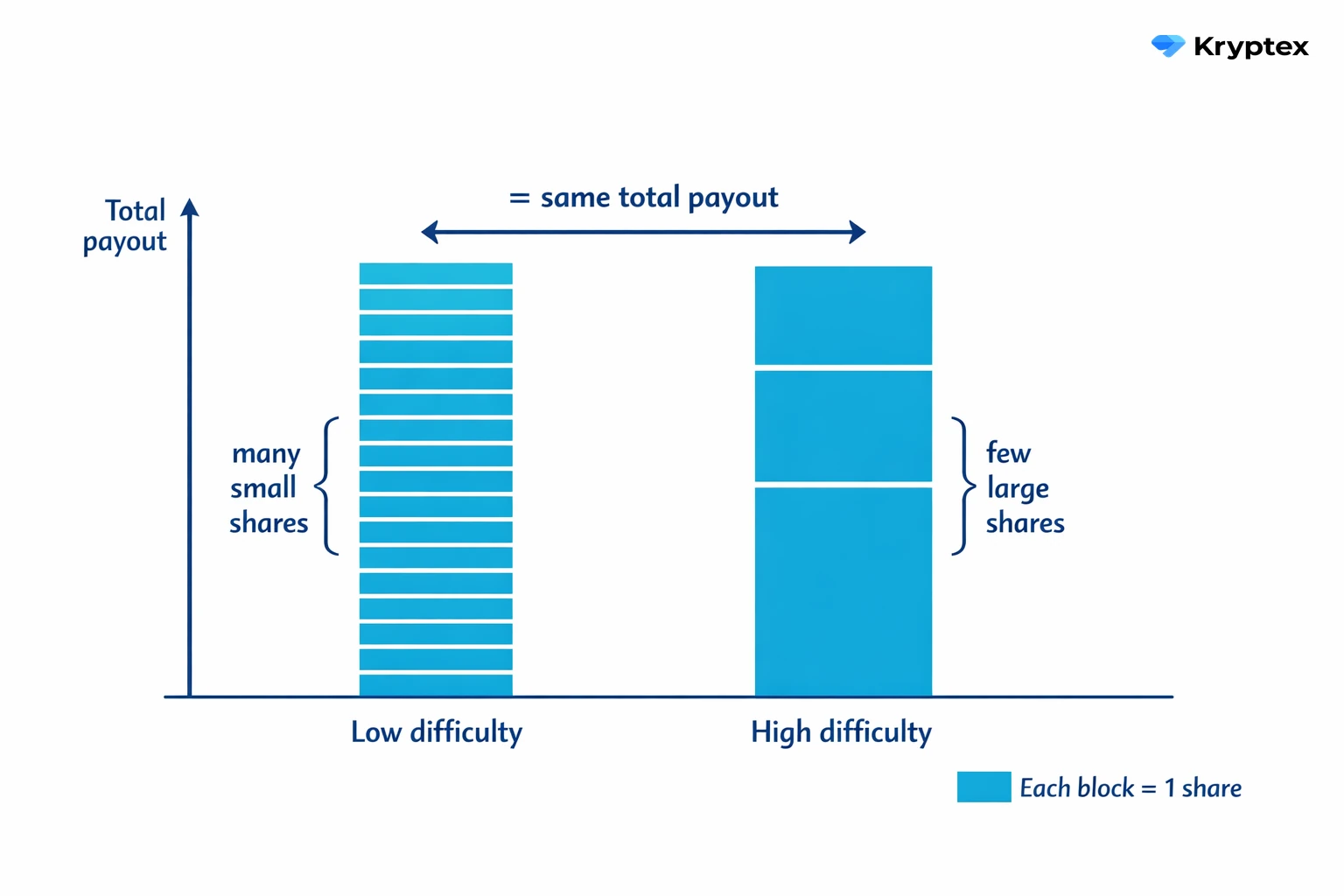

❌ Share difficulty doesn't affect your earnings
A common misconception: "If I raise the difficulty, I'll earn more." That's not how it works.
Same total payout at any share difficulty
  • PPS and PPLNS weigh every share by its difficulty — a big share is worth more, a small one less. So your hashrate × time stays the same at any difficulty. With fewer shares, each is worth more; with more shares, each is worth less. The total payout is identical.
  • In solo mining, share difficulty doesn't matter at all. Your chance of finding a block depends on your hashrate vs the network difficulty. How the pool tracks your shares has nothing to do with it.
  • Luck — meaning payout variance on PPLNS — depends on round length and pool behavior, not share difficulty.
Share difficulty only changes how finely the pool tracks your work and how much network traffic it generates. It doesn't change what you earn.
