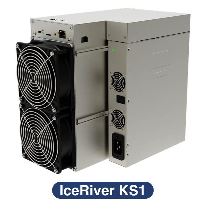

IceRiver KS1 Firmware Update with Overclocking
You have two firmware options to choose from:
  • 1250 Ghs
    SHA256: 7138381F8337FA9D3CAE88D3B8B9481319894804A146E4EE08C014E551B8EE24
  • 1400 Ghs
    SHA256: 32B50C99349CA2D39AB42B1DEC80824E386BA299A1819DD2667196E836746AE6
There are occasions where, even after upgrading your ASIC to 1400 Ghs, it might not be able to mine at that hashrate. In such situations, opt for a file with a lower hashrate. The hashrate your ASIC can handle is contingent on luck and the "silicon lottery" — essentially, the quality of the chips in your ASIC.
  1. Download the updated file 40KS1update.bgz.
    • SHA256: 32B50C99349CA2D39AB42B1DEC80824E386BA299A1819DD2667196E836746AE6
  2. Navigate to ASIC’s webgui “Firmware Upgrade” page.
  3. Click “Select File”, select the downloaded 40KS1update.bgz file on your PC, and click the “Update” button.
  4. Wait for the pop-up window to show success and then reboot your ASIC.
  5. Wait for the ASIC to reboot (do not power off during the reboot process). The whole process may take up to 2-5 minutes.
  6. Done! Your ASIC overclocked!
Everything failed!
If something doesn’t go according to plan, or at some stage the ASIC freezes, stops responding, or doesn’t work, you can try resetting it to factory settings. Resetting will also remove overclocking.
  1. On the side panel, where there are two lights (green and red) press and hold Button for 20 seconds until the red status light starts blinking. Waiting until the red status light stops blinking and wait for the machine to reboot (do not power off the machine during the reboot process).
