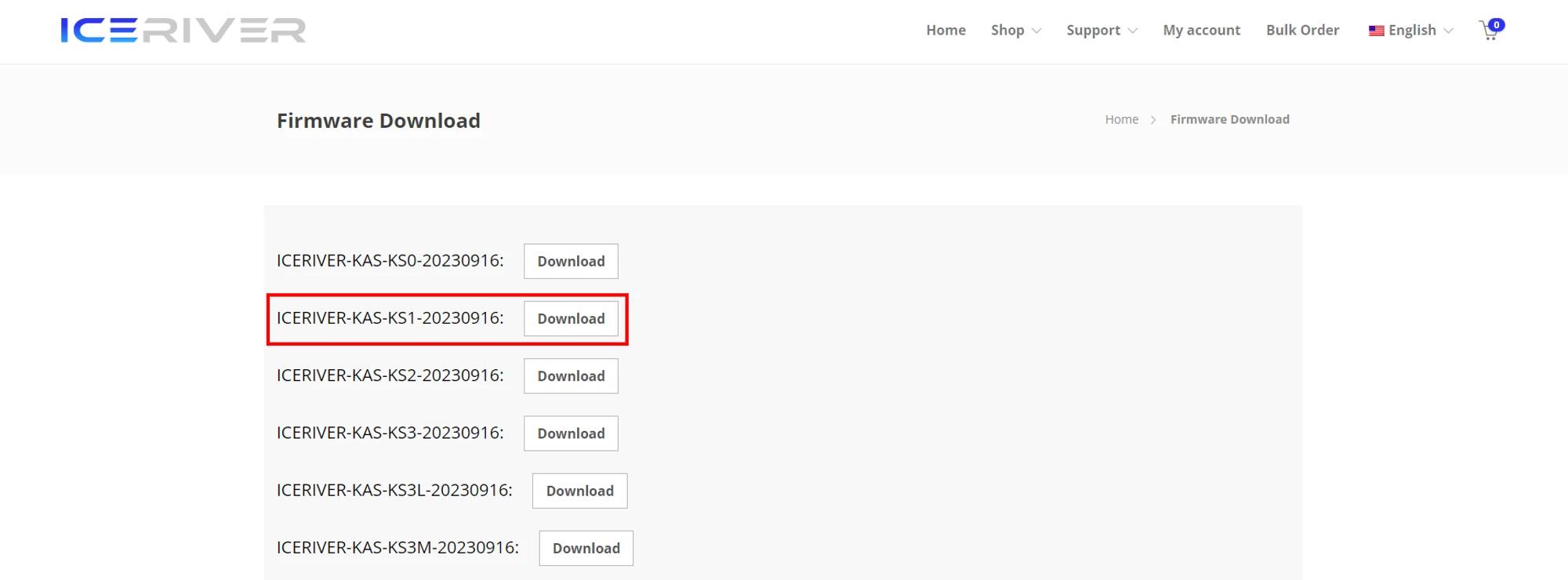

Refer to the manufacturer's instructions and update your ASIC firmware to the latest version available on the official website: https://www.iceriver.io/firmware-download/
After the update, confirm that the ASIC is functioning correctly.

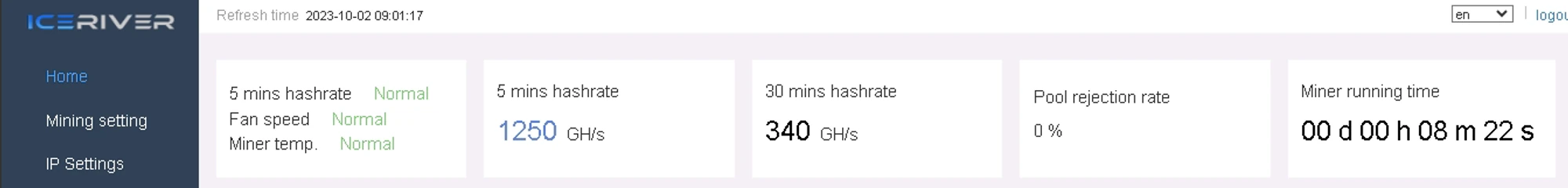

- 1250 Ghs
SHA256:7138381F8337FA9D3CAE88D3B8B9481319894804A146E4EE08C014E551B8EE24 - 1400 Ghs
SHA256:32B50C99349CA2D39AB42B1DEC80824E386BA299A1819DD2667196E836746AE6
There are occasions where, even after upgrading your ASIC to 1400 Ghs, it might not be able to mine at that hashrate. In such situations, opt for a file with a lower hashrate. The hashrate your ASIC can handle is contingent on luck and the "silicon lottery" — essentially, the quality of the chips in your ASIC.

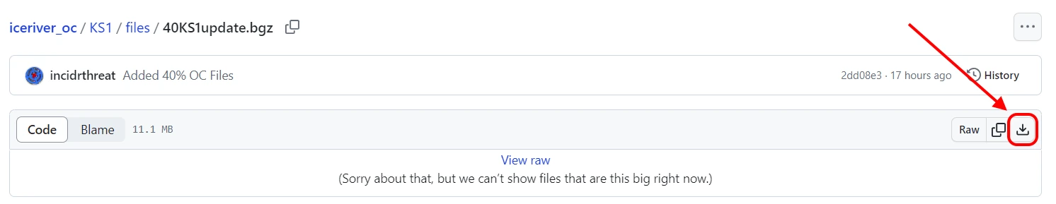

Download the updated file 40KS1update.bgz.
SHA256:

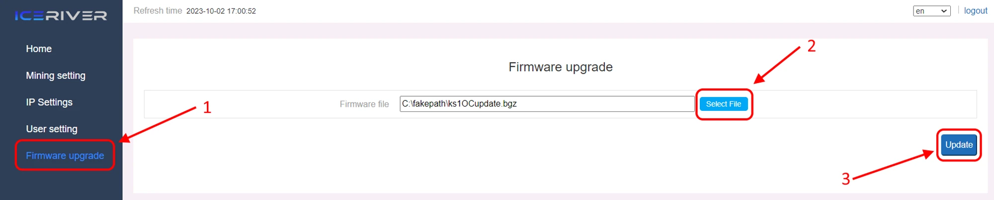

Navigate to ASIC’s webgui “
Firmware Upgrade” page.Click “
Select File”, select the downloaded40KS1update.bgzfile on your PC, and click the “Update” button.
Wait for the pop-up window to show success and then reboot your ASIC.
Wait for the ASIC to reboot (do not power off during the reboot process). The whole process may take up to 2-5 minutes.
Done! Your ASIC overclocked!
