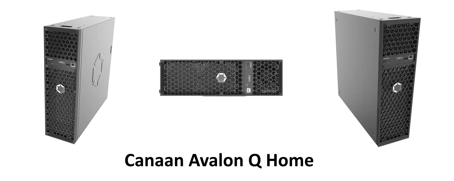

With growing interest in home Bitcoin mining, Canaan has introduced a groundbreaking device: the Avalon Q Home. It’s the first ASIC miner to combine high performance, low noise, and intuitive setup via a mobile app. We’ve tested the new release and are sharing our first impressions.

Canaan Avalon Q Home — Specifications and Size
Model Algorith Coin Hashrate Consumption Dimensions (cm) Weight
Q Home SHA256 BTC, FB, XEC, DGB, BCH 90 Th/s (±10%) 1674 Watt (±10%) 45 x 13 x 44 10.5 kg

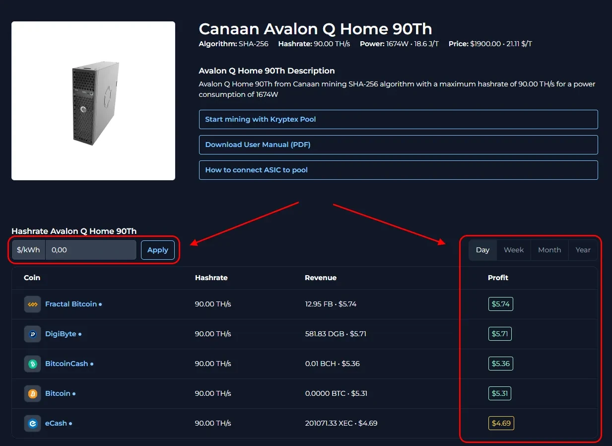

Canaan Avalon Q Home Profitability
Currently, the profitability of the Canaan Avalon Q Home is about $5.7 a day to $48.9/day, depending on its working mode, and excluding electricity costs.
We recommend to check the actual profitability in our mining calculator, where you can also calculate the profitability including your electricity costs.
Mode Hashrate Consumption Profit w/o El. Price
Eco 55 Th/s (±10%) 875 Watt (±10%) ~$3.5 / day
Standart 80 Th/s (±10%) 1450 Watt (±10%) ~$5.1 / day
Super 95 Th/s (±10%) 1790 Watt (±10%) ~$6 / day
Check the profitability of Canaan Avalon Q Home ASIC on the mining calculator.

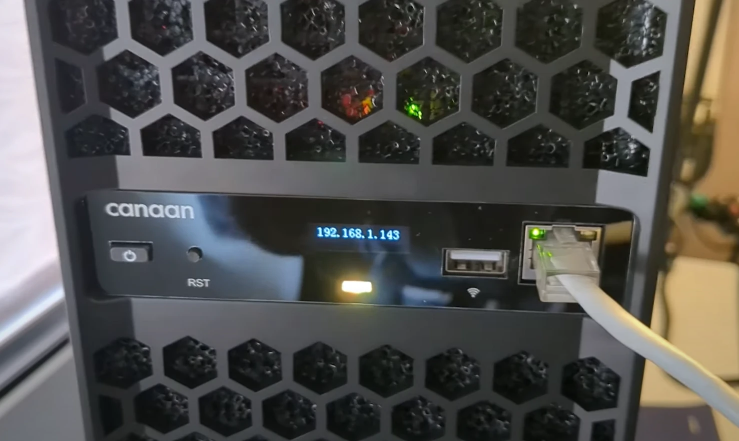

  1. Prepare and power on the device:
    • Insert the Wi-Fi adapter into the USB port on the front panel of the Avalon Q Home if you plan to connect via Wi-Fi.
      • If using a wired connection, plug the LAN cable into the front panel.
    • Connect the power cable to the rear panel of the device.
    • Plug the other end into a wall outlet.
    • Wait for the LED indicators to start flashing — this means the miner is booting up.

      • If using a wired connection, tap “Manually add running device” and enter the IP address shown on the front panel display.

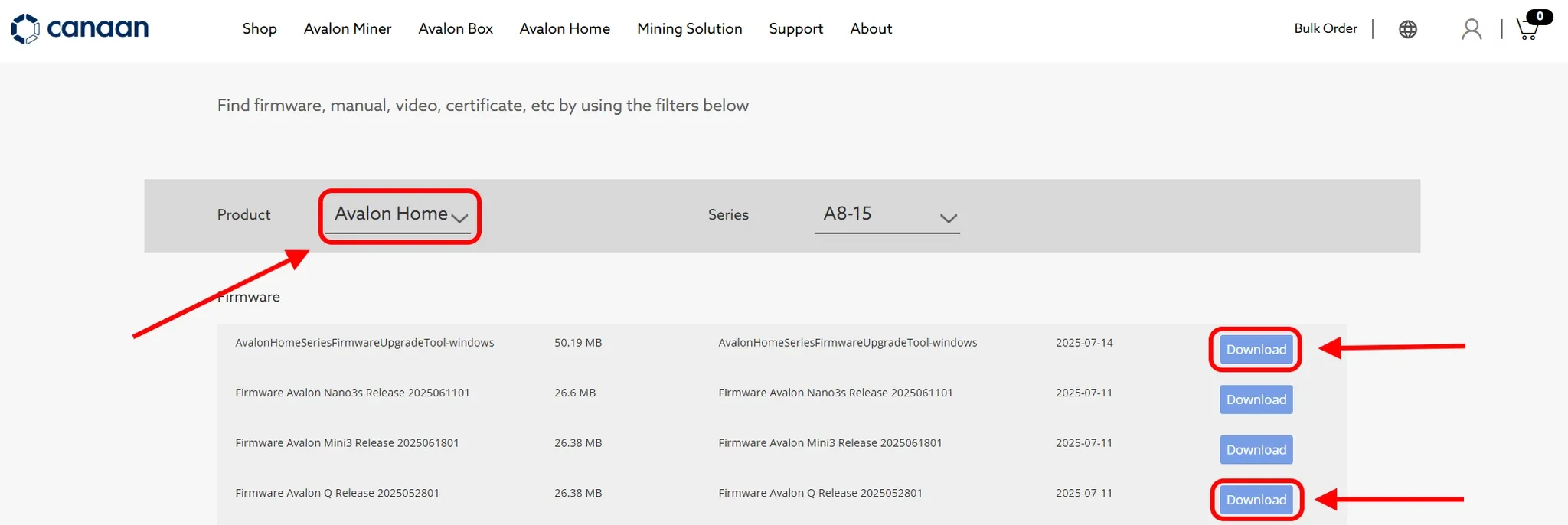

Canaan Avalon Q Home Firmware Update
If needed, you can update or change the firmware by following these steps:
  1. Go to the developer’s support page and open the firmware download section: https://www.canaan.io/support/file_download
  2. Select your ASIC model series — Avalon Home.
  3. Download the firmware utility and the firmware file by clicking “Download
  4. Extract both the utility archive and the firmware archive to a convenient location on your PC, such as the desktop
  5. Watch the video tutorial included in the utility archive for instructions on connecting the ASIC to your PC and updating the firmware

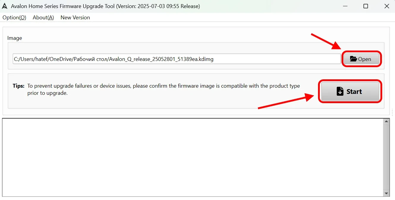

  6. Connect the ASIC to your PC, install the drivers included with the utility, launch the firmware utility, and click “Open” to select the firmware file from your PC
  7. Click “Start” and wait for the firmware update to complete. Do not disconnect the ASIC during the update process.
