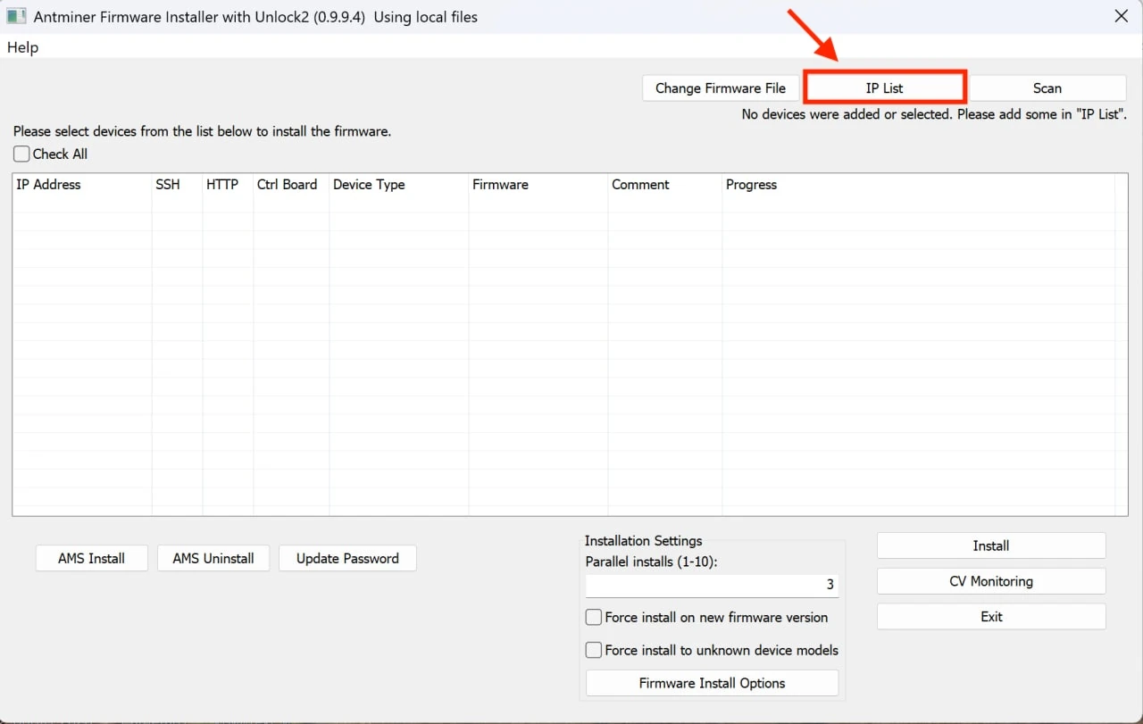

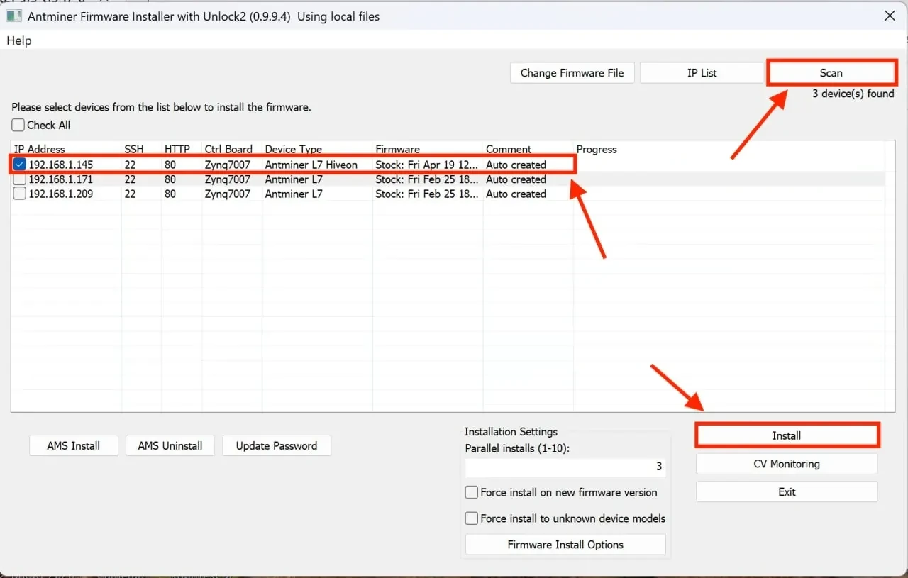

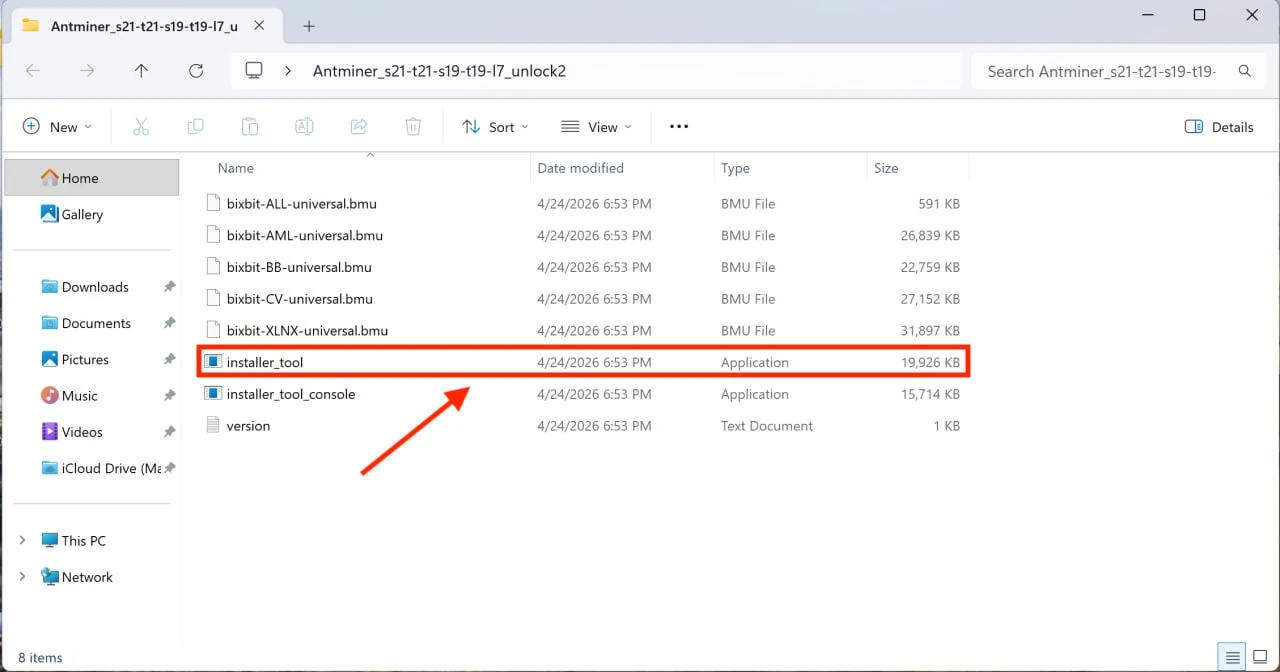

  1. Download the BiXBiT firmware, open the archive, and run “installer_tool”.

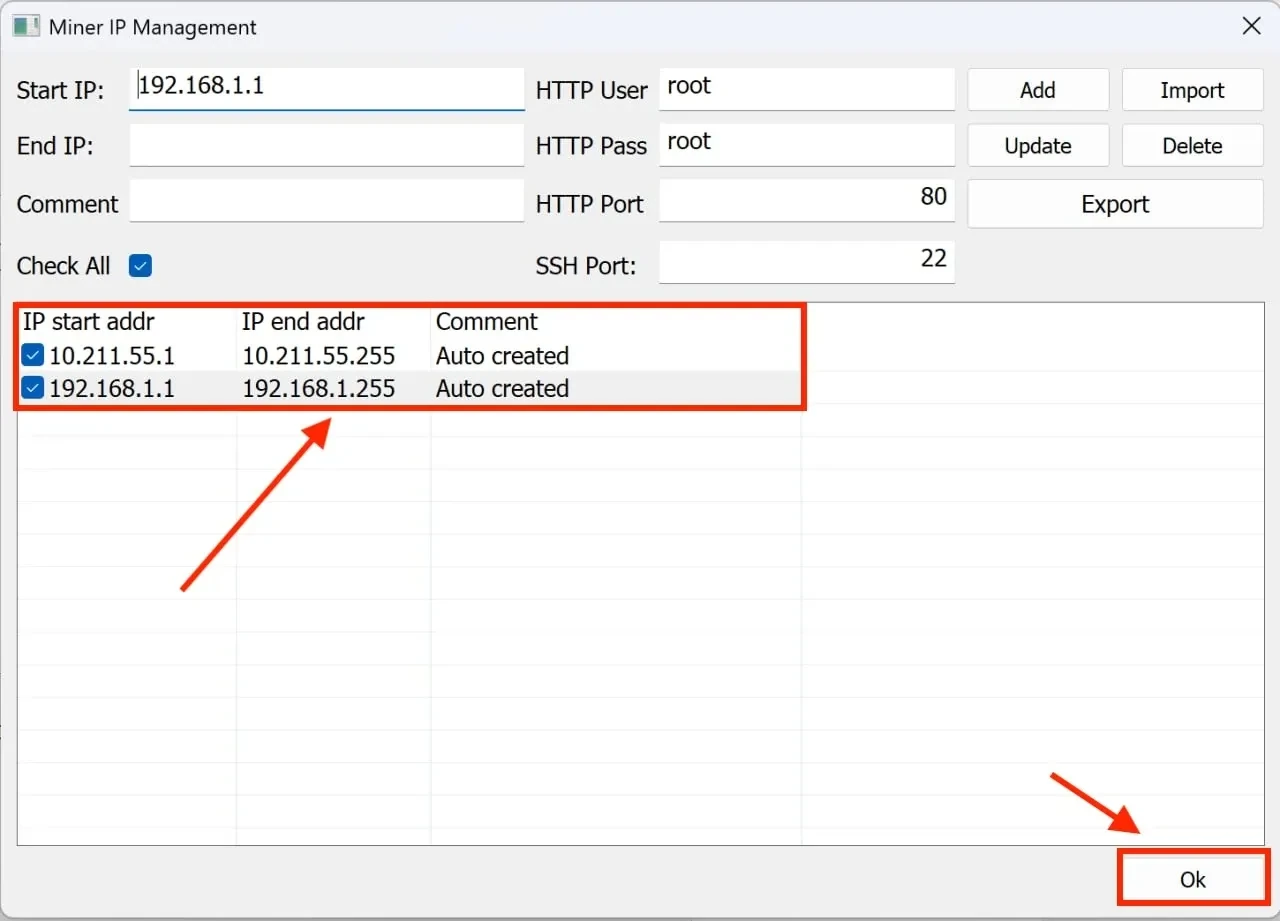

  2. Set the IP address range.
  3. Pick the standard ranges or set your own, then click “OK”.
  4. Scan the network, select your ASIC, and click “Install”.
  5. Done — the firmware is installed on your ASIC.

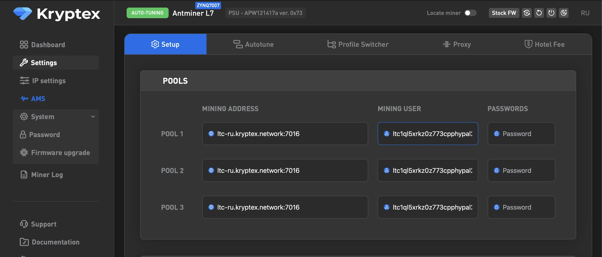

  1. In the firmware web interface, open the Settings section.
  2. In the URL field, enter your mining pool address, for example: stratum+tcp://btc.kryptex.network:7014.
  3. In the User field, enter the worker in the format wallet.workername — for example, wallet.asic001.
  4. Save the settings, and the miner will reconnect to the Kryptex Pool.

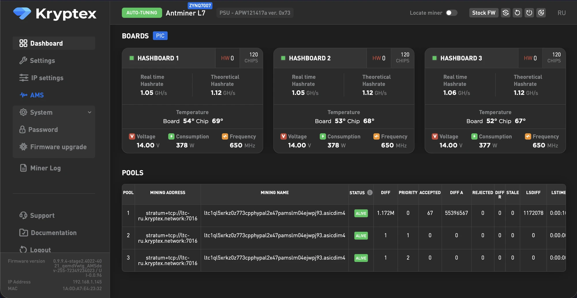

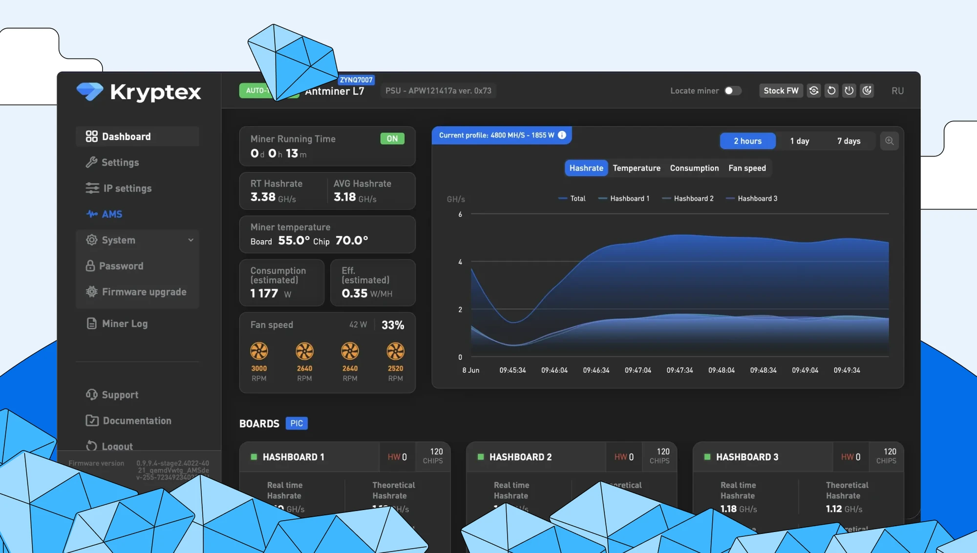

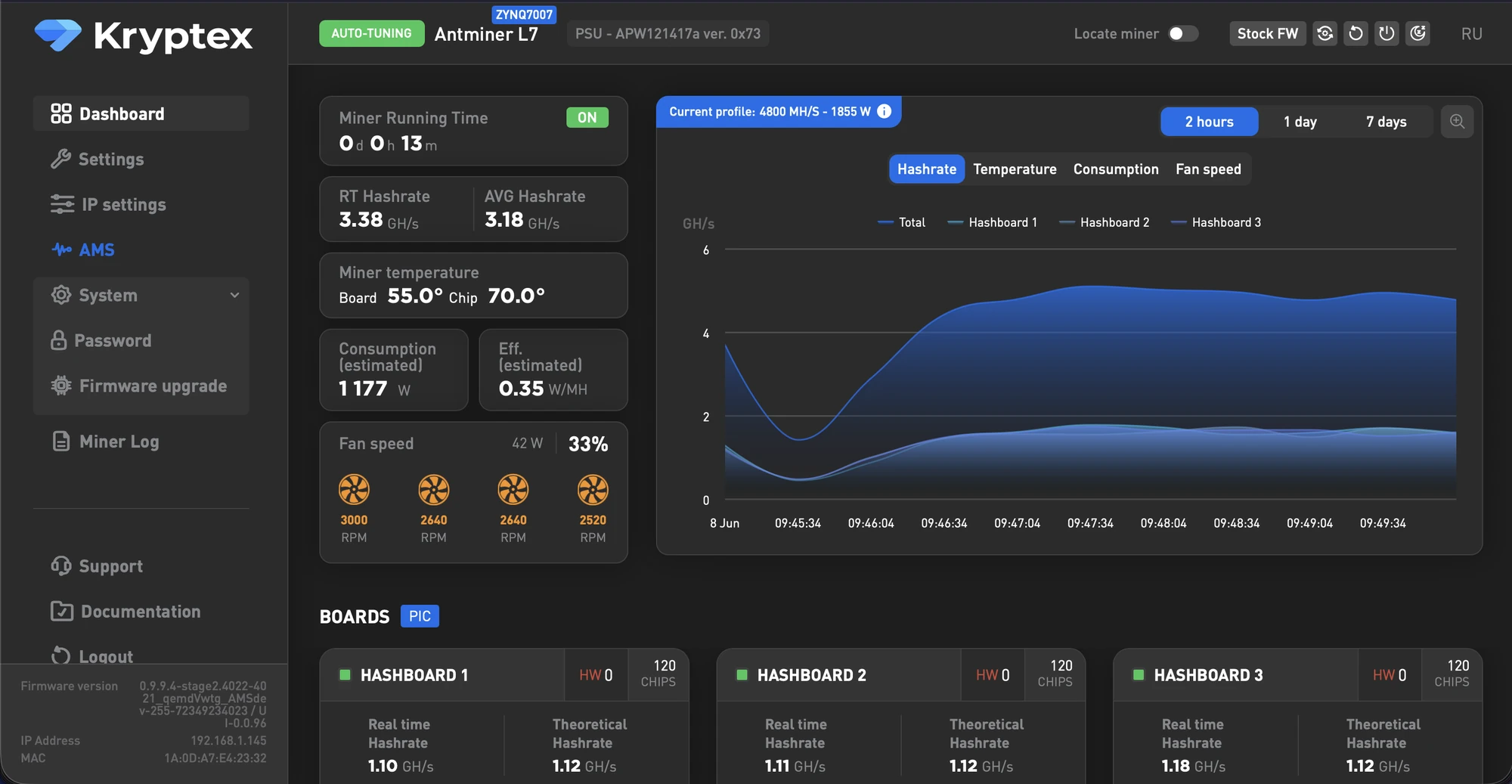

  1. Home — shows the ASIC's key metrics: hashrate, temperature, power consumption, and pool status.

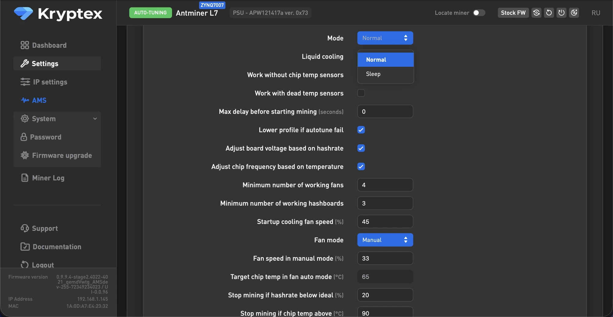

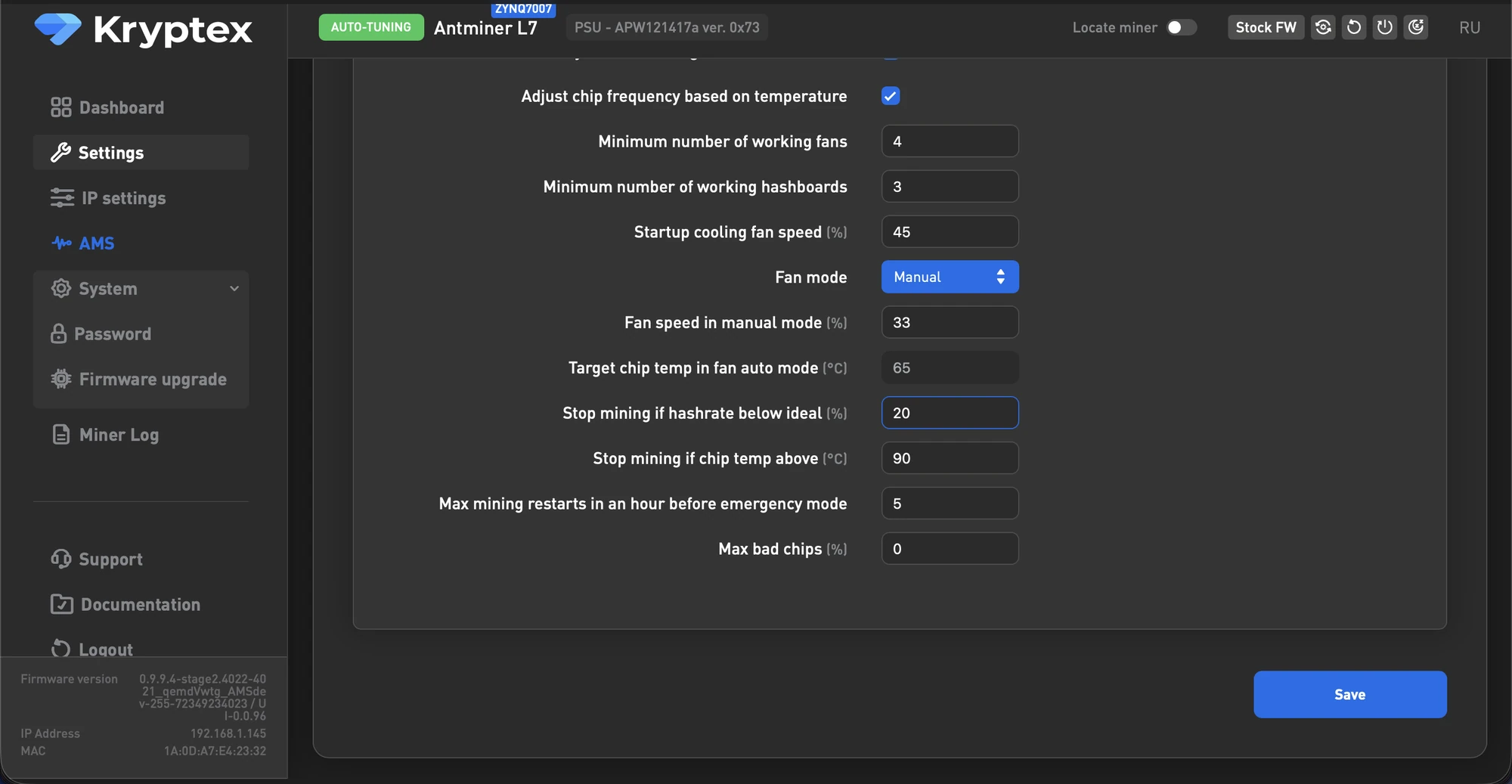

  2. Settings — the miner's core settings.

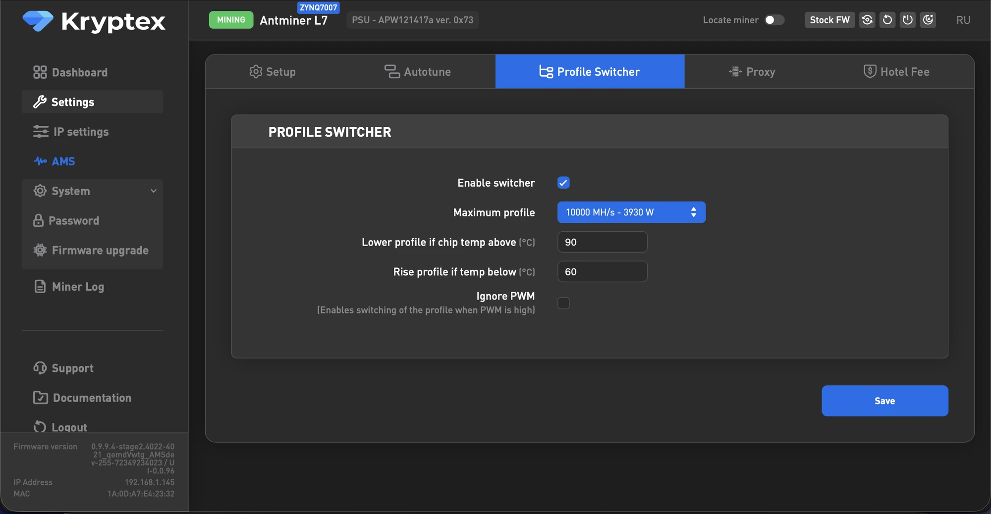

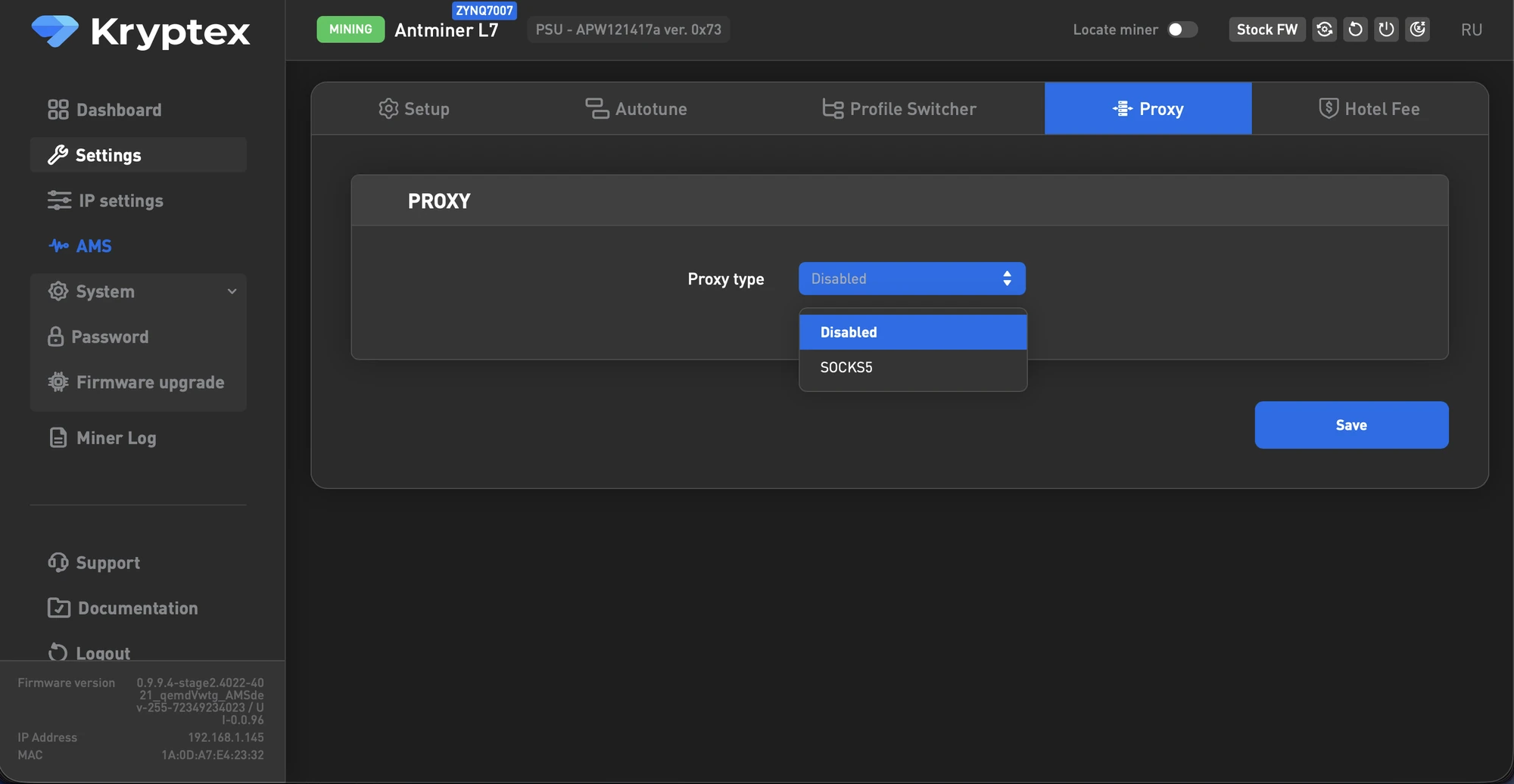

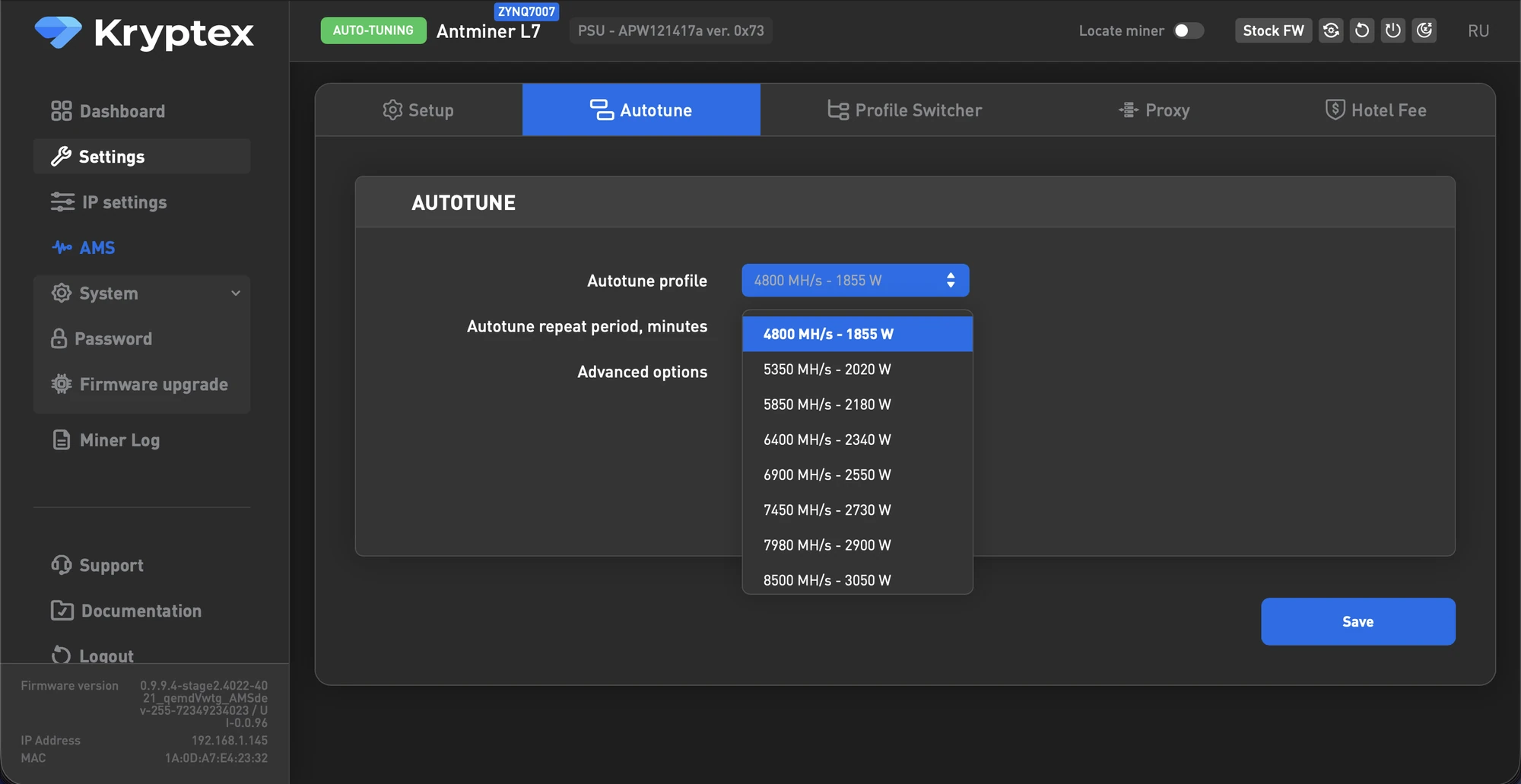

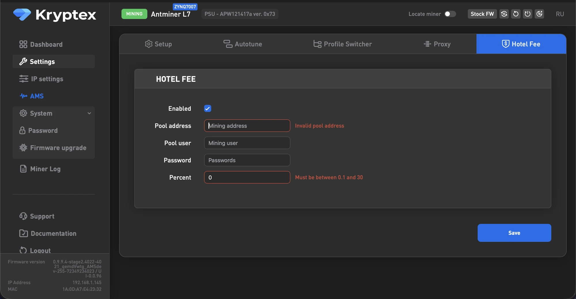

  3. Overclocking profiles, switcher, and proxy — choose a performance profile, enable automatic switching, and run through a proxy.

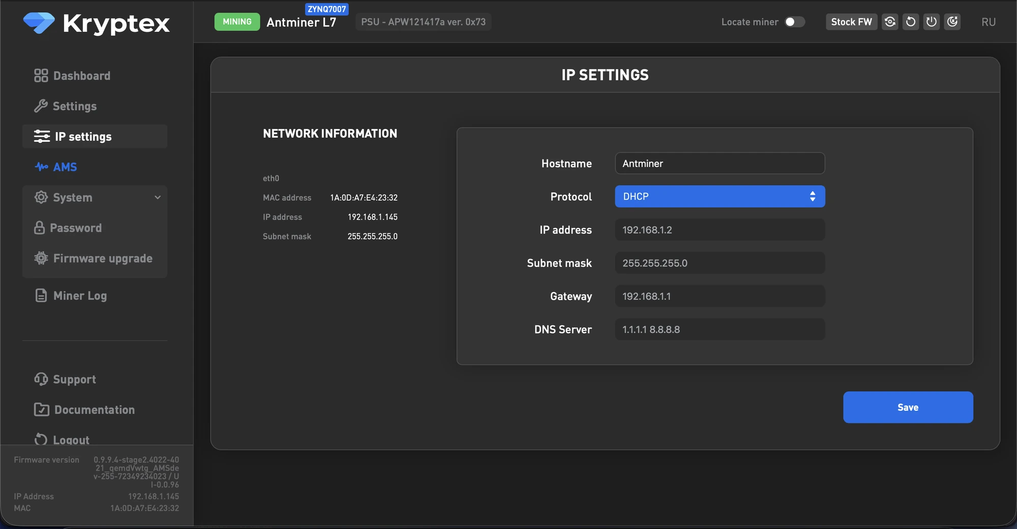

  4. Network settings — the ASIC's network connection parameters.

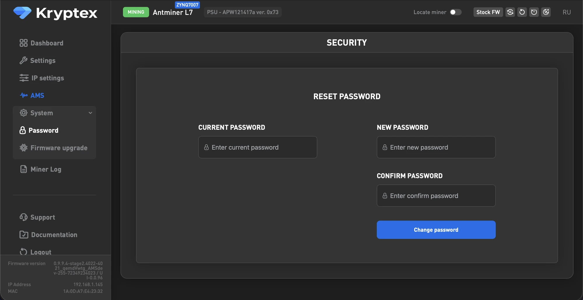

  5. Security — change the ASIC login password.

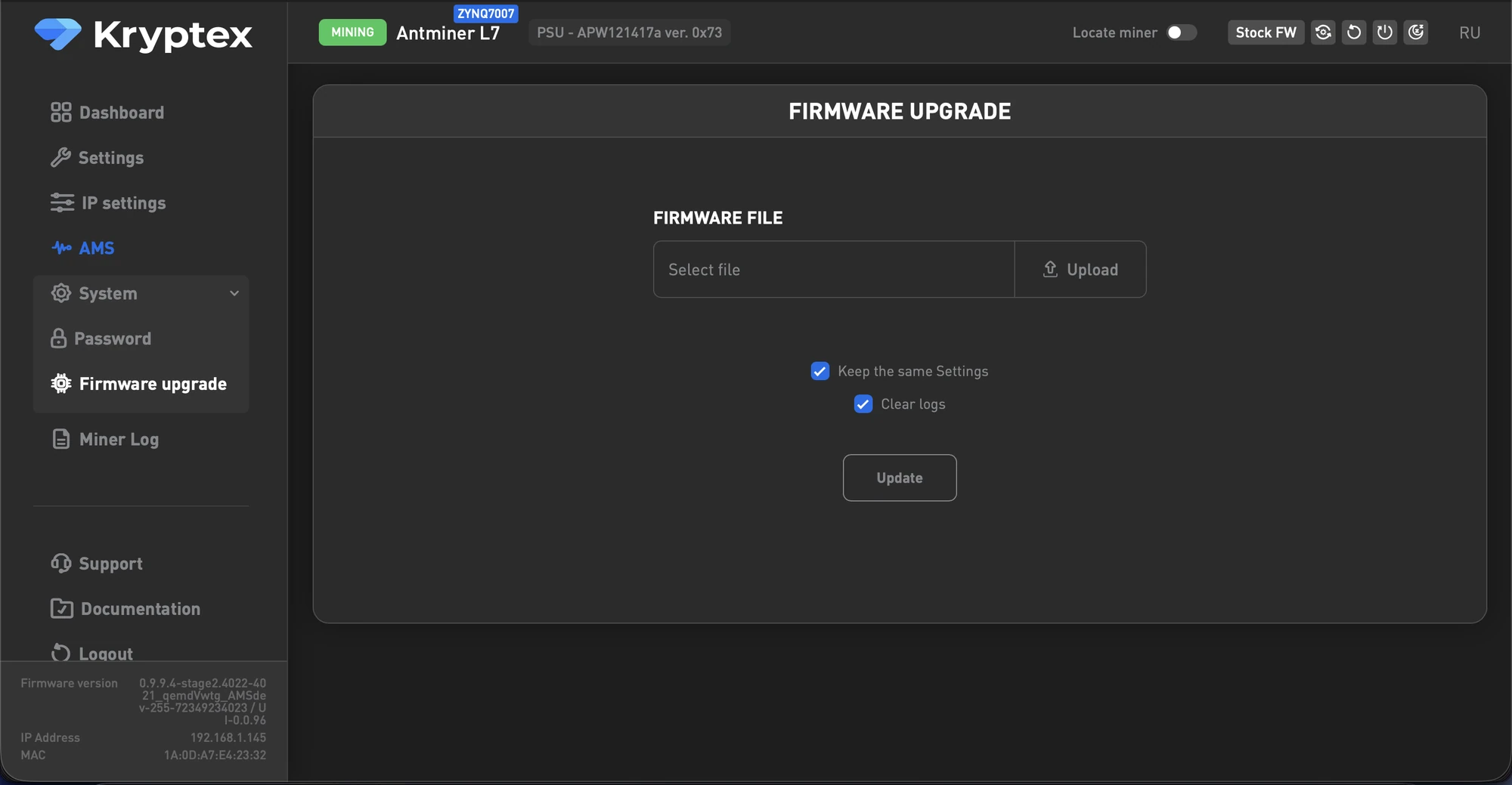

  6. Firmware update — install a different firmware from the web interface.

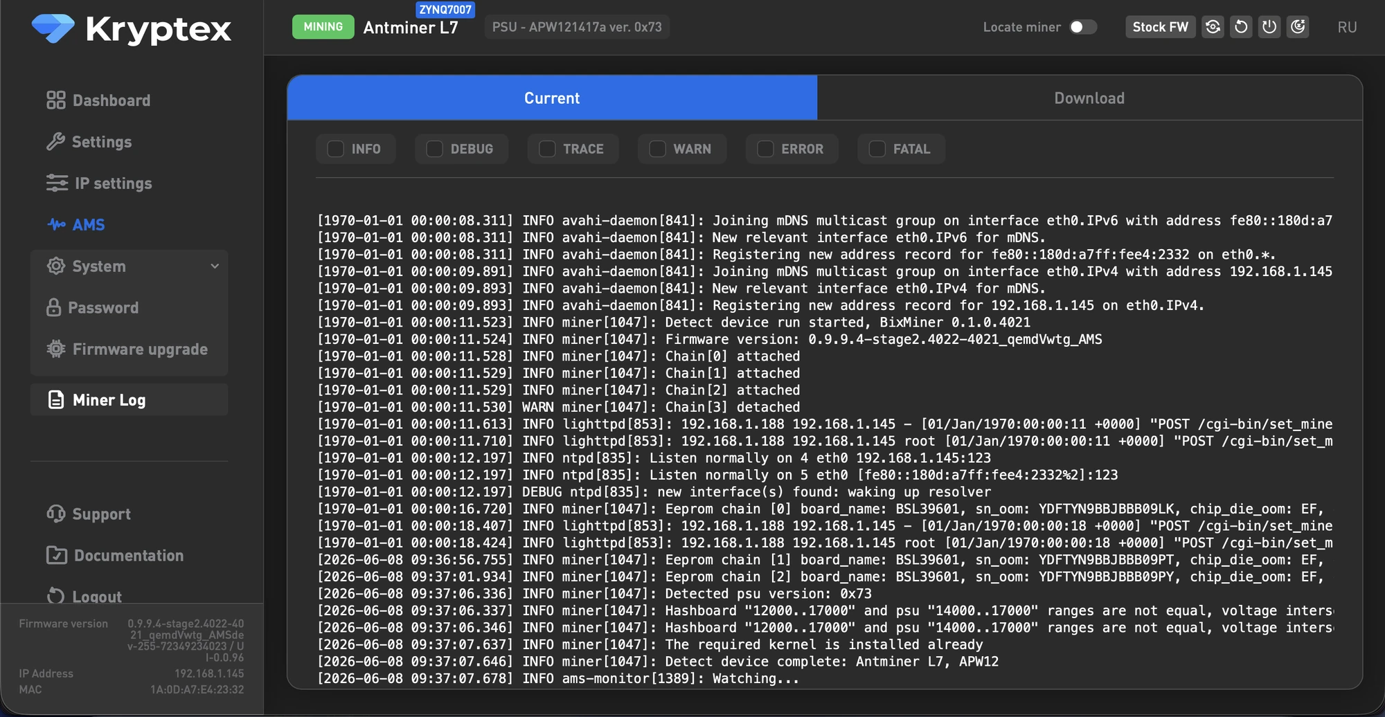

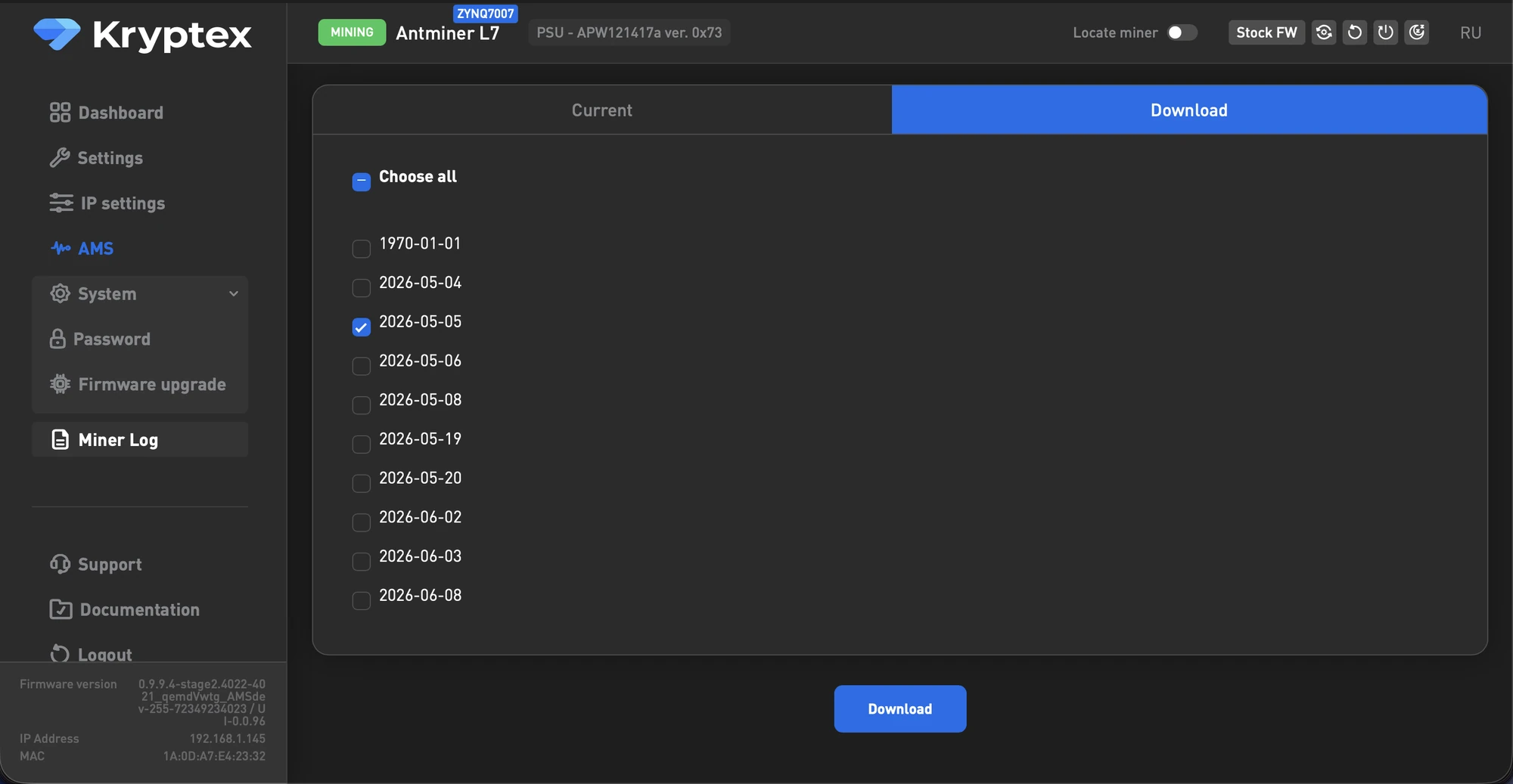

  7. Miner log — detailed device logs.

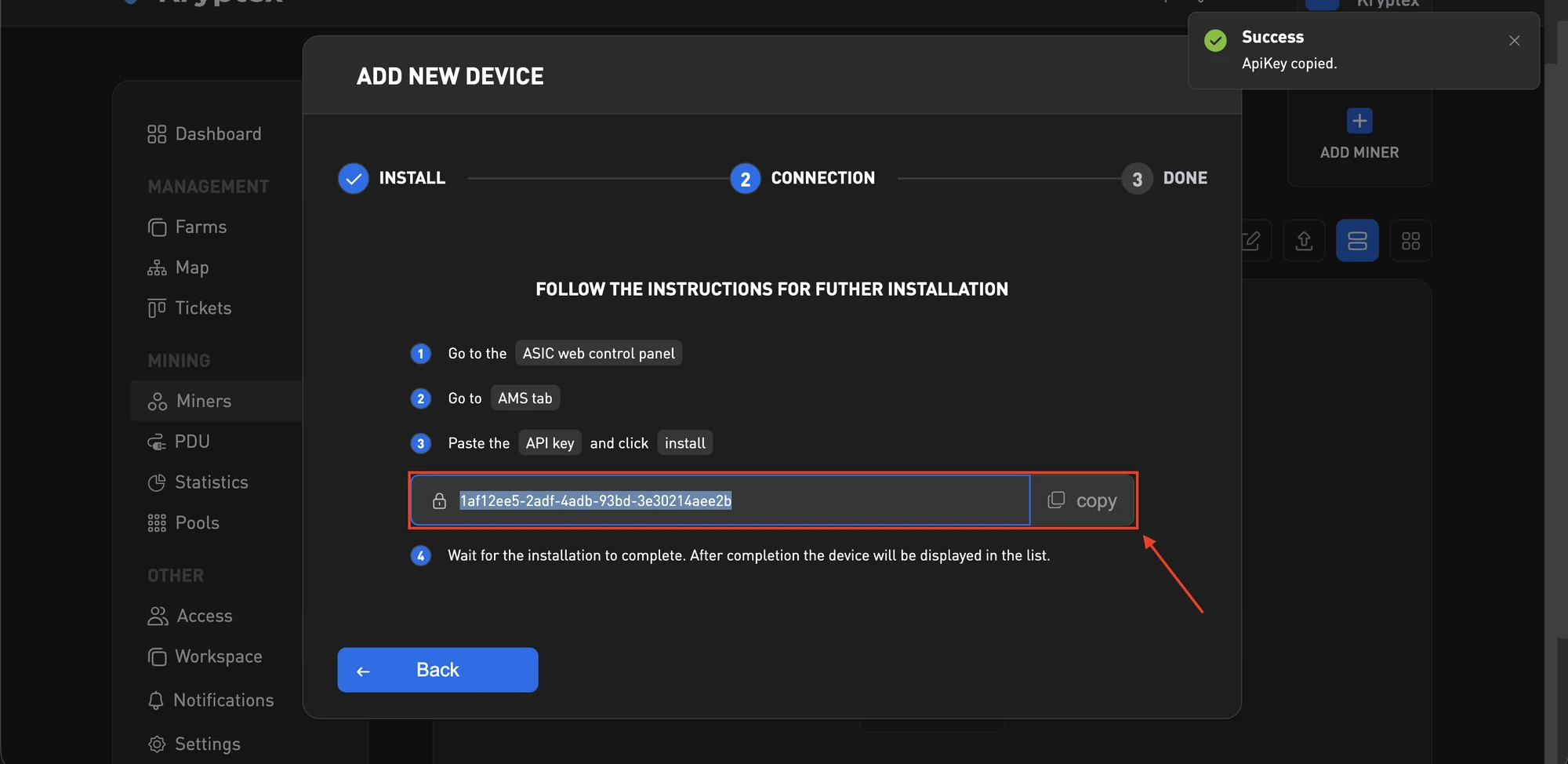

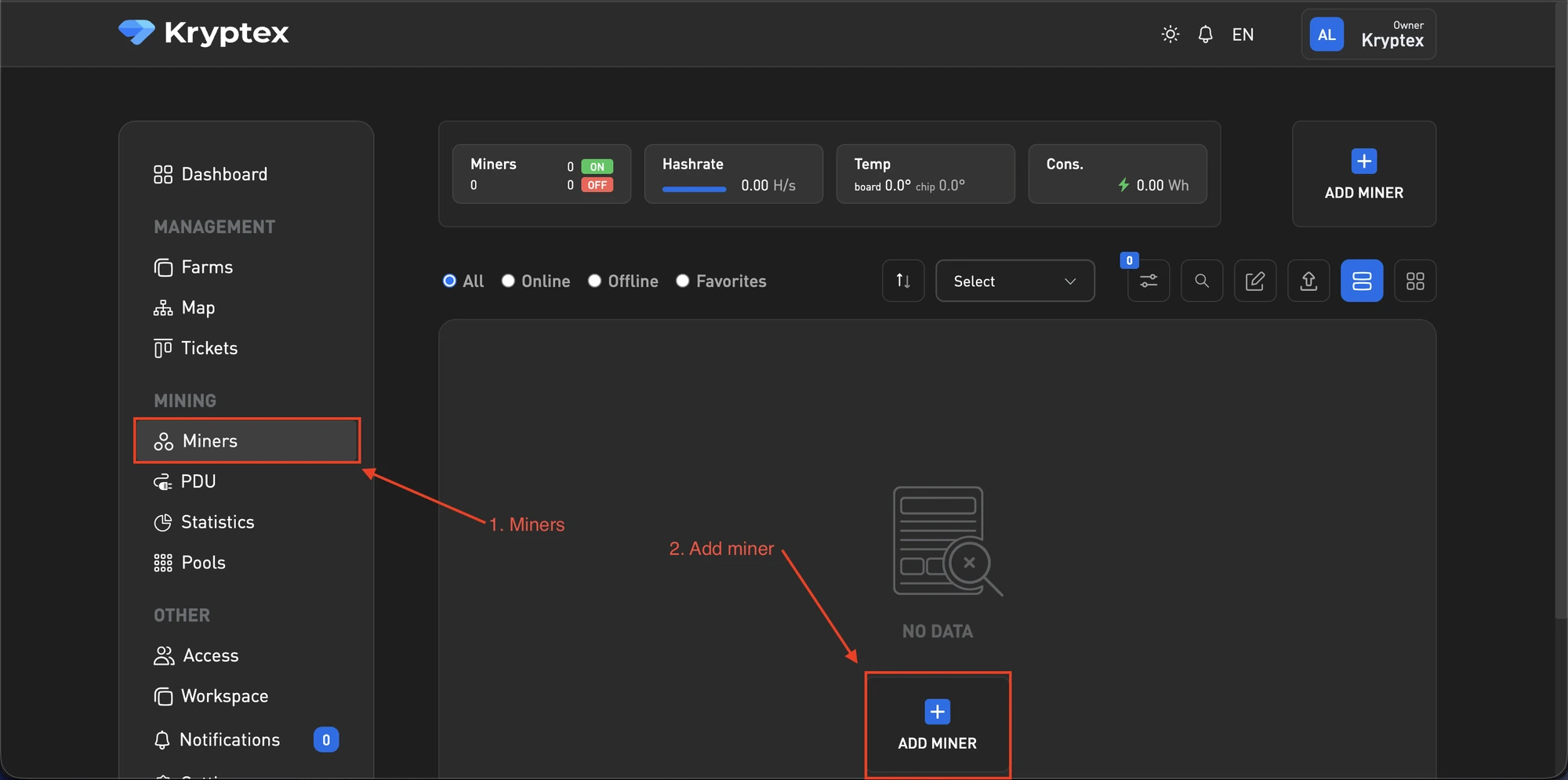

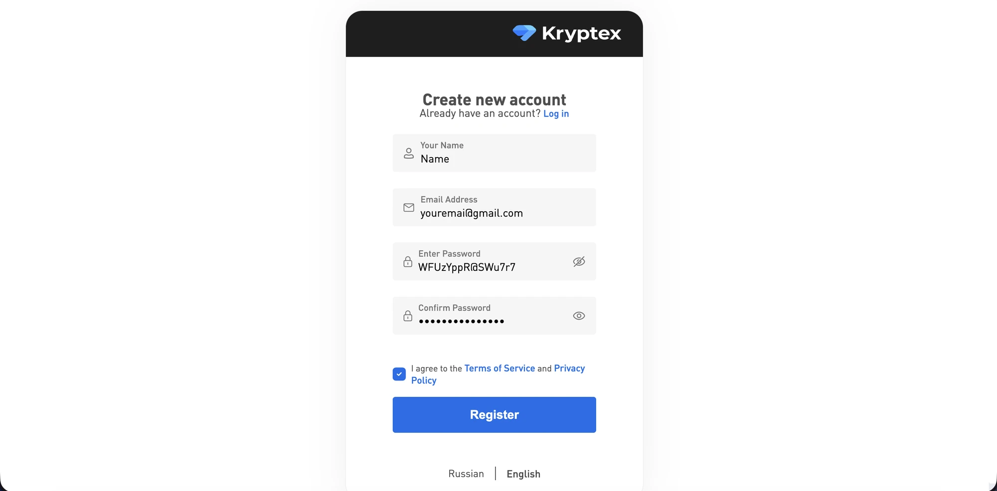

  1. Register an AMS account and confirm your email.

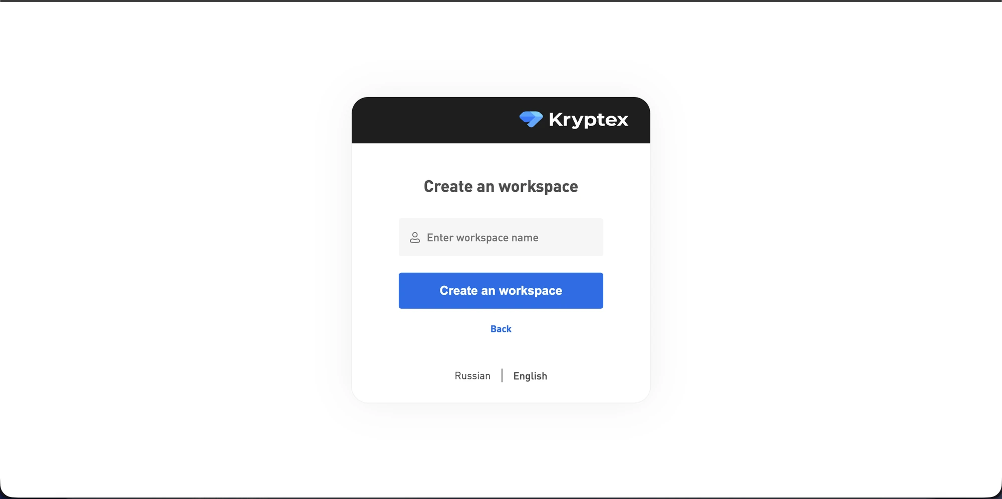

  2. Add a workspace — you can give it any name.

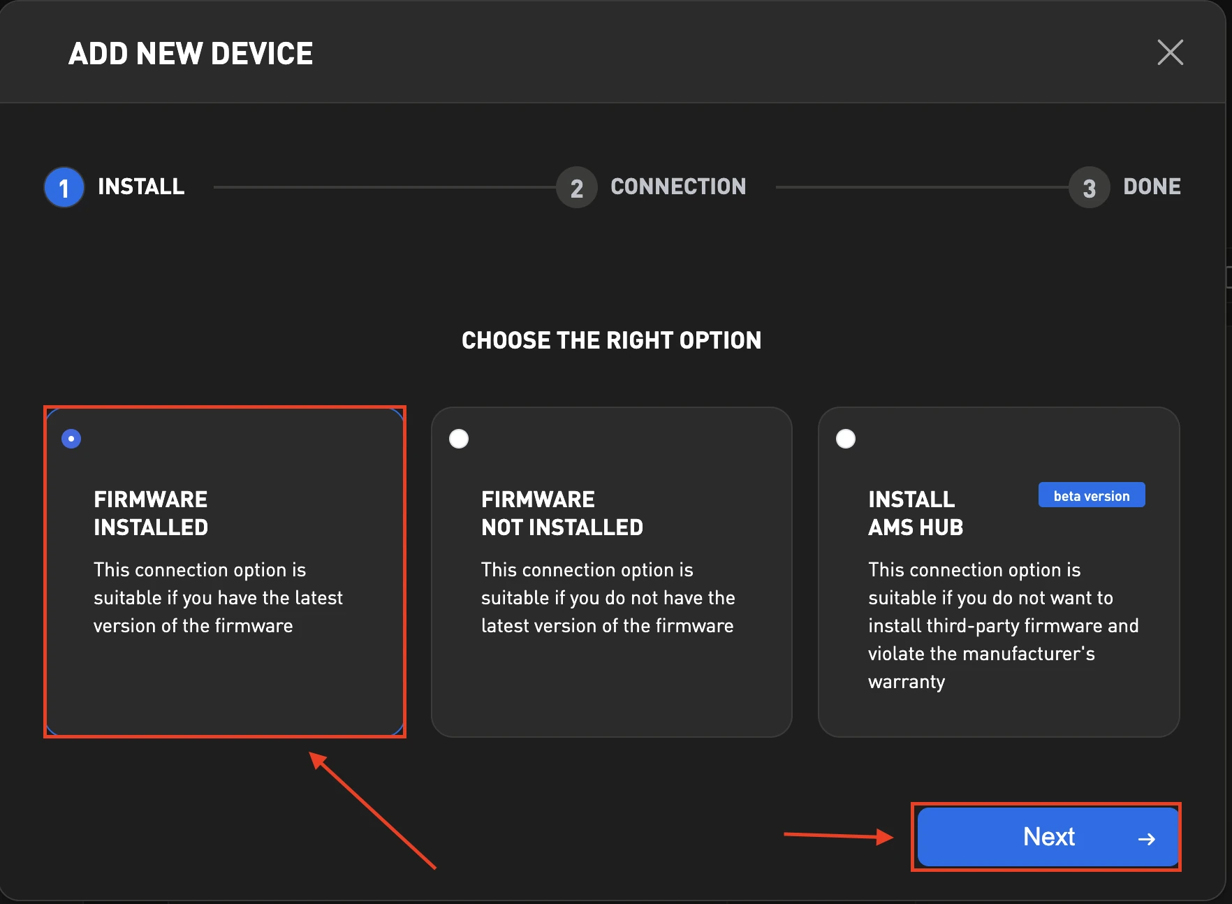

  3. Add an ASIC.
  4. Select “firmware installed” and click “next”.

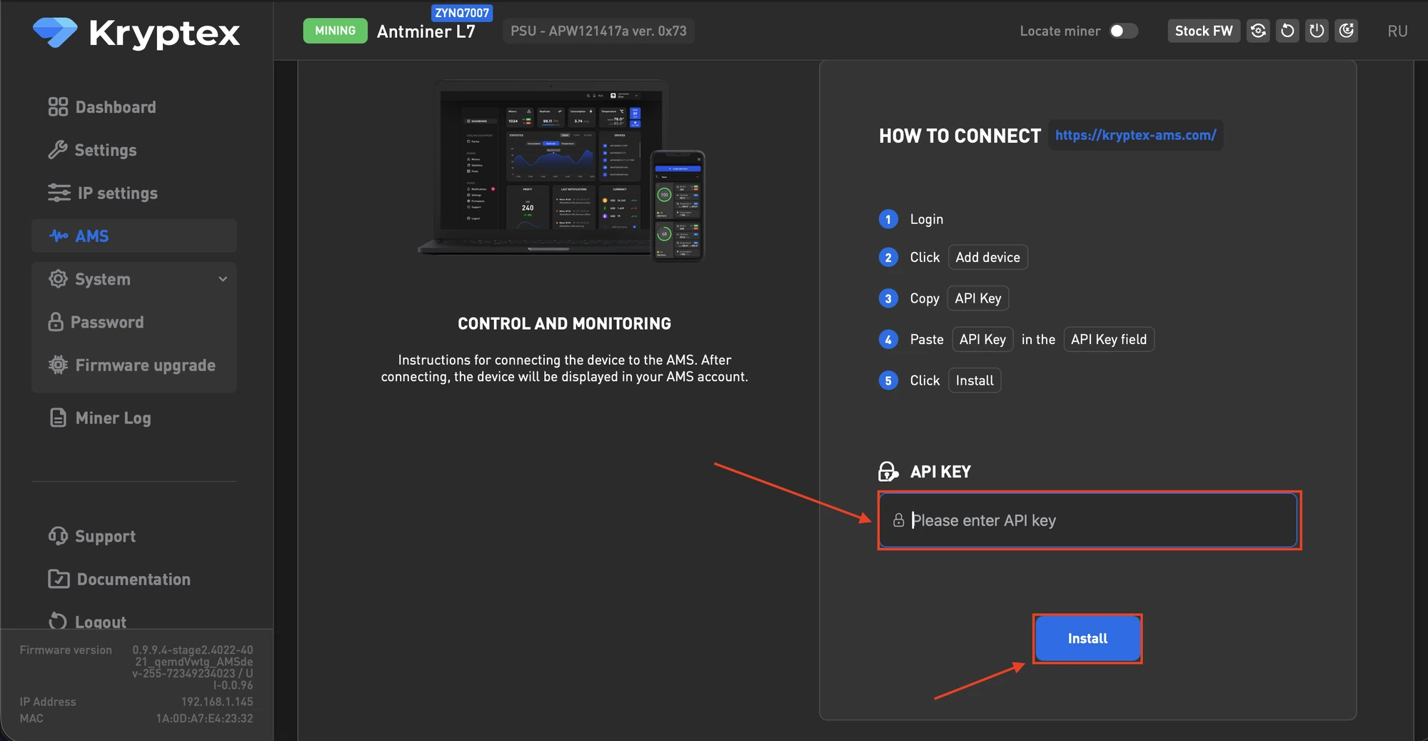

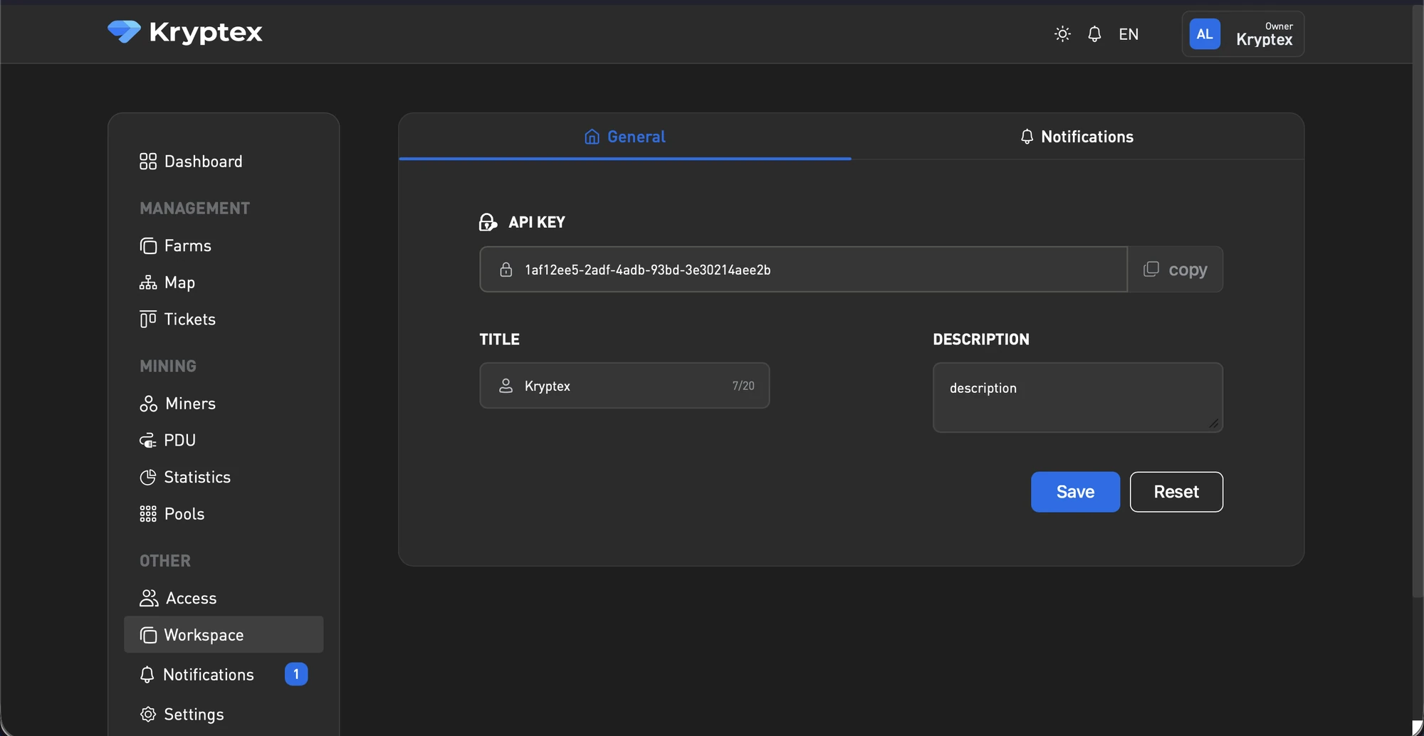

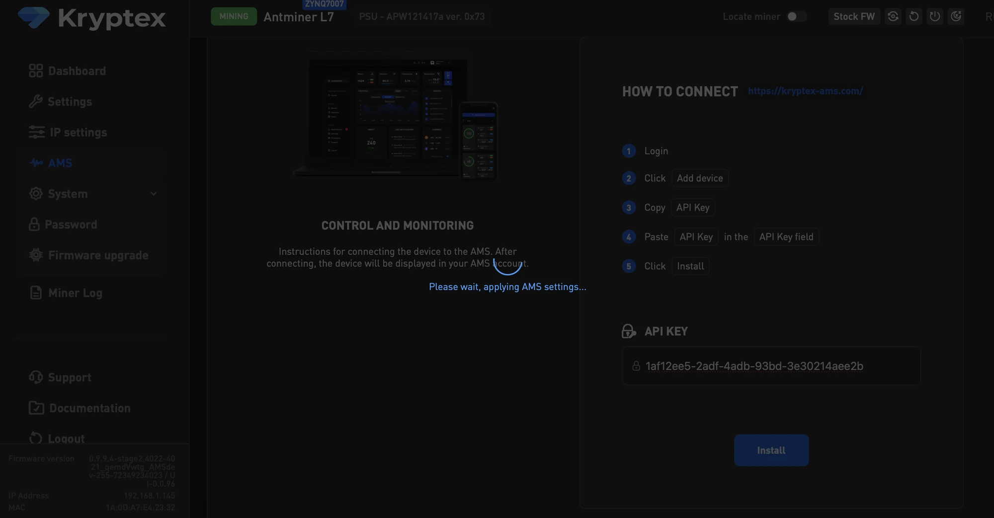

  5. Copy the API key.
  6. Open the ASIC web interface, paste the key, and click “install”.
  7. Wait for it to finish — the process takes 1 to 3 minutes.
  8. Done — the ASIC is added and shows up in AMS.

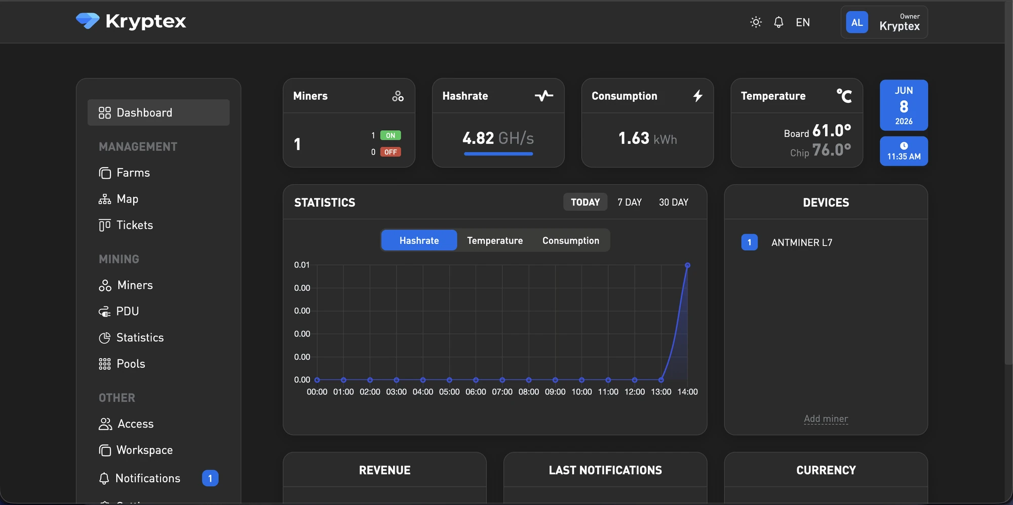

  1. Dashboard — shows the ASICs' key metrics.

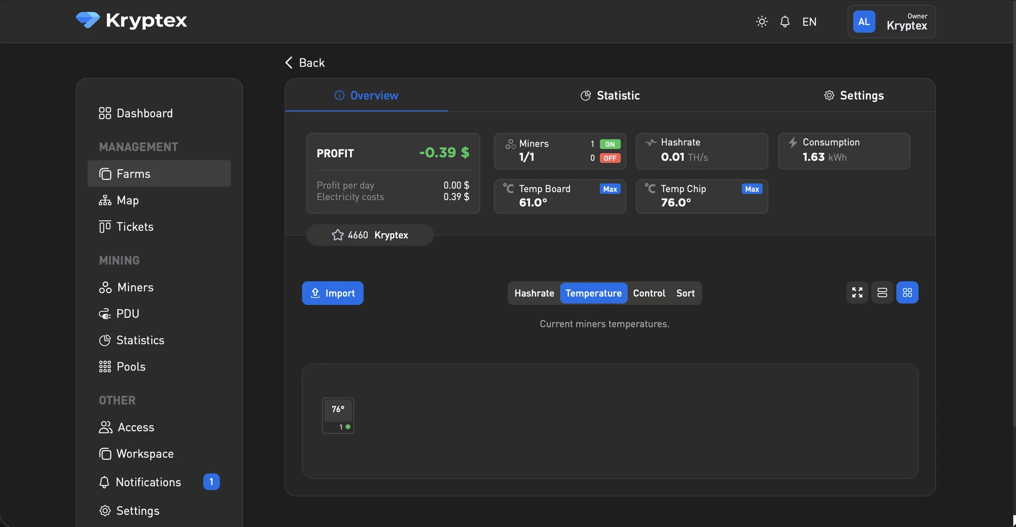

  2. Farms — create farms and add devices, neatly split by location or owner. You can set a per-kWh price for each location.

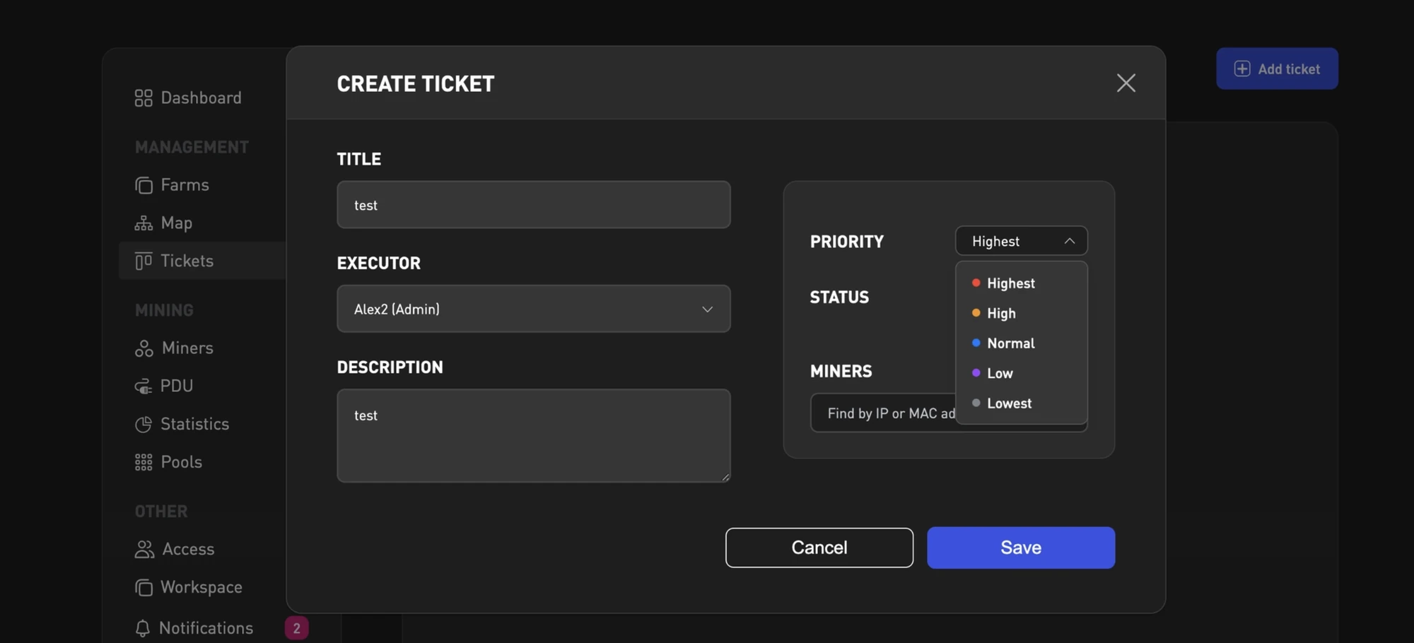

  3. Tickets — create tasks for your team.

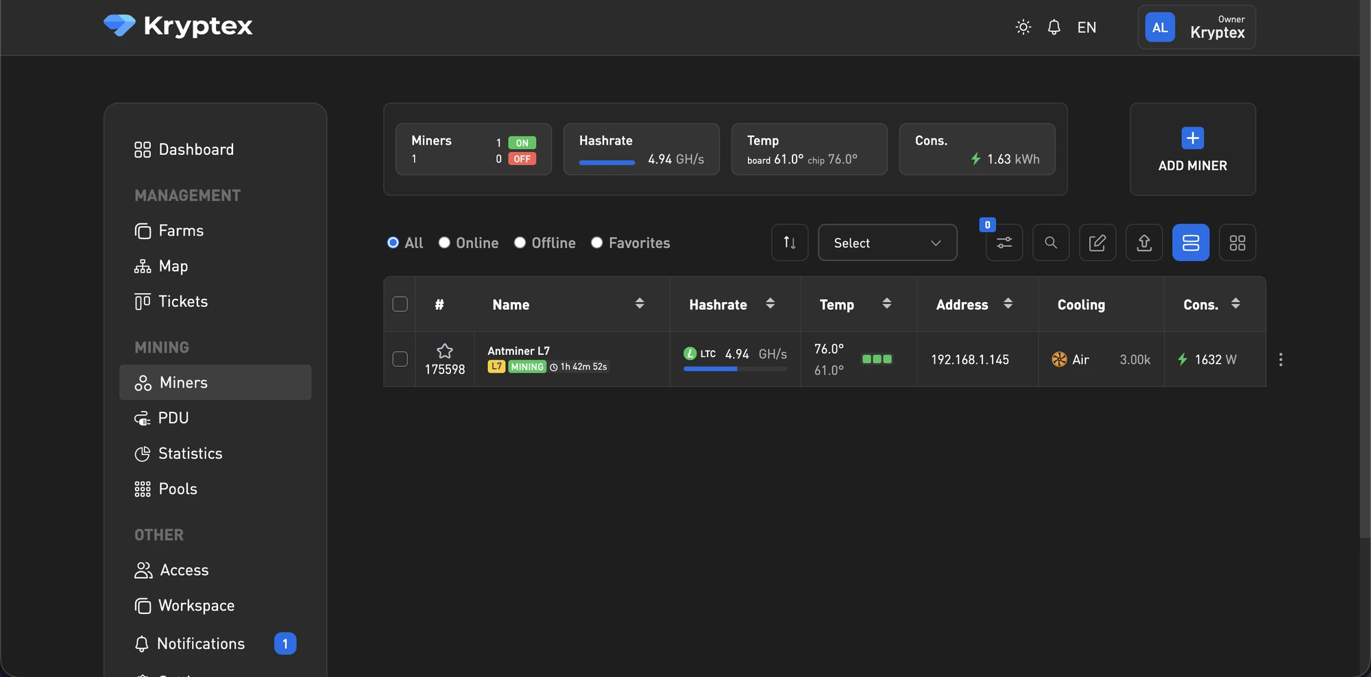

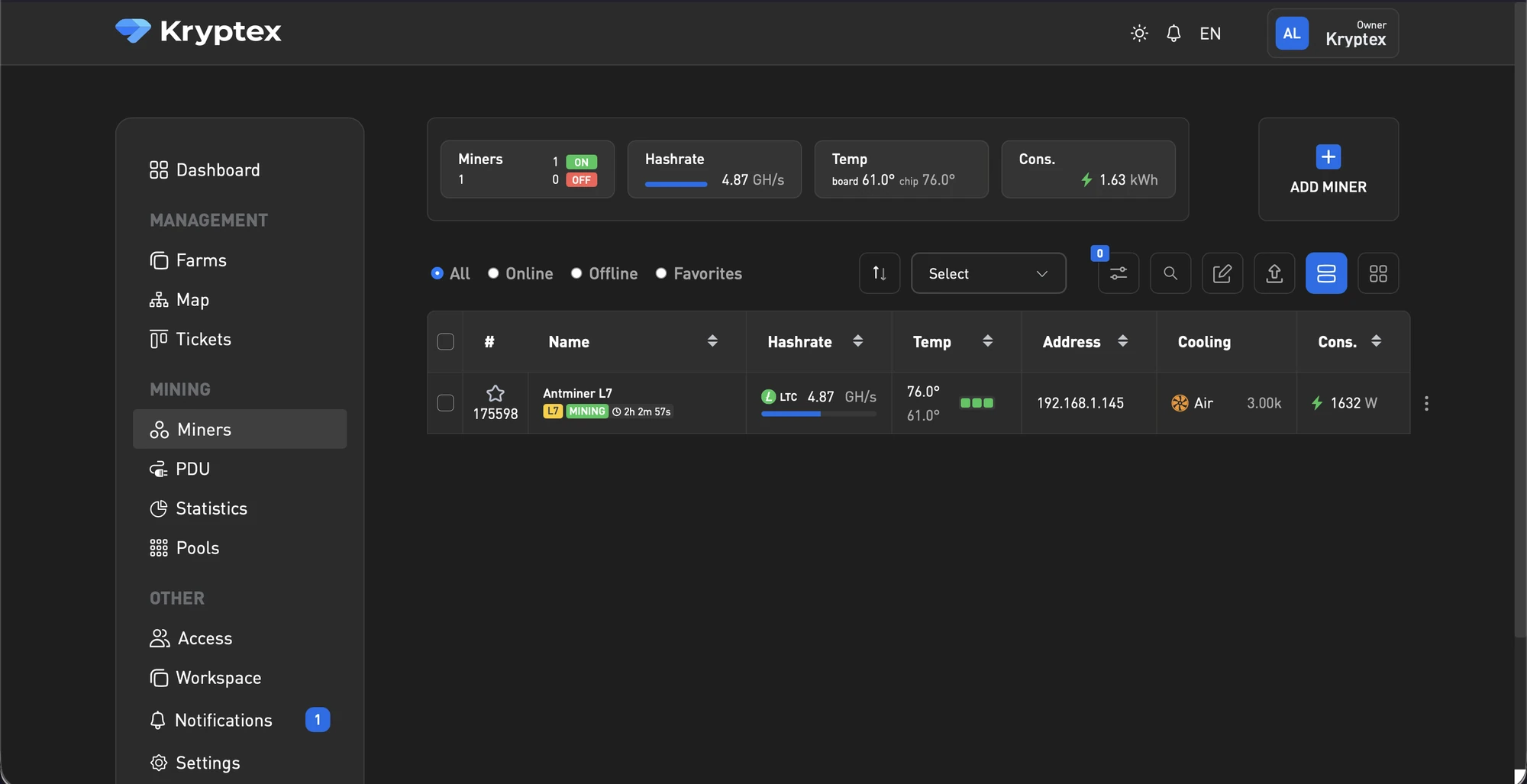

  4. Miners — every device connected to the account, with controls to manage them.

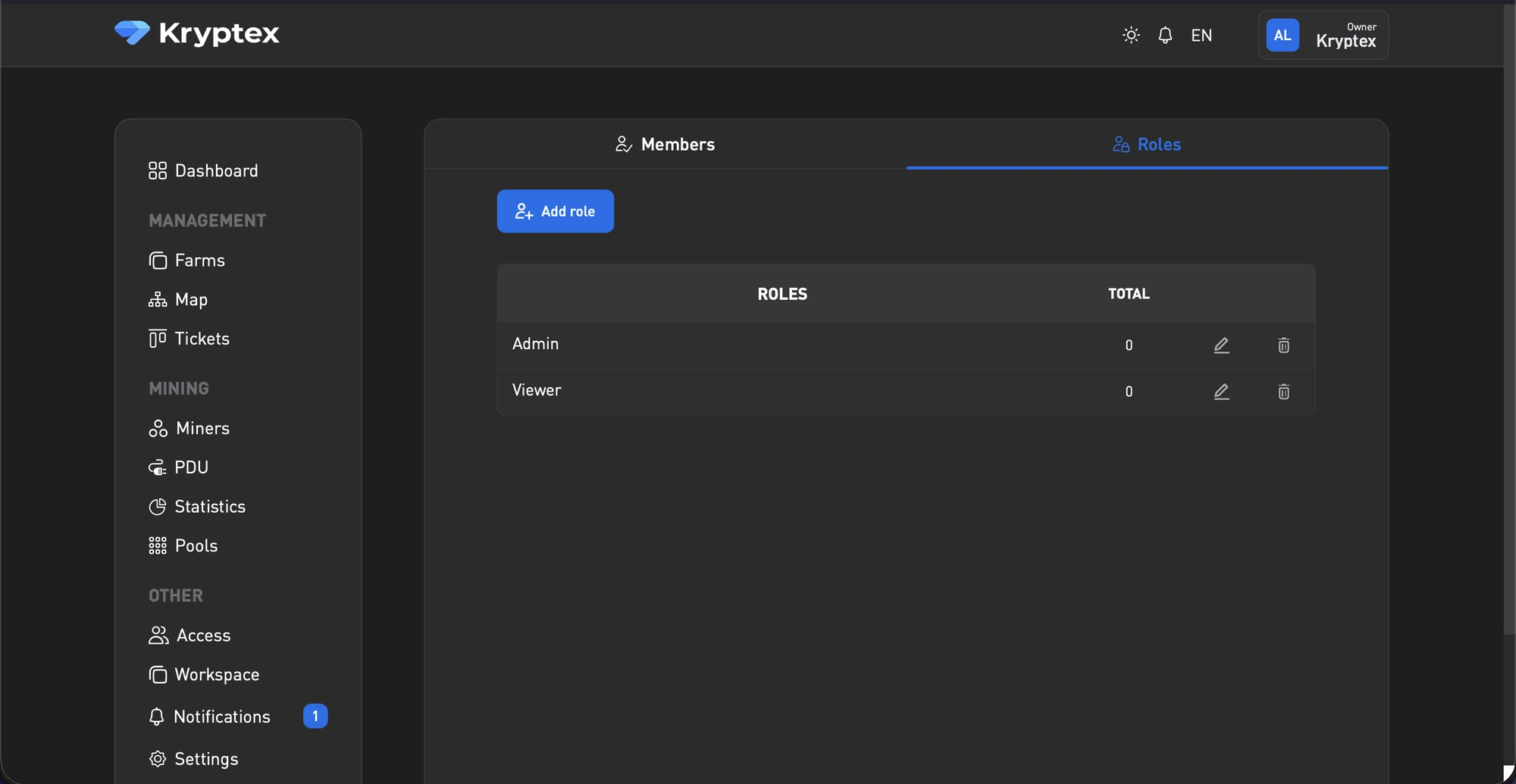

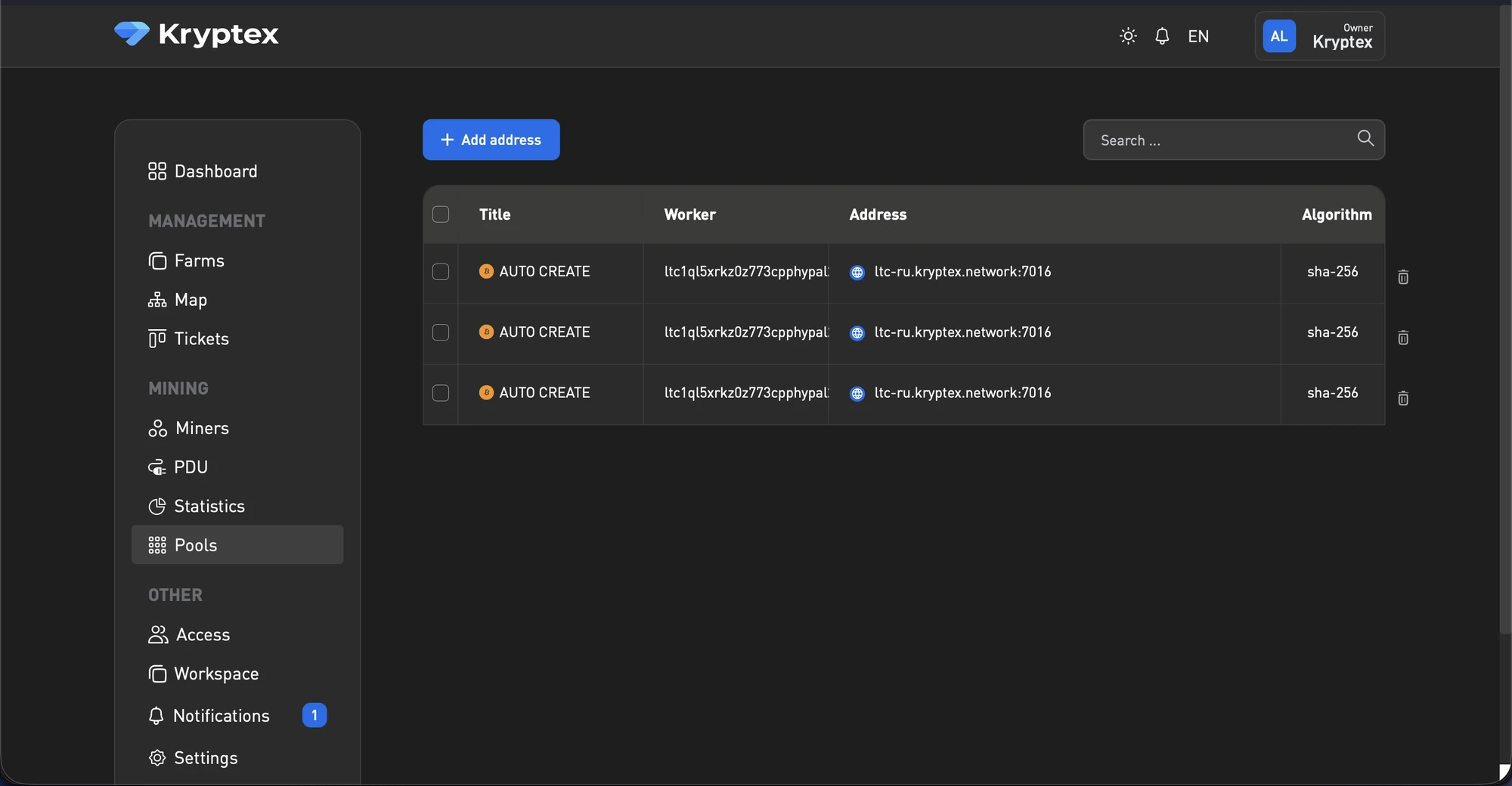

  5. Pools — add pools and switch between them.
  6. Roles — fine-grained access control: invite team members and grant them permissions.
  7. Workspace — set the farm name and link miners via API.

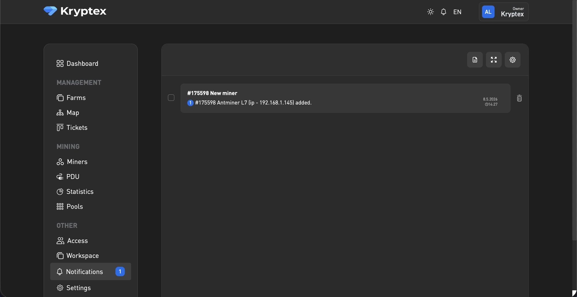

  8. Notifications — all notifications sent by your devices.

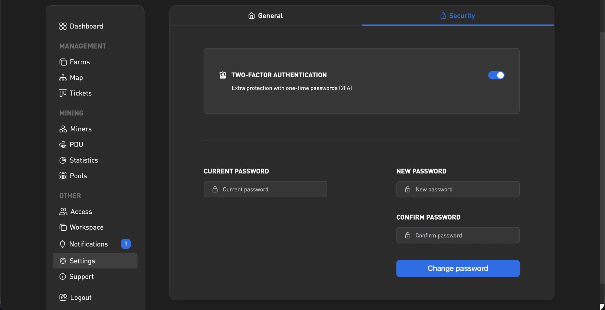

  9. Account settings — change your name, email, and set up 2FA.
