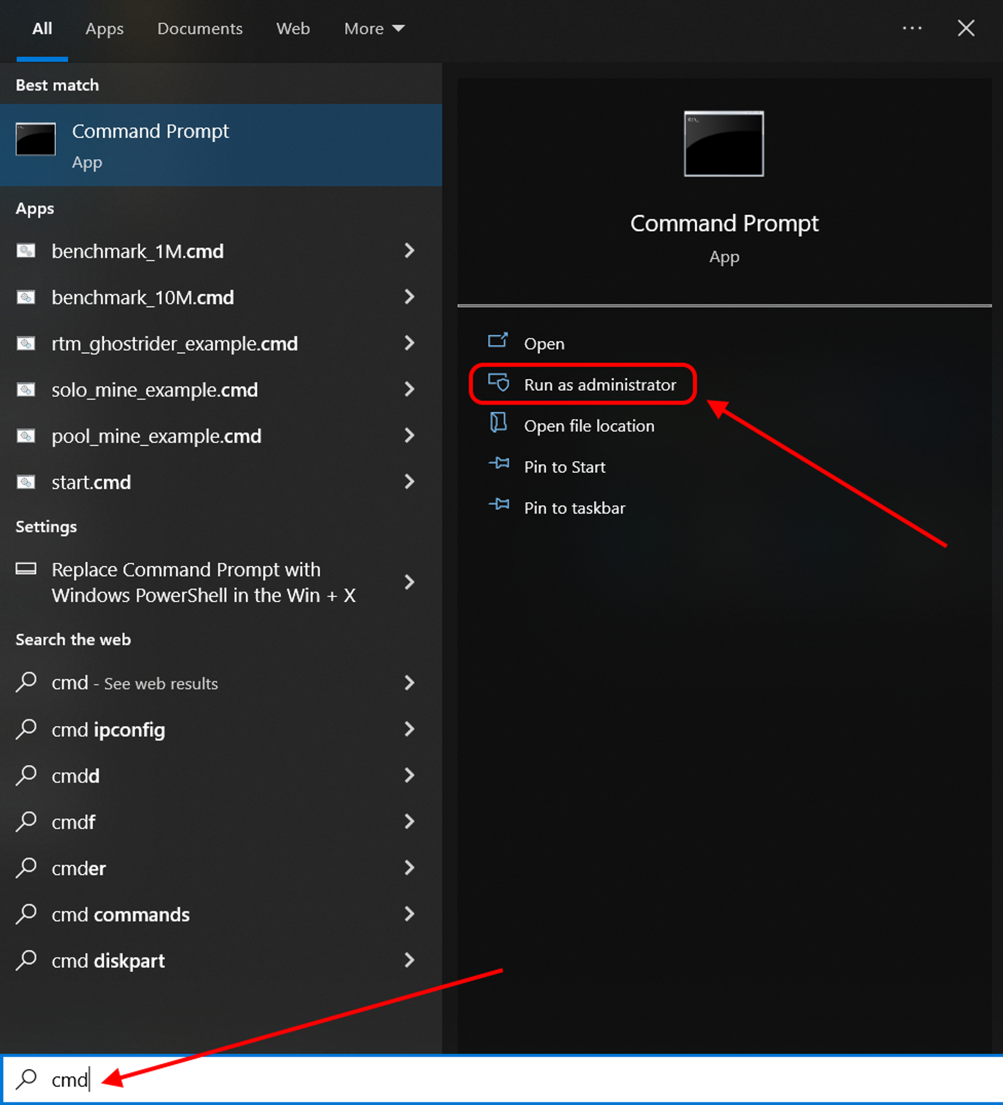

  1. Right click the “Start Menu” and choose “Search”.
  2. Type cmd in the search bar and select "Run as administrator".
  3. You will see the Windows command line.

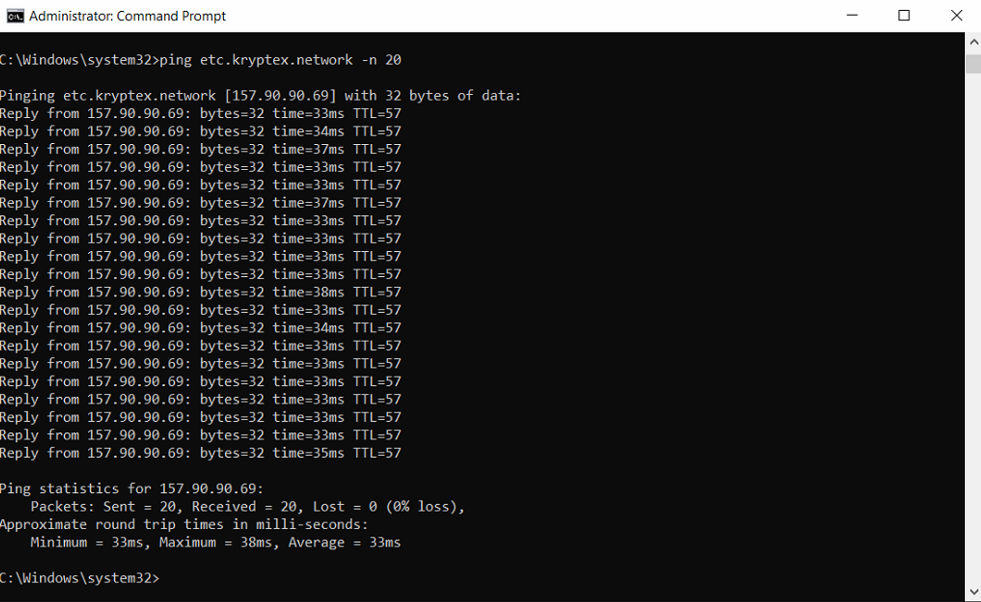

    Type the command ping etc.kryptex.network -n 20 and press Enter.
  4. The command will start the exchange of packets between your PC and the Kryptex pool. When the command finishes its work, you will see the result:
    • the number of sent/received packages — according to the conditions, we set 20 packages;
    • the number of lost packages — should be 0. If you do not have 0, there is a problem with the Internet. Part of the packages (information) was lost during the reception and transmission;
    • approximate time of receiving and transmitting packages — the less, the better! The connection is quite stable if the average value is less than 100 milliseconds and there are no significant deviations.
