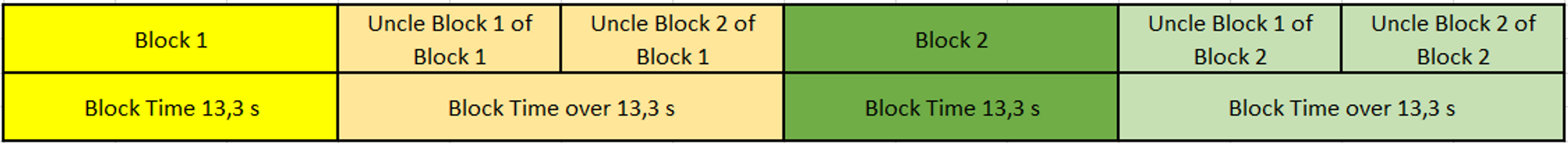

Block time
The block time is the amount of time it takes to send a share and for the pool to accept it to form a block — the amount of time allotted for the share to become accepted.
Miners who have participated in block creation get an additional reward with Uncle blocks.
  • If the miner sends a share within the time given to find Block 1 (averaging 13.3 seconds) — it counts towards finding Block 1.
  • If the miner sends a share for Block 1 after the finding of Block 1 — it is not used but can participate in creating Uncle Block 1 of the first or second order.
13.3 s — average time to find a block. It means if the first block is found within 20 seconds, the second in 10 seconds, and the third in 9 seconds, then the average block time will be 13 seconds.
If the time of the share is more than 30 seconds with a probability close to 100%, it should become stale (rejected) because the pool will not be able to use such a share for block forming. It may be suitable for an Uncle block at most.

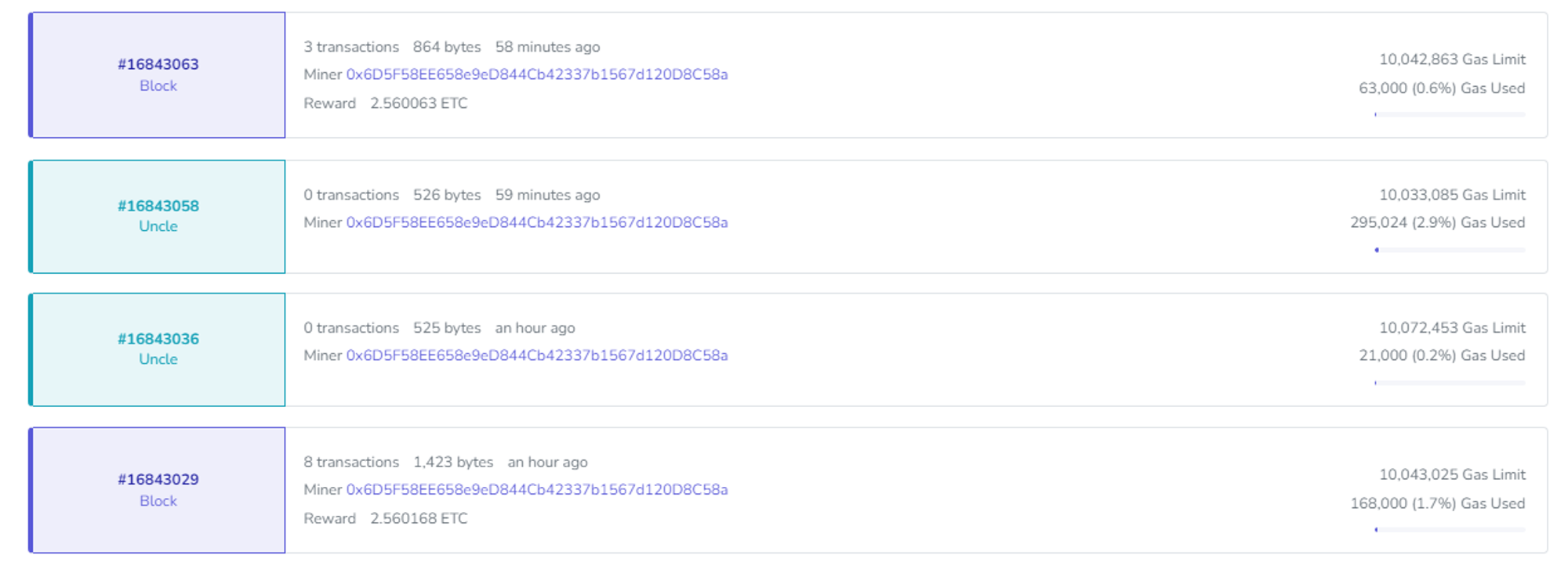

Uncle Block Reward
Uncle blocks are actual blocks created by a miner at almost the same time another miner has already mined a successful block. Uncle blocks formed from stale shares and appear due to network latency.
The reward for an Uncle block depends on the number of Uncle blocks attached and the number of blocks themselves at the moment. Newly created blocks pay for Uncle blocks. Each new block may include up to two Uncle blocks. The reward for each Uncle block is 1/32 of the base reward per block or 3.125% of the reward per block.
