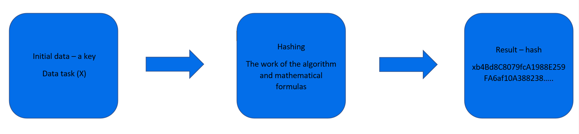

    • A Hash function is an algorithm for converting raw information, using unique mathematical formulas, into a hash.
    • Hash is the result of the algorithm. Data display in the form of a string, unique for the original set of information.

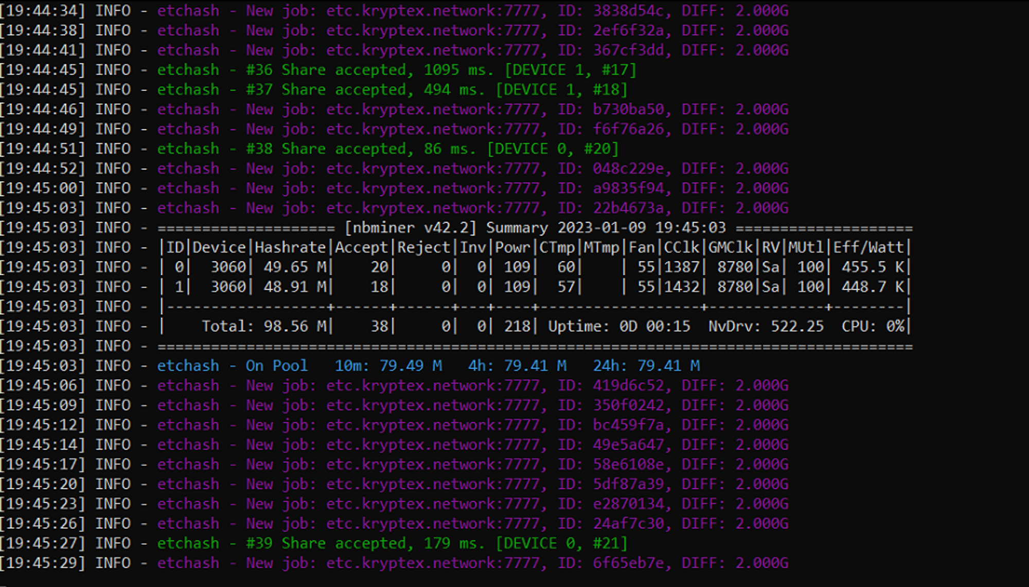

For example, consider ETC coin mining on the Kryptex pool.
Initial data:
  • Share difficulty on the pool — DIFF: 2.000 GH = 2000 MH.
  • 2 RTX 3060 graphics cards
  • Miner — NBMiner
  • In 15 minutes of mining on the pool, the first card (ID 0 — 49.65 Mh\s) found 20 shares.
  • In 15 minutes of mining on the pool, the second card (ID 1 — 48.91 Mh\s) found 18 shares.
How do I know if that's a lot or a little? You can check if the card is working correctly!
Checking whether the graphics card is working correctly
Knowing the difficulty of the share on the pool and the equipment's power (hashrate) — you can calculate the average time the share takes to be found on the pool.
Why? To see if our graphics card is working correctly. To do this, we need the following:
  • Task 1. Find the average share time — the share difficulty needs to be divided by the hashrate of the graphics card.
  • Task 2. Determine the estimated number of shares that our graphics card should find with the current hashrate, at the current difficulty, during the mining time.
The longer the continuous mining time, the more accurate will be the estimated and actual number of shares found by the graphics card.
  • Solution 1. 2000 MH / 49.6 Mh\s = 40.3 seconds = 0.67 minutes — the average time a share should be found.
This average value is based on a pool difficulty and is relevant for a specific time interval. The shares may often come in the beginning, e.g., every 5-10-20 seconds and then every 1-2-5 minutes. On average, we will get about 0.67 minutes.
It happens because the difficulty of each individual share may be different. It depends on the "luck of the equipment" (GPU or ASIC) and how fast it could find the share.
So, we know the average time it takes for a share to be mined on a pool with a given difficulty. In our case, we got 0.67 minutes.
Knowing our uptime (continuous mining time), we can calculate the approximate number of shares that our equipment will receive.
From the initial data — the miner was running for 15 minutes.
  • Solution 2. 15 min (uptime) / 0.67 min (average time to find a share) = 22 shares
Our first GPU (ID 0 - 49.65 Mh\s) found 20 shares. Our second GPU (ID 1 - 48.91 Mh\s) was less successful, finding 18 shares, but its hashrate is also slightly lower.
In the pool statistics, the user can observe whether the hashrate is higher or lower than what his miner window shows. It happens because the pool calculates the hashrate relative to the accepted shares over a while (6 hours, 12 hours, 24 hours) instead of taking the hashrate from the miner window.
The longer the period of uninterrupted mining, the smaller the difference between the calculated and the actual number of shares.

  1. What if we have the same difficulty, uptime, and hashrate and get five shares instead of 20?
    • The difficulty on the pool is static, 2 GH.
    • The pool safely accepted five solutions.
    • So, our graphics card does not mine with the specified hashrate! The miner program is wrong, or the graphics card is "raining" with many invalid shares (glues newspapers instead of wallpaper). We need to look for the problem on our farm.
