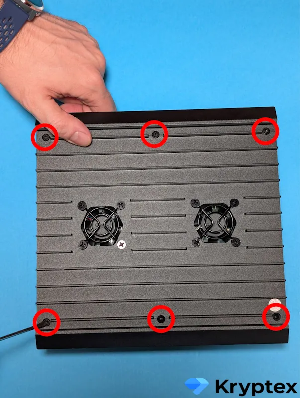

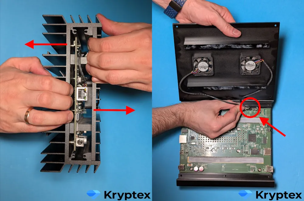

  • Remove the casing cover: It's usually secured with screws.
  • Access the motherboard and radiator: Carefully disconnect fans, wires, and other components to clear access.

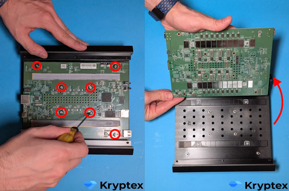

Removing the Radiator
  • Unscrew the bolts: The radiator is fastened to the chips using mounting screws. Unscrew them in a diagonal (criss-cross) pattern to avoid uneven pressure or damaging the chips.
  • Gently detach the radiator: Don't attempt to force it off if it sticks to the chip. Instead, gently wiggle it from side to side. It may take time, but this method is safer.

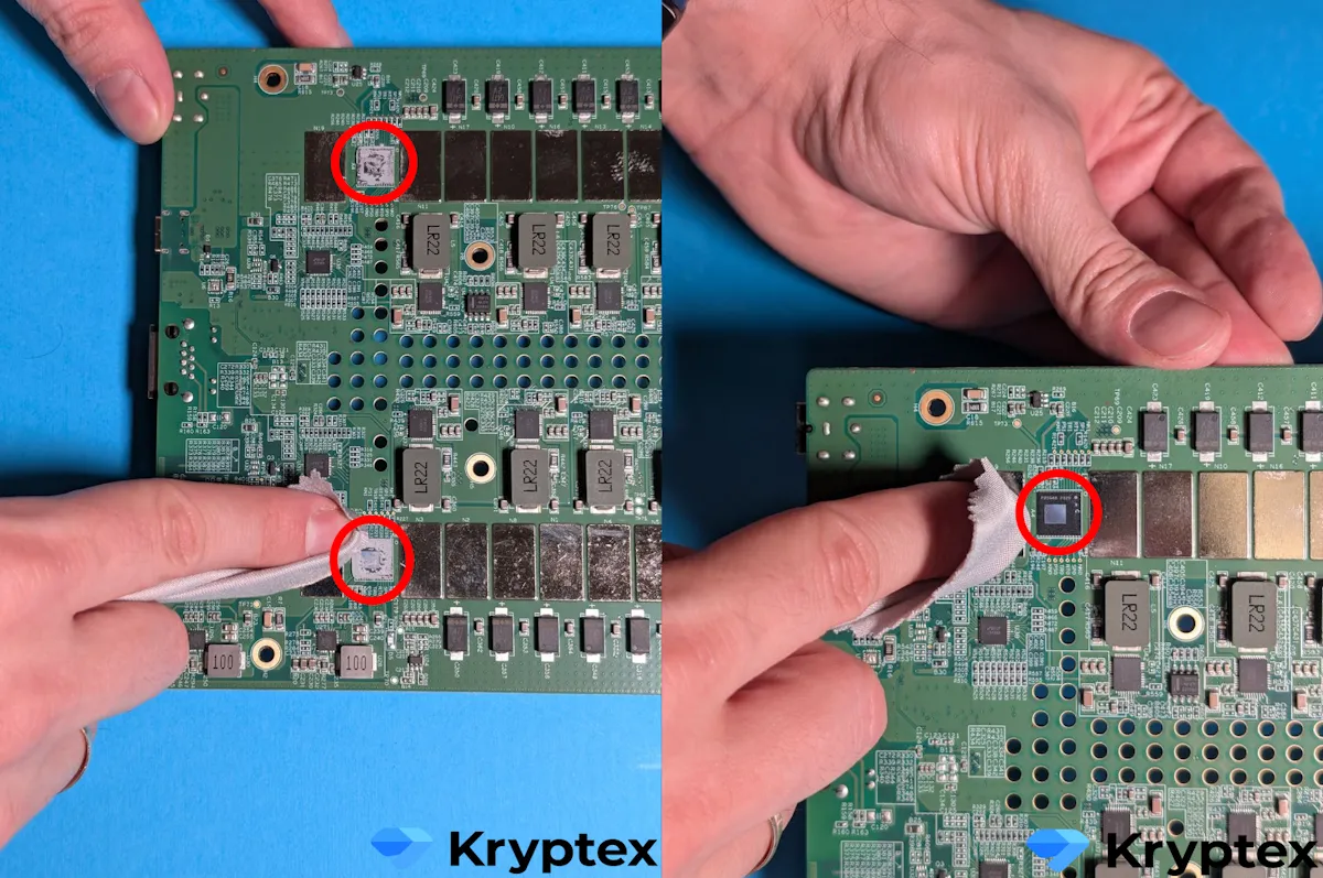

Removing the Old Thermal Paste
  • Clean the chips and radiator: First, remove the old paste with a plastic spatula or card. Then, use isopropyl alcohol and a soft cloth to clean the surface until it shines. Avoid using sharp, metal, or abrasive tools to prevent damaging fragile parts!
  • Ensure no residues of old paste remain, as they may affect heat dissipation.

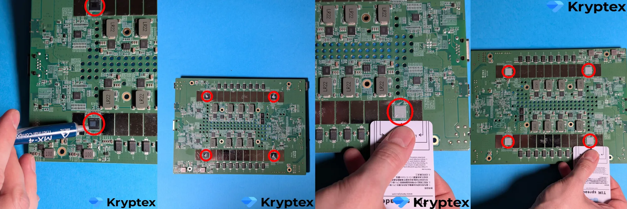

Applying the New Thermal Paste
  • Amount: A pea-sized drop on each chip will suffice.
  • Distribution: You can leave the paste centered as the radiator will distribute it evenly upon installation. Alternatively, carefully spread it into a thin layer with a plastic spatula.
Installing the Radiator
  • Attach the radiator: Place the radiator back and gently tighten the screws diagonally to ensure firm contact with the chips.
  • Reconnect everything: Make sure all fans and wires are correctly connected.
