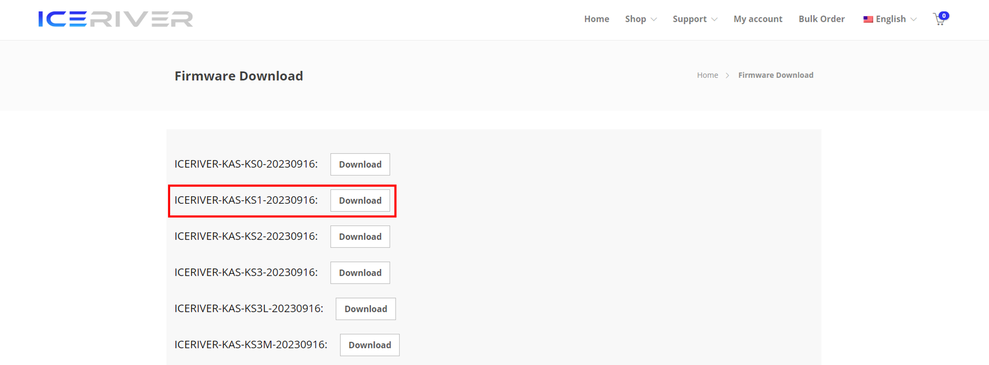

  1. Refer to the manufacturer's instructions and update your ASIC firmware to the latest version available on the official website: https://www.iceriver.io/firmware-download/
  2. After the update, confirm that the ASIC is functioning correctly.

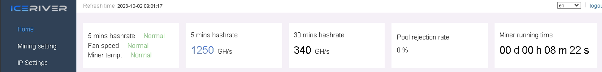

  • 1250 Ghs
    SHA256: 7138381F8337FA9D3CAE88D3B8B9481319894804A146E4EE08C014E551B8EE24
  • 1400 Ghs
    SHA256: 32B50C99349CA2D39AB42B1DEC80824E386BA299A1819DD2667196E836746AE6
There are occasions where, even after upgrading your ASIC to 1400 Ghs, it might not be able to mine at that hashrate. In such situations, opt for a file with a lower hashrate. The hashrate your ASIC can handle is contingent on luck and the "silicon lottery" — essentially, the quality of the chips in your ASIC.

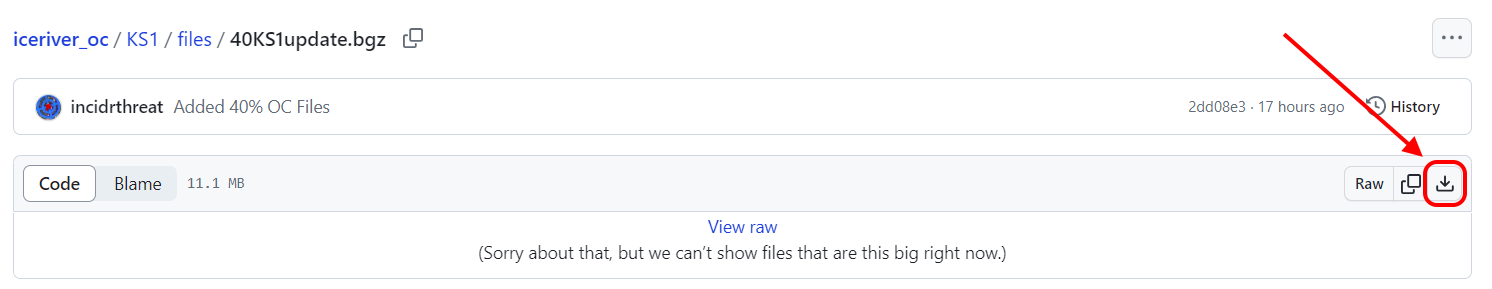

  1. Download the updated file 40KS1update.bgz.
    • SHA256: 32B50C99349CA2D39AB42B1DEC80824E386BA299A1819DD2667196E836746AE6

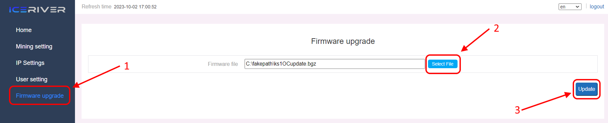

  2. Navigate to ASIC’s webgui “Firmware Upgrade” page.
  3. Click “Select File”, select the downloaded 40KS1update.bgz file on your PC, and click the “Update” button.
  4. Wait for the pop-up window to show success and then reboot your ASIC.
  5. Wait for the ASIC to reboot (do not power off during the reboot process). The whole process may take up to 2-5 minutes.
  6. Done! Your ASIC overclocked!
