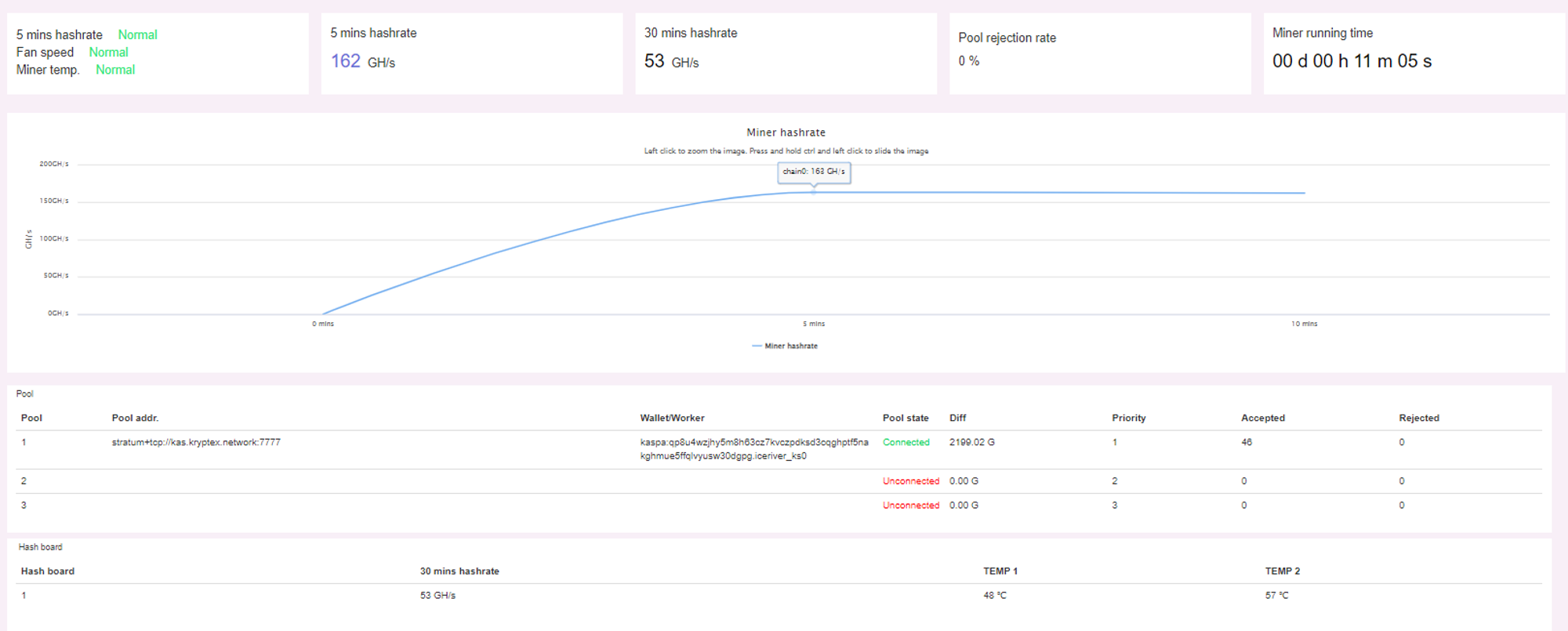

  • After the OC update, the hashrate will boost to 140-170 Ghs, contingent on your chips' quality.
  • The recommended power supply specifications: 19 V, 9.5 A, 180 Watt, plug size 5.5x2.5.
  • KS0 consumption will escalate to 110-125 Watts.
  • Integrate an extra 120 mm fan for top cooling. These fans can draw power from the ASIC's USB connector, although speed control won't be possible. The fan will operate at the minimum speed.
  • Install an additional 120 mm fan for bottom cooling or elevate the ASIC at least 5-10 cm above the surface.
  • Ensure the ASIC doesn't exceed 60 degrees Celsius to prevent a drop in hashrate.

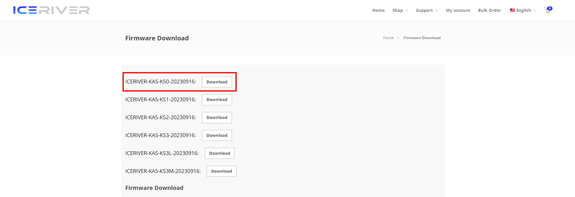

Preparations — IceRiver KS0 Firmware Update
  1. Refer to the manufacturer's instructions and update your ASIC firmware to the latest version available on the official website: https://www.iceriver.io/firmware-download/
  2. After the update, confirm that the ASIC is functioning correctly. Connect a new power supply, add extra cooling, and then proceed with overclocking the ASIC.

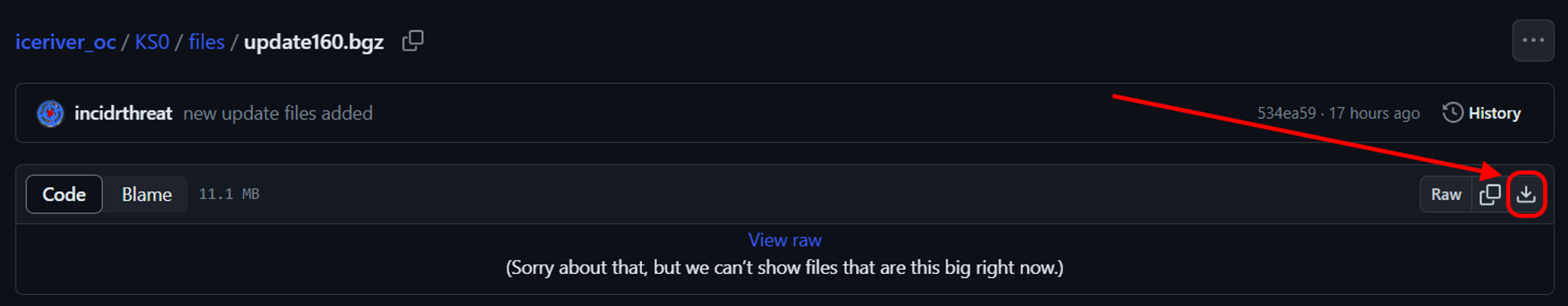

  1. Download the updated file, for instance update160.bgz.
    • SHA256: 69557167DC490588A363989E2AF72C99686A4F459A535B2AAAE5D96D8C607924

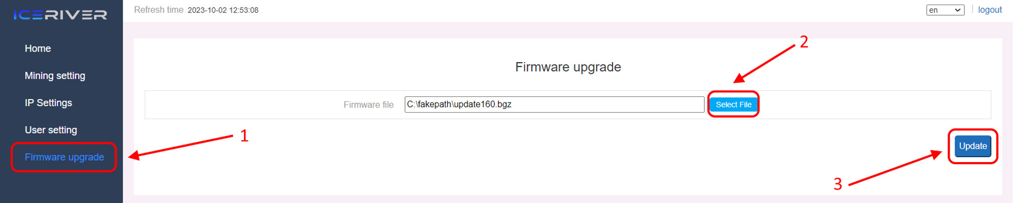

  2. Navigate to ASIC’s webgui “Firmware Upgrade” page.
  3. Click “Select File”, select the downloaded update160.bgz file on your PC, and click the “Update” button.
  4. Wait for the pop-up window to show success and then reboot your ASIC.
  5. Wait for the ASIC to reboot (do not power off during the reboot process). The whole process may take up to 2-5 minutes.
  6. Done! Your ASIC overclocked!
