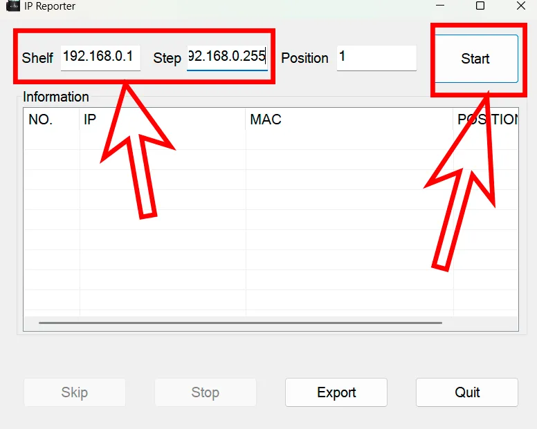

Bitmain Antminer IP Reporter Tool — for Bitmain Antminer ASICs
Download and run the program.
Specify the range of IP addresses of your network in the corresponding field.
Click the "Start" button.
On the ASIC itself, press and hold the "IP Report" button for a few seconds.
The utility will display the IP address of your device.

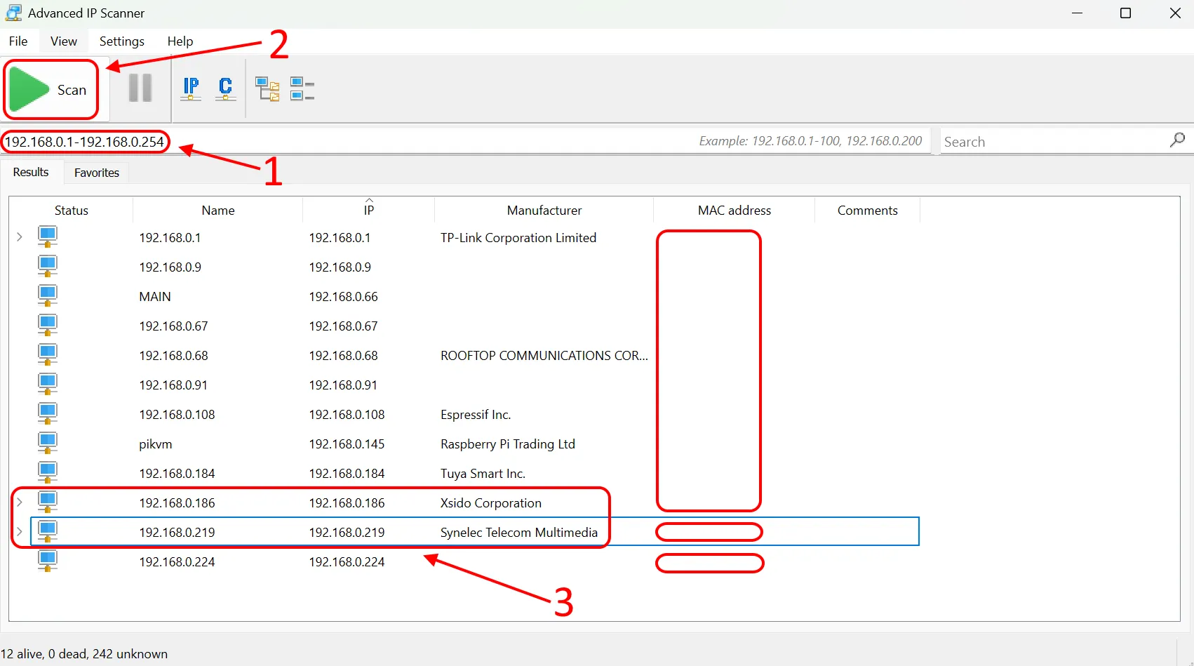

Advanced IP Scanner — a universal utility for searching devices on the network.
Enter the range of IP addresses of your network (for example,
192.168.0.1-192.168.0.254).Click "Scan", wait for the scan to complete.
In the list of found devices, look for ASIC — it is usually defined as a device with the manufacturer's name, or an unknown device with open ports.

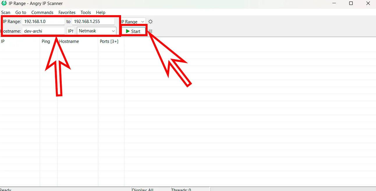

Angry IP Scanner is another option for searching for devices on the network.
- Download and run the program.
- Enter the range of IP addresses of your network (for example,
192.168.0.1-192.168.0.254). - Click "Start", wait for the scan to complete.
- Find a device with active ports
80or4028— this is most likely your ASIC.
If there are several devices on the network and it is difficult to determine which of them is your miner, try disconnecting all other devices (except ASIC and PC) and repeat the scan.

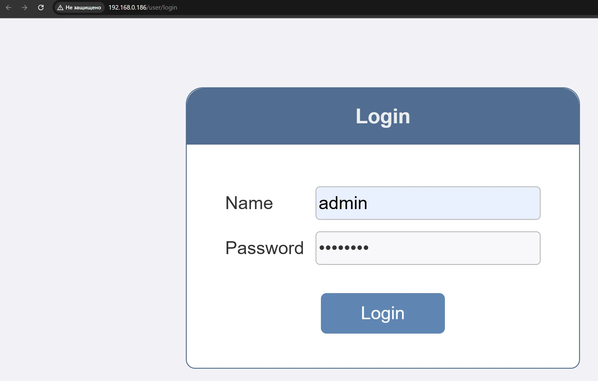

Once you have found your ASIC on the network and determined its IP address, you can access the ASIC interface.
Open any internet browser, enter the ASIC IP address in the address bar, then press Enter.
The web interface will open, prompting you to enter your login and password.
The default login credentials vary by manufacturer:
- For Bitmain Antminer miners, the default login and password are
root. - For MicroBT Whatsminer miners, the default login and password are
admin. - For IceRiver miners, the default login is
admin, and the password is12345678.

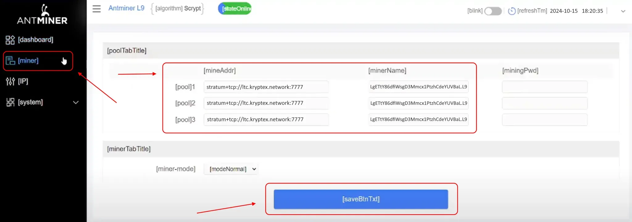

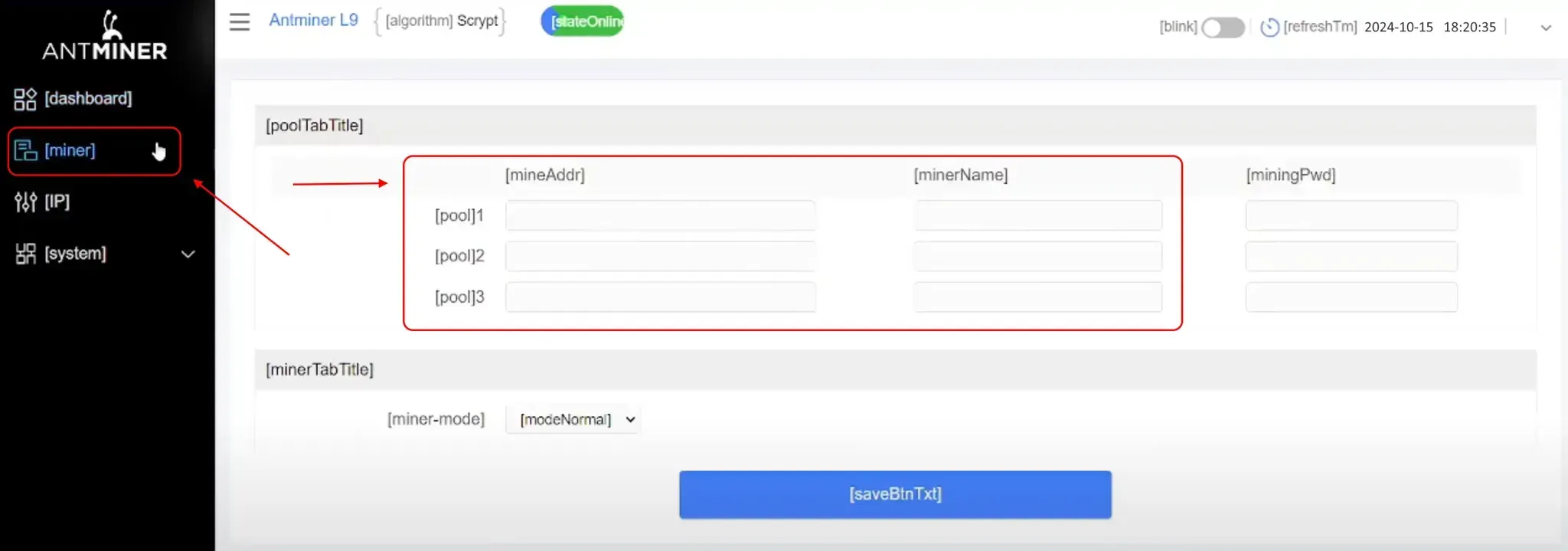

Open the mining settings menu.
- It may be called Miner, Settings, Mining settings, Configurations, Miner Configurations.
Enter the data in the corresponding fields:
- Pool Address / URL / Pool URL — pool address.
- Miner Name / Wallet / Worker / Wallet Address — wallet address and worker name.
- Pwd / Password / Pass — password (usually not required, you can leave
x).
Add backup connections.
Most ASICs have 3 lines for entering additional pool addresses.
Several addresses are also available on pools — you can use different ones or duplicate the main one.

How to connect ASIC to Kryptex pool

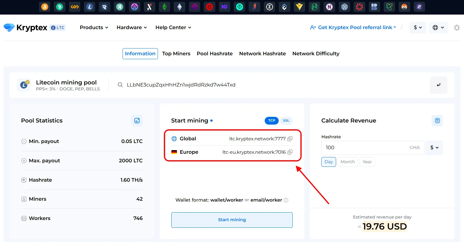

- Get pool address
Go to the main page of Kryptex Pool — https://pool.kryptex.com/
Select the coin you will mine.
Select the pool address in your region (if you are not sure — take the first one on the list).
Copy and paste it into the Pool Address field.
- Specify the wallet address and worker name
- Wallet address — payments will be sent here.
- If you don't have a wallet, create one: How to create a crypto wallet.
- If you mine on a Kryptex account, use Mining Username (format
krxXXXXX, you can find it in Profile). - Worker name — any ASIC name (Latin letters, numbers, no spaces or special characters).
- Example for LTC:
- Wallet address:
LgETtY86dfiWsgD3Mmcx1PtzhCdeYUVBaL - Worker name:
ASIC1 - Result:
LgETtY86dfiWsgD3Mmcx1PtzhCdeYUVBaL.ASIC1
- Wallet address:
- Example for LTC:
- Save settings and restart ASIC
Paste data in three lines for the pool.
Click Save.
Reboot ASIC with Reboot button or power cycle.
⏳ Loading may take from 5 to 30 minutes.

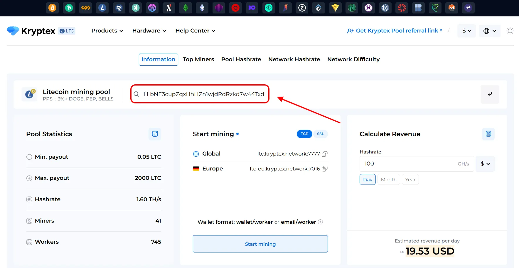

If you mine to a wallet
Open the Kryptex pool — https://pool.kryptex.com/
Select a coin (for example, LTC).
Enter the wallet address in the search and click “Find”.
On the statistics page you will see:
- List of your ASICs.
- Current hashrate.
- Number of accepted, rejected and invalid shares.
- History of payments and hashrate for 24 hours.

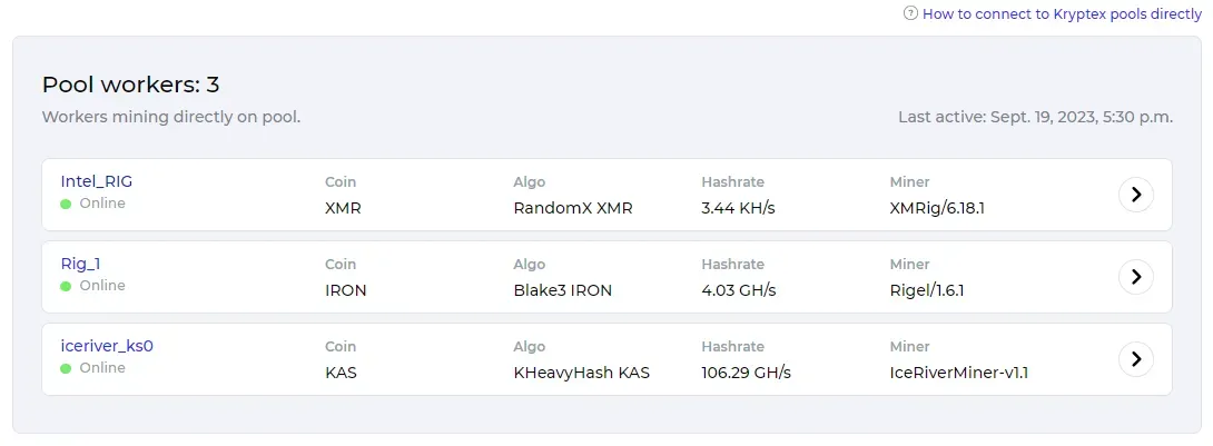

If you mine on a Kryptex account (auto-conversion to BTC)
- Go to the Kryptex website — https://www.kryptex.com/
- Log in to your account.
- Open the “Hardware” tab.
- Find your ASIC and check:
Online status.
Current hashrate.
Number of sent and rejected shares.
Balance of accruals.
