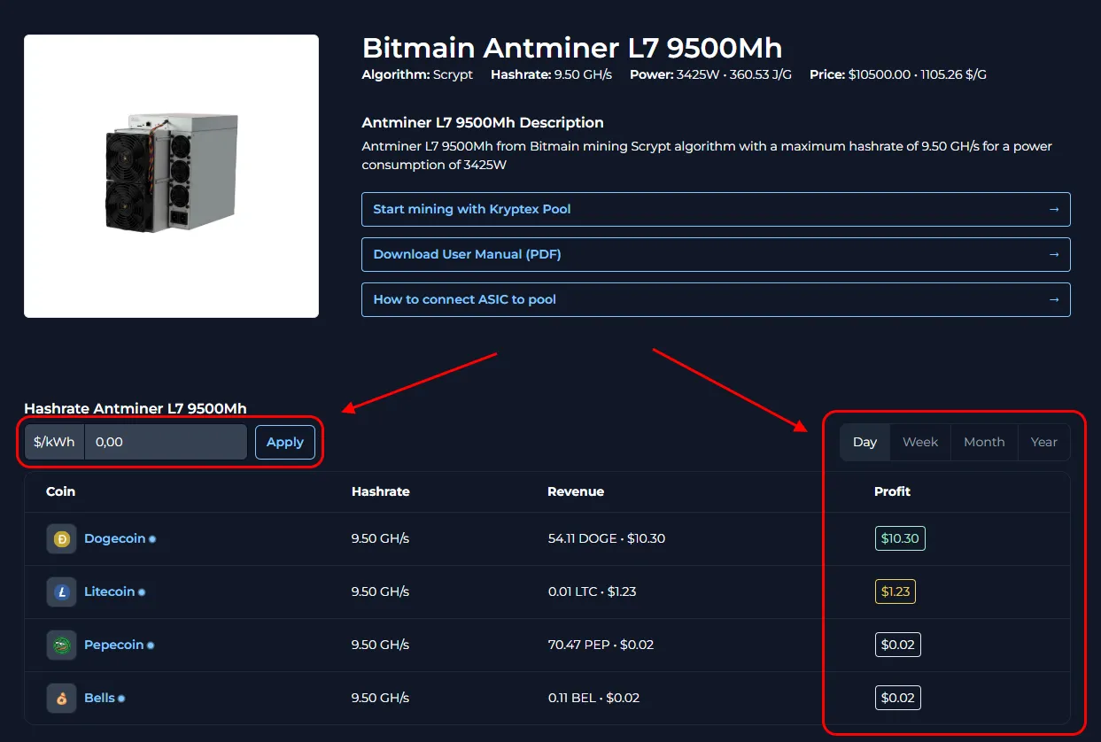

Bitmain Antminer L7 Profitability
| L7 9500 | 9500 Mh/s (±10%) | 3425 Watt (±10%) |
| L7 9300 | 9300 Mh/s (±10%) | 3425 Watt (±10%) |
| L7 9160 | 9160 Mh/s (±10%) | 3225 Watt (±10%) |
| L7 9050 | 9050 Mh/s (±10%) | 3260 Watt (±10%) |
| L7 8800 | 8800 Mh/s (±10%) | 3168 Watt (±10%) |
Check the profitability of Bitmain Antminer L7 9500 ASIC on the mining calculator.

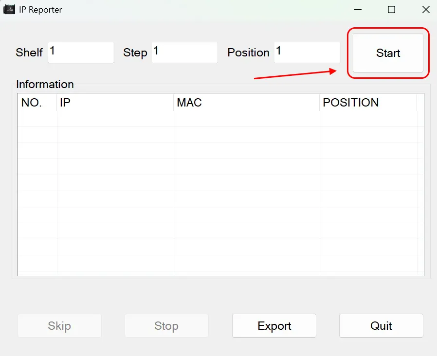

On a computer connected to the same network as the ASIC, download the Bitmain Antminer IP Reporter Tool.
Launch the tool and click the "Start" button.

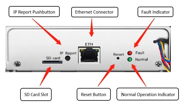

Press and hold the "IP Report" button on the ASIC for a few seconds.
The tool will display the IP address of your device.

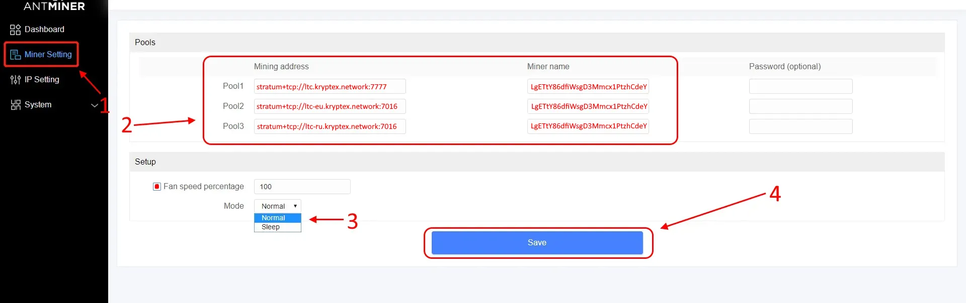

Configure Pool Settings:
In the interface, navigate to the “Miner Setting” section.
Coin Mining Address — Pool Address Miner Name — Wallet Address and Worker Password LTC+DOGE+BEL+PEP stratum+tcp://ltc.kryptex.network:7016orstratum+tcp://ltc-eu.kryptex.network:7016orstratum+tcp://ltc-ru.kryptex.network:7016orstratum+tcp://ltc-us.kryptex.network:7016orstratum+tcp://ltc-sg.kryptex.network:7016LTC_WALLET_ADDRESS.WORKER_NAMExor leave blankMiner Name — Specify wallet and worker name in the format
LgETtY86dfiWsgD3Mmcx1PtzhCdeYUVBaL.AntminerL7, where:LgETtY86dfiWsgD3Mmcx1PtzhCdeYUVBaLis your wallet address.AntminerL7is the name of your ASIC, written in Latin characters or numbers.
Select the working mode “Normal.”
Make sure to complete all three lines with the settings of the same pool. Click “Save” to save the settings and restart the ASIC.

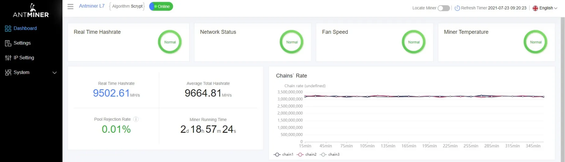

Once the restart is complete, wait a few minutes. Open your browser, enter the ASIC’s IP address, and log in using your credentials.
On the “Dashboard” page, you’ll see the current status of the ASIC, including hash rate, uptime, temperature, and other metrics.

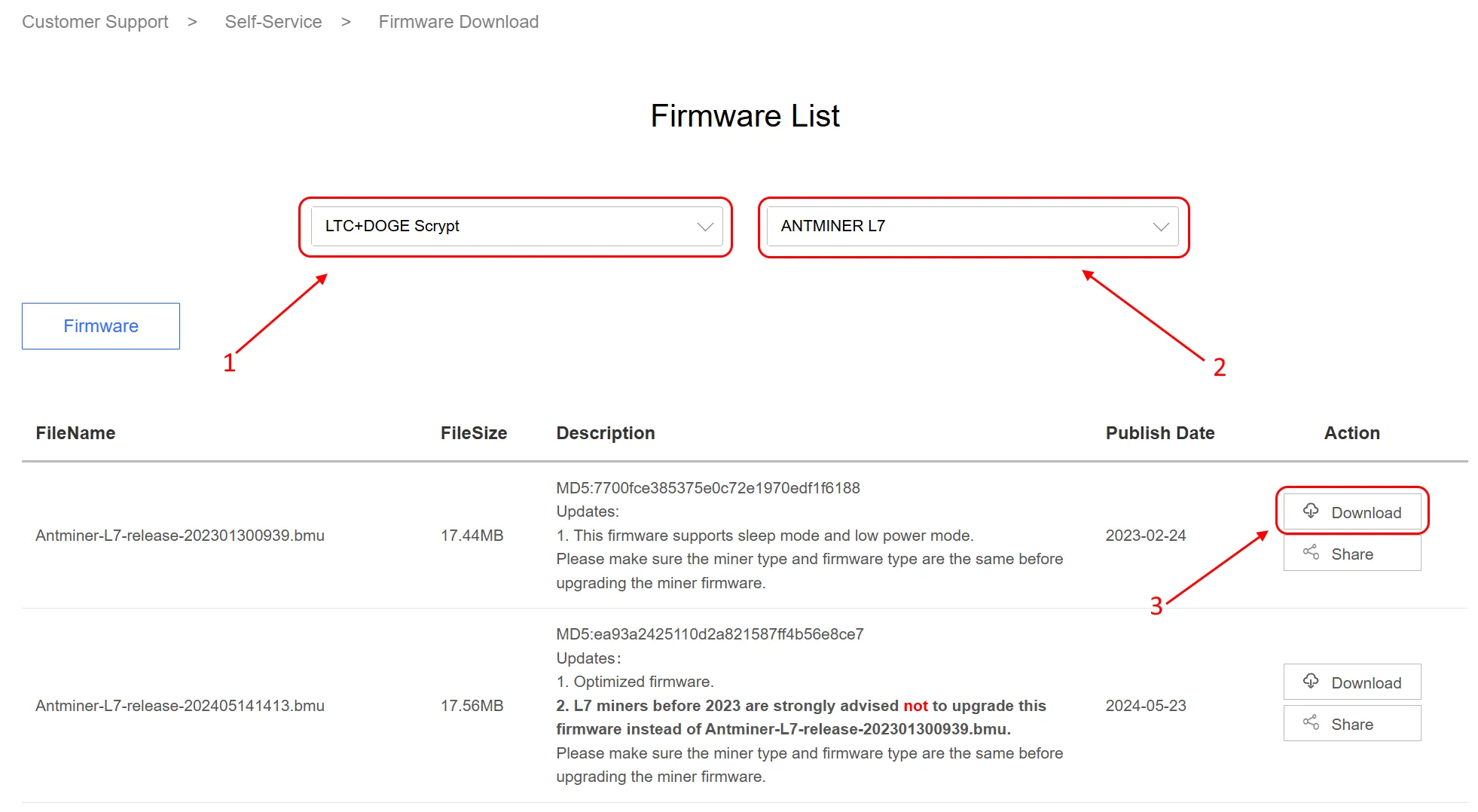

Bitmain Antminer L7 Firmware Update
Visit the developer's website and open the firmware download page: https://shop.bitmain.com/support/download.
Select the algorithm for your ASIC — LTC+DOGE Scrypt, and choose your ASIC model from the list — in this case, Antminer L7.
Download the firmware file by clicking the “Download” button.
Open the “Firmware upgrade” section in your ASIC settings:
- Click the button to select the downloaded firmware file.
- Tick the checkbox for “Keep settings” if you wish to retain your ASIC settings during the upgrade.
Click “Upgrade” and wait for the firmware update to complete. Do not turn off the ASIC during the update process.
