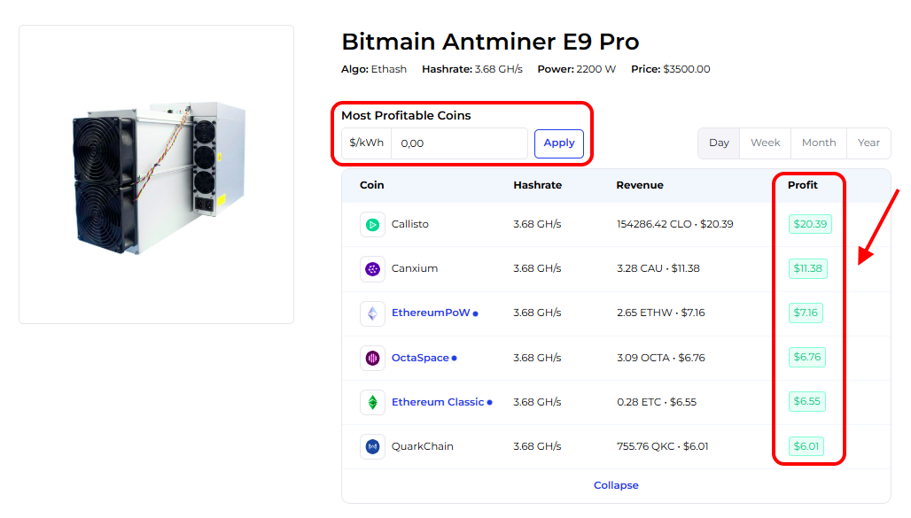

Antminer E9 Pro Profitability
Currently, the profitability of Antminer E9 Pro ASIC varies from 6$/day up to 20 $/day, depending on the mining coin, and excluding electricity costs.
We recommend to check the actual profitability in our mining calculator, where you can also calculate the profitability including your electricity costs.
Check the profitability of ASIC Antminer E9 Pro on the mining calculator.

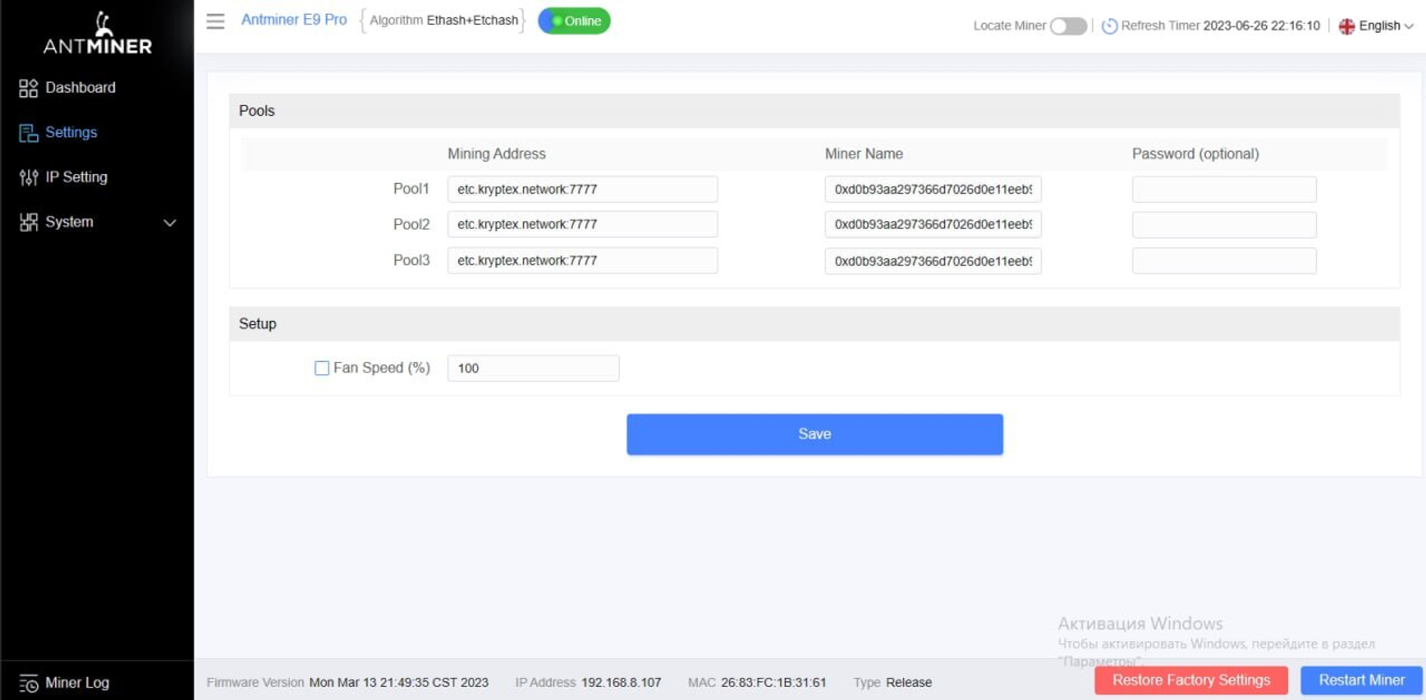

Antminer E9 Pro Settings
Initially, Antminer E9 Pro comes with firmware for Ethereum Classic (ETC). To mine different coin, such as Ethereum PoW (ETHW), you will need to change the firmware.
Go to “Settings” tab setup your ASIC.
| Coin | Mining Address | Miner Name | Password |
| ETC | etc.kryptex.network:7033 or stratum+tcp://etc.kryptex.network:7033 |
leave blank |
| ETHW | ethw.kryptex.network:7034 or stratum+tcp://ethw.kryptex.network:7034 |
ETHW_WALLET_ADDRESS.WORKER_NAME |
leave blank |
| OCTA | octa.kryptex.network:7032 or stratum+tcp://octa.kryptex.network:7032 |
leave blank |
0x3BF96862802EFe07B51c4E18D8232d8439aec373.e9pro where
0x3BF96862802EFe07B51c4E18D8232d8439aec373— your wallet address;e9pro— Your ASIC name.
Click “Save” to save the settings, and then click “Restart Miner” to restart the ASIC.
After restarting, the ASIC requires up to 15 minutes to establish a connection for ETC coin and up to 30 minutes for ETHW coin.

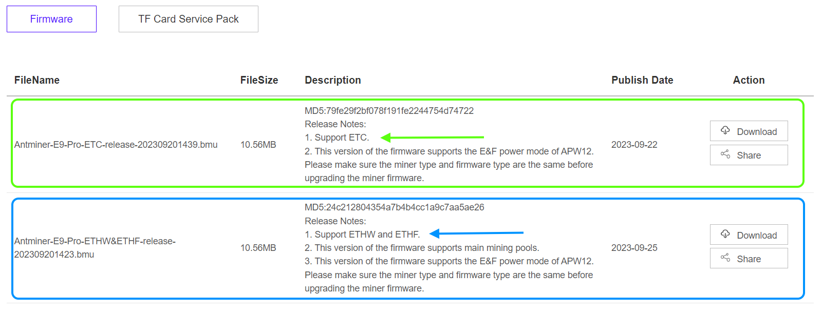

Initially, ASIC Antminer E9 Pro comes with firmware that allows you to mine Ethereum Classic (ETC). To mine OctaSpace (OCTA) or Ethereum PoW (ETHW) — you will need to change the firmware.

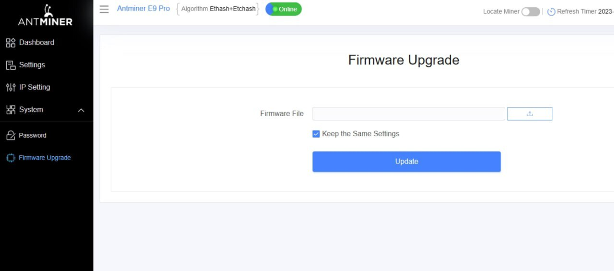

You can update or change the firmware yourself, for this:
Go to the manufacturer's website and download the required firmware: https://shop.bitmain.com/support/download
Open the page for updating “Firmware Update”, select the downloaded update.
