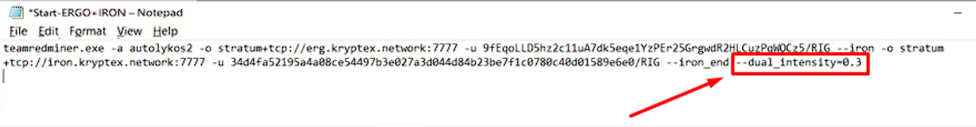

TeamRedMiner
Specify the argument in any part of the bat file, or in the advanced settings of the miner in HiveOS/RaveOS, in the format: --dual_intensity=0.3.
Where --dual_intensity= is the argument and 0.3 is the value of the argument.
The argument values are specified separated by comma for each graphics card, or once for all graphics cards at once.
Example for several GPUs: --dual_intensity=0.1,0.2,0.1,0.3
The allowed range of --dual_intensity values for TeamRedMiner is from 0.1 to 1.0, in increments of 0.1.

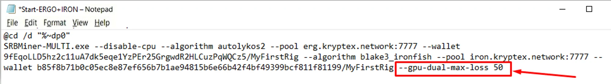

Setting --gpu-dual-max-loss in SRBMiner
The --gpu-dual-max-loss argument is analogue to the --dual_intensity argument, and is used in SRBMiner to adjust the allowed hashrate loss (in %) on the first coin during automatic calibration of dual-mining.
The principle of operation is the same: the higher the value --gpu-dual-max-loss — the higher the hashrate on the second coin and the lower the hashrate on the first coin.
Specify the argument in any part of the bat file, or in the advanced settings of the miner in HiveOS/RaveOS, in the format: --gpu-dual-max-loss 50.
Where --gpu-dual-max-loss is the argument, and 50 is the value of the maximum allowed hashrate loss on the main coin, in percent.
Example for several GPUs: --gpu-dual-max-loss 50,55,60,45
The allowed range of --gpu-dual-max-loss values for SRBMiner is from 0 to 95, in increments of 1.
If you run dual-mining without specifying this argument, the miner will automatically calibrate the intensity for your graphics cards.

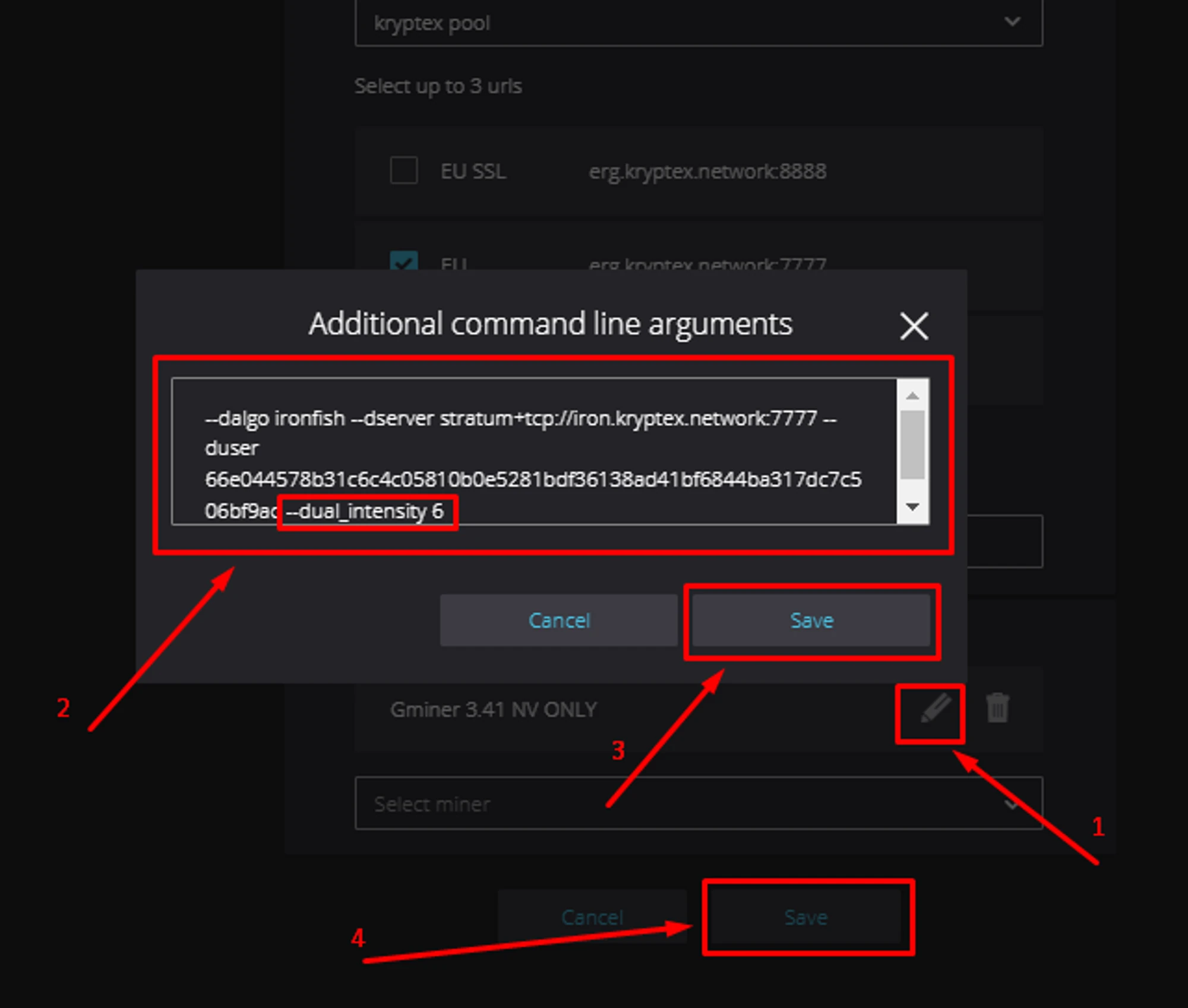

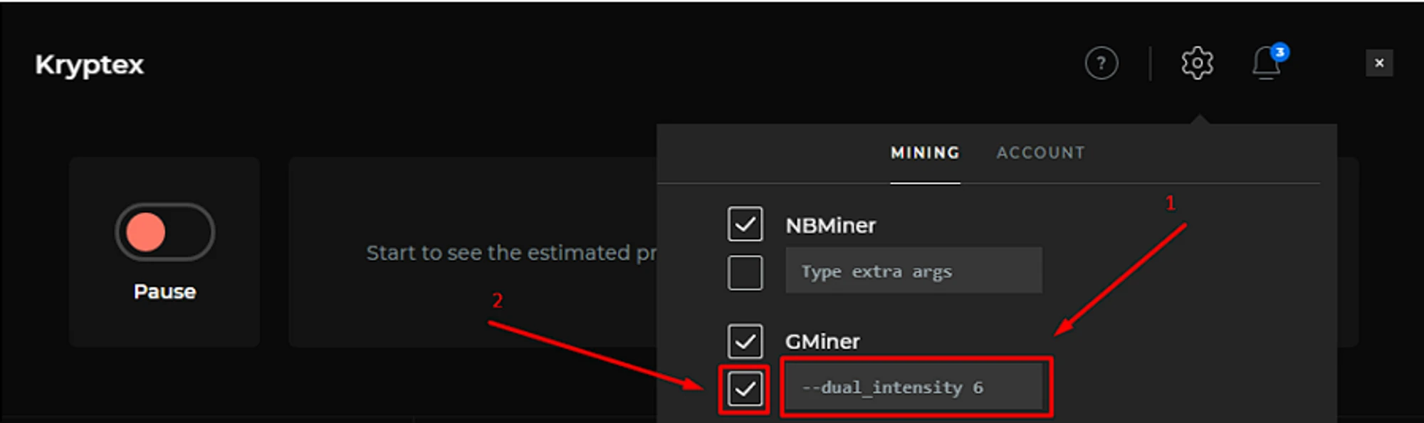

Setting --dual_intensity in Kryptex app
Step-by-step setting of --dual_intensity in Kryptex app:
  1. Stop mining.
  2. Open Kryptex settings → "Mining".
  3. Find the required miner in the list, specify the --dual_intensity argument with the required value in the argument box;
  4. Tick the checkbox next to the arguments box of the miner to apply the settings.
  5. Done! Start mining and get the required dual-mining intensity results.
Important note! If you specify an argument for GMiner, you must put a space between the argument and the value. If you specify an argument for TeamRedMiner, it is necessary to use the = sign. >

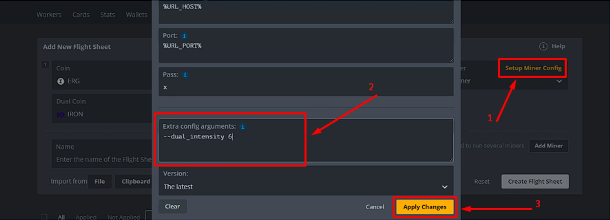

Setting --dual_intensity in HiveOS
Step-by-step setting of --dual_intensity in HiveOS:
  1. Create a flight list for dual mining;
  2. Open the miner settings → "Setup Miner Config";
  3. Enter the --dual_intensity argument with the desired value in the "Extra config arguments" field;
  4. Save the changes → "Apply Changes".
  5. Done! Start mining and get the desired dual-mining intensity results. It may be necessary to reboot the farm.
