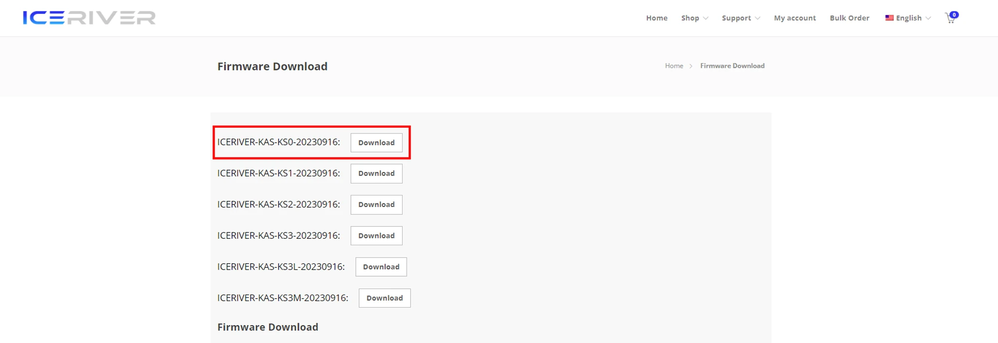

  1. Refer to the manufacturer's instructions and update your ASIC firmware to the latest version available on the official website: https://www.iceriver.io/firmware-download/
  2. After the update, confirm that the ASIC is functioning correctly. Connect a new power supply, add extra cooling, and then proceed with overclocking the ASIC.

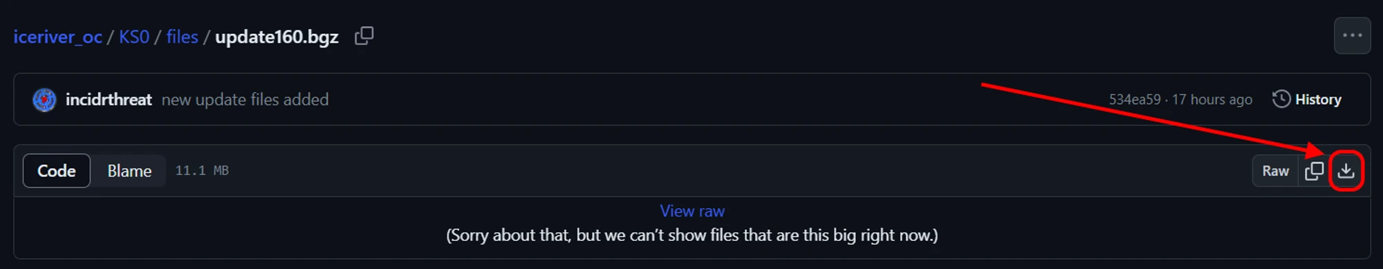

  1. Download the updated file, for instance update160.bgz.
    • SHA256: 69557167DC490588A363989E2AF72C99686A4F459A535B2AAAE5D96D8C607924

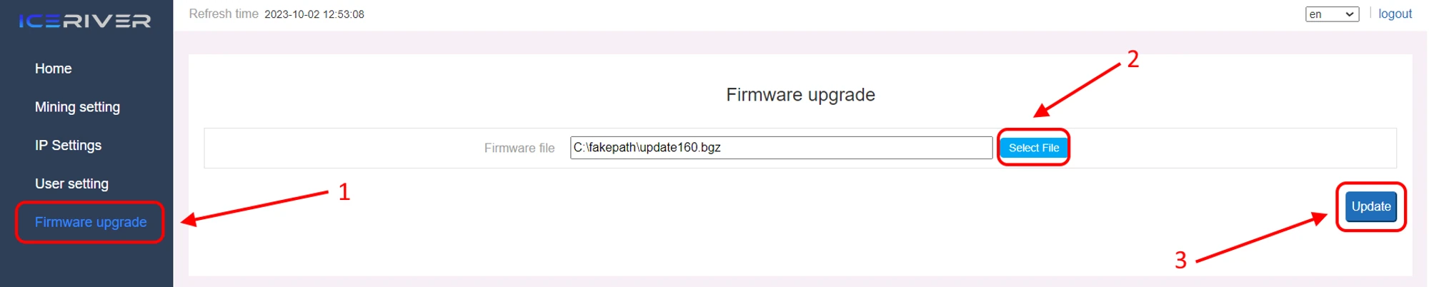

  2. Navigate to ASIC’s webgui “Firmware Upgrade” page.
  3. Click “Select File”, select the downloaded update160.bgz file on your PC, and click the “Update” button.
  4. Wait for the pop-up window to show success and then reboot your ASIC.
  5. Wait for the ASIC to reboot (do not power off during the reboot process). The whole process may take up to 2-5 minutes.
  6. Done! Your ASIC overclocked!
