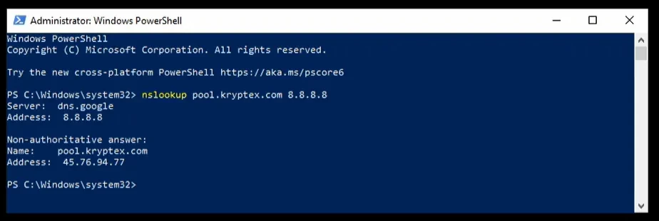

How to Test DNS Before Changing Settings
Open Command Prompt (Win+R, type cmd and press Enter) or PowerShell, then run:
nslookup pool.kryptex.com 8.8.8.8
pool.kryptex.com — the resource you're checking availability for.
8.8.8.8 — the DNS server you're testing with.
If the command returns an IP address, the DNS works and resolves this domain.
If your ISP returns an error or wrong IP, but the DNS returns the correct IP address, changing DNS will solve the problem.

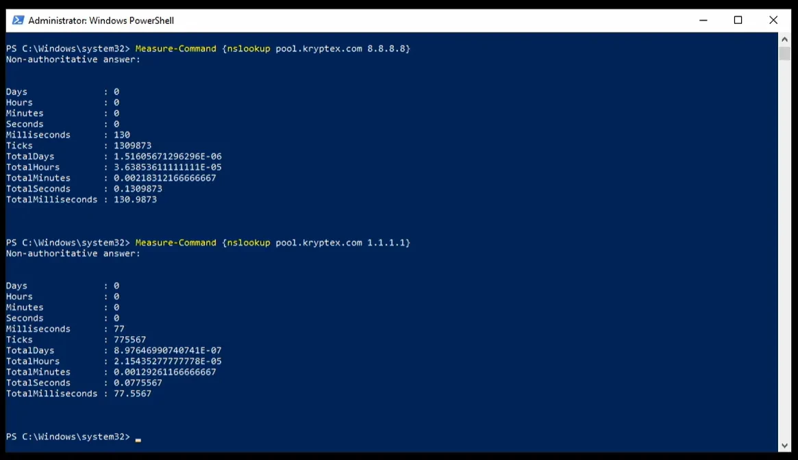

How to Check DNS Speed Before Changing Settings
Measure-Command {nslookup pool.kryptex.com 8.8.8.8}
Compare response times from different DNS servers and pick the fastest. The one with the lower millisecond value is fastest and should be your choice.

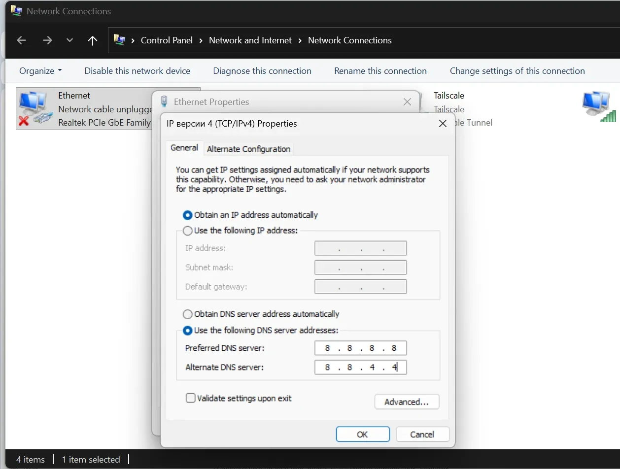

Changing DNS on Windows
Press Win+R, type control and press Enter.
Open "Network and Internet" → "Network and Sharing Center" → "Change adapter settings".
Find your active connection: "Ethernet" for cable or "Wi-Fi" for wireless. Right-click → "Properties".
Select "Internet Protocol Version 4 (TCP/IPv4)" → "Properties".
Switch to "Use the following DNS server addresses" and enter:
  • Preferred: 8.8.8.8
  • Alternate: 8.8.4.4
Click "OK". Done.

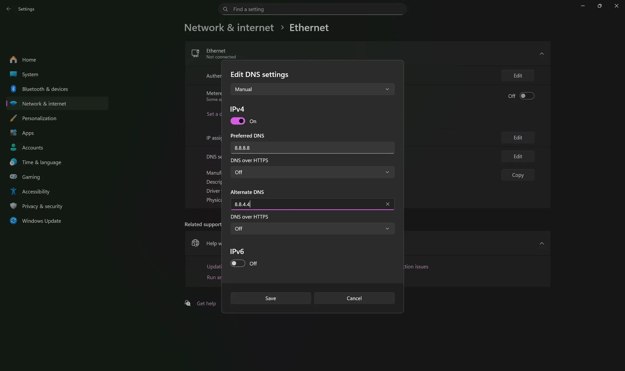

Windows 10/11: Through System Settings
Press Win+I → "Network & Internet".
Select "Wi-Fi" or "Ethernet" → click your network name.
Find "IP settings" → "Edit" → select "Manual" → enable IPv4.
Enter DNS addresses:
Click "Save".

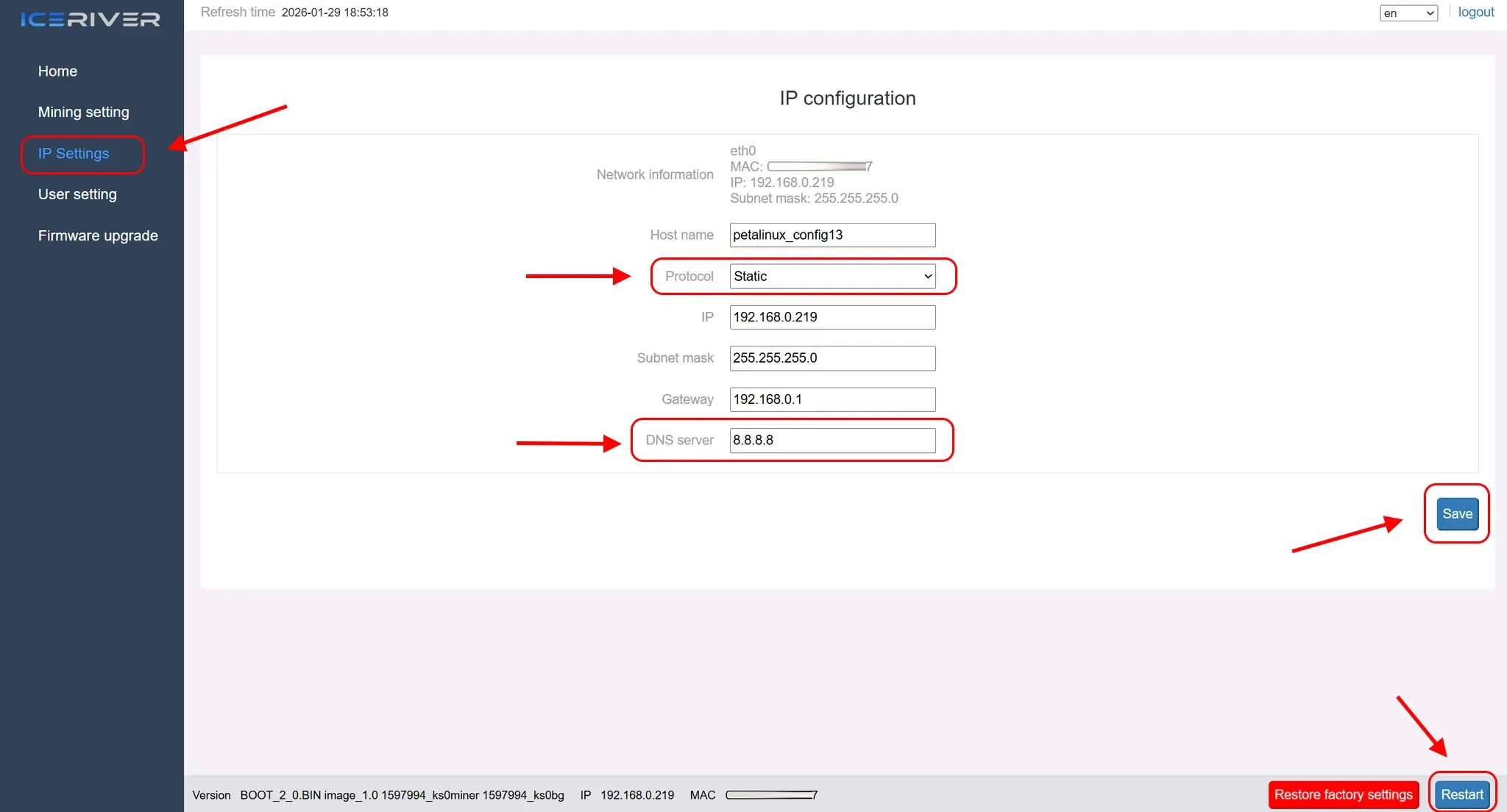

Changing DNS in ASIC Miner
ASICs are configured similarly to routers.
Find your ASIC's IP address. Log into your router and check the list of connected devices. Or use Advanced IP Scanner software.
Open a browser, enter the ASIC's IP address. Log in: usually root | root or admin | admin.
Bitmain Antminer
Network → find DNS Server → enter addresses in DNS1 and DNS2 → Save
Reboot: System → Reboot
MicroBT Whatsminer
System → Network Setting → switch DNS to Static → enter addresses → save → reboot
Innosilicon
Settings → Network → enter DNS Server 1 and DNS Server 2 → save
Canaan AvalonMiner
Configuration → Network → DNS Settings → enter addresses → apply
