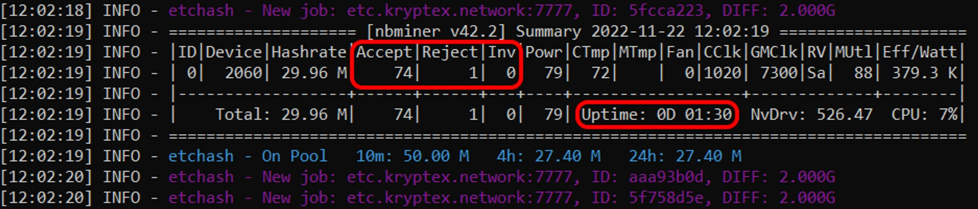

You can go to the Kryptex settings and check the "Show miner windows" checkbox. After that, it is worth waiting for a while for the miner to enter operating mode.
During the usual mining process, the percentage of rejected shares should not exceed 1-2% To get accurate data, you must mine for at least 1 hour (bets for 24 hours). Therefore, the longer a continuous mining session lasts, the more accurate the data.

  1. Share accepted — everything is fine, the pool has accepted a share and it will be paid.
  2. Invalid share — bad share. The GPU made a completely wrong calculation (2+2=5). Usually, such shares are eliminated at the checking stage by a computer and not sent to the pool. On a properly configured GPU, there should be no invalid shares.
  3. Rejected (Stale) share — share was sent to the pool, but the pool rejected it. Most often, this is a share that came to the pool too late, and someone else has already found the same one.
