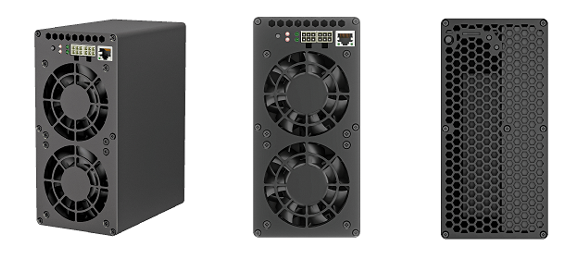

Goldshell has introduced the world's first ALPH (Blake3) mining ASICs — Goldshell AL BOX, AL BOX II, AL BOX II PLUS, AL BOX III. These ASICs has high energy efficiency, high income and low noise, which makes them suitable for home use.

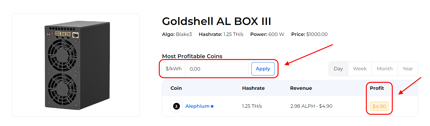

Goldshell AL BOX, AL BOX II, AL BOX II PLUS, AL BOX III Profitability
Check the profitability of Goldshell AL BOX III ASIC on the mining calculator.

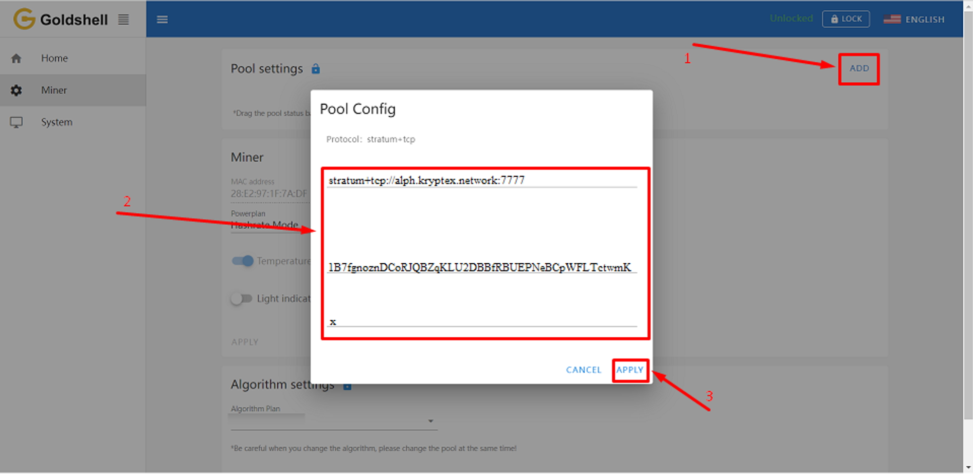

Goldshell AL BOX, AL BOX II, AL BOX II PLUS, AL BOX III Settings
Go to “Miner → Pool Setting → Add” tab to setup your ASIC.
| Coin | URL | Miner Name | Password |
x or leave blank |
1B7fgnoznDCoRJQBZqKLU2DBBfRBUEPNeBCpWFLTctwmK.goldshell where
1B7fgnoznDCoRJQBZqKLU2DBBfRBUEPNeBCpWFLTctwmK— your wallet address,goldshell— Your ASIC name.
Click “Apply” to save the settings and start mining.

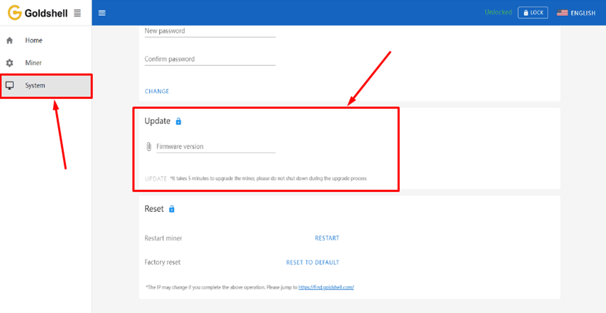

Goldshell AL BOX, AL BOX II, AL BOX II PLUS, AL BOX III Firmware Update
Go to the manufacturer's Github and download the required firmware: https://github.com/goldshellminer/firmware
Open the page for updating “System → Update”, select the downloaded update.
