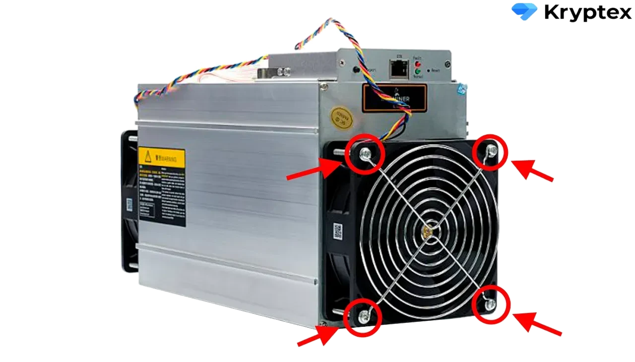

Remove protective fan grilles, if present, by unscrewing the four bolts.

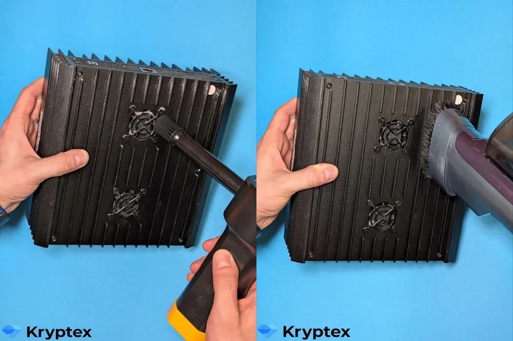

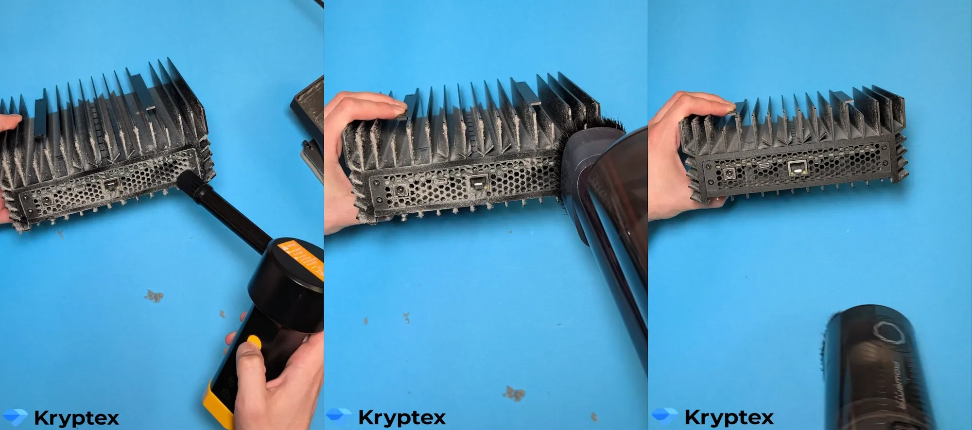

Use compressed air:
Gently blow compressed air or air from a compressor through the ventilation holes to remove dust.
Avoid holding the canister too close to prevent condensation.
Stabilize the fans to prevent them from spinning, which could generate current in the ASIC board.
Brush away dust:
- Use a soft brush to gently remove any remaining dust from the circuit boards and fans.
- Work carefully to avoid damaging fragile components.
Optional vacuuming:
If accessible, set your vacuum cleaner to low power and carefully extract dust from hard-to-reach areas.

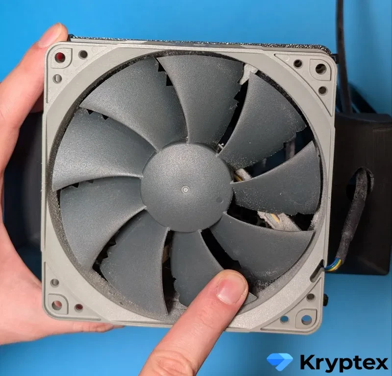

Inspect ventilation:
Ensure the fans are functioning correctly and free from obstructions that might hinder their movement.
