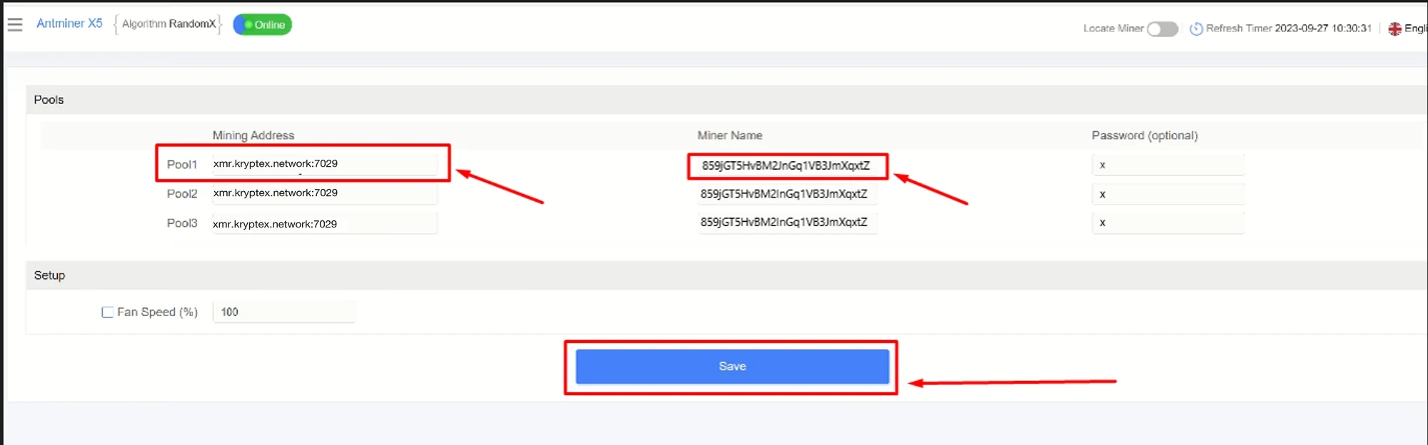

Bitmain Antminer X5 Settings
Go to “Settings” tab to setup your ASIC.
Coin Mining Address Miner Name Password
XMR xmr.kryptex.network:7029 or stratum+tcp://xmr.kryptex.network:7029 XMR_WALLET_ADDRESS.WORKER_NAME x or leave blank
859jGT5HvBM2JnGq1VB3JmXqxtZGqVEyHiumzvrToF2idouNfMZeZ2XD1T1JYnWgnn6GoNqTdNDzCNRCPqvd5EUaSjipRcV.x5 where
  • 859jGT5HvBM2JnGq1VB3JmXqxtZGqVEyHiumzvrToF2idouNfMZeZ2XD1T1JYnWgnn6GoNqTdNDzCNRCPqvd5EUaSjipRcV — your wallet address;
  • x5 — Your ASIC name on a pool.
Click “Save” to save the settings, and then click “Restart Miner” to restart the ASIC.
