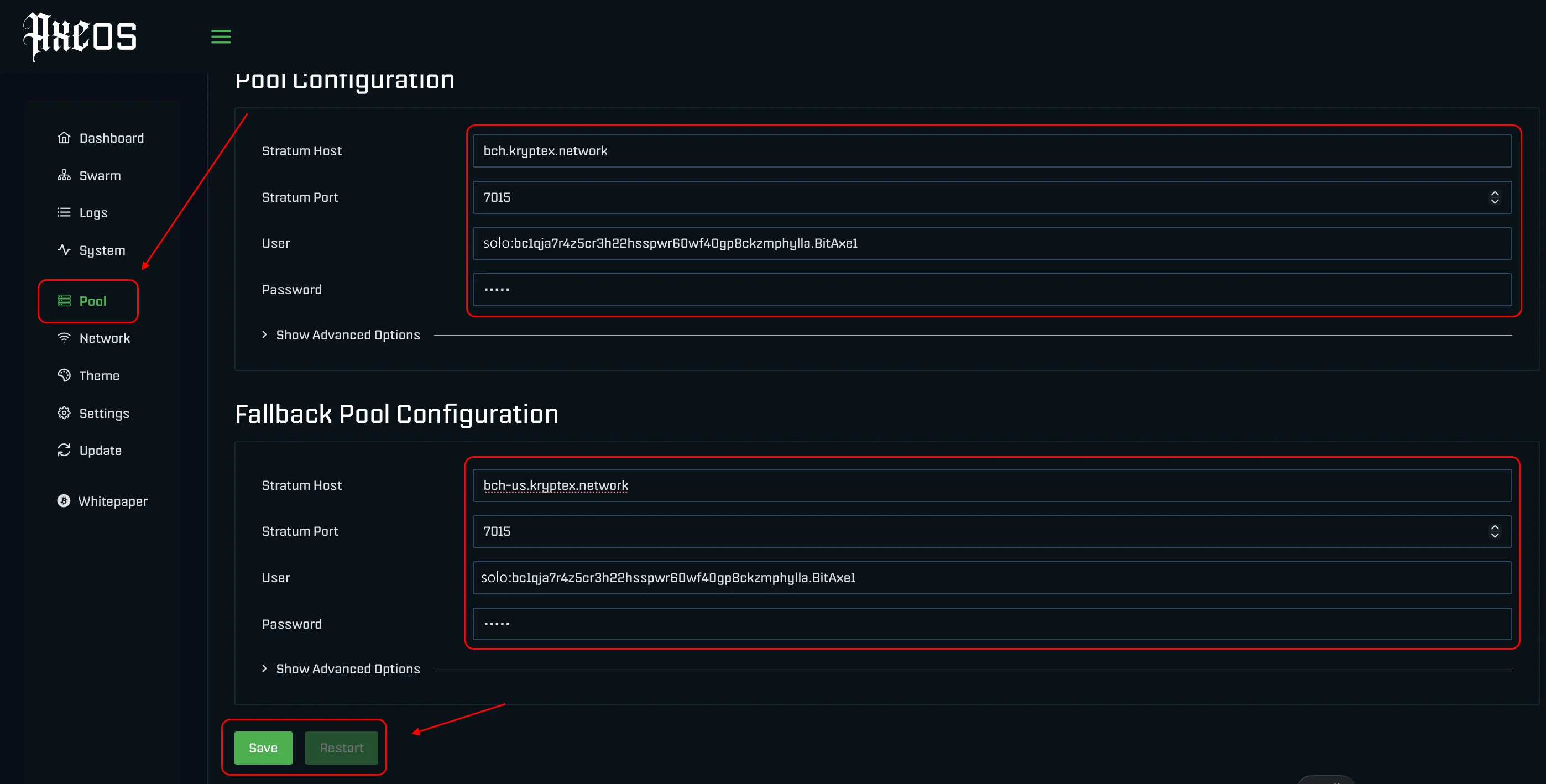

  5. Configure pool settings:
    • Open the Settings section.
    • AxeOS provides 2 pool slots — primary and backup (failover).
    • Fill in both slots so the miner switches over automatically if one pool goes down.
    • Fields per slot:
      • Stratum URL — pool address without the stratum+tcp:// prefix, e.g., bch.kryptex.network.
      • Stratum Port — pool port, e.g., 7015.
      • User — wallet address and worker name in the format qzm6...address.Bitaxe601, or solo:qzm6...address.Bitaxe601 for solo mining.
      • Password — x or leave blank.
    • ASIC Frequency — leave the default at 525 MHz (can be raised to 550–600 MHz with adequate cooling).
    • Core Voltage — leave the default at 1150–1250 mV.
    • Click Save, then Restart — the Bitaxe will reboot with the new settings.
