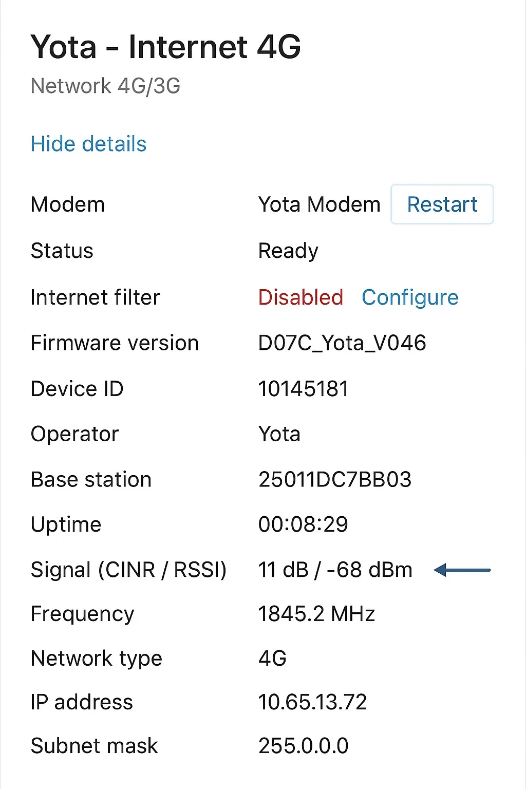

Let’s use the Keenetic Hero 4G+ router as an example.
Go to System Monitor → Internet — here you’ll see your signal strength and connection parameters.

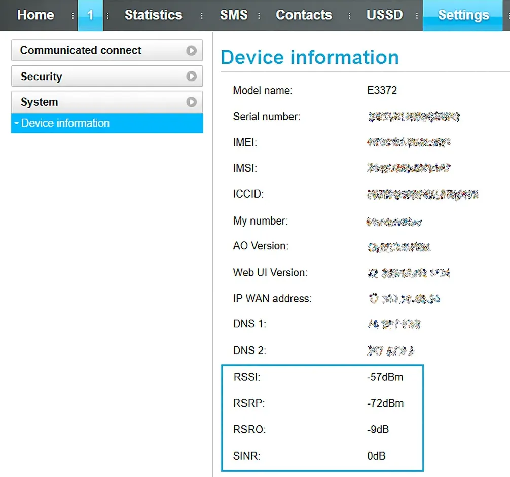

If you're using a USB modem, access its web interface via its IP address. The IP is usually printed on the device or under its cover.
LTE Parameters and Recommended Values
- RSSI — Measures the signal strength received by the modem (in dBm). For stable operation, it should be at least −85 dBm. The closer to zero, the better.
- RSRP — Indicates the signal power from the base station. A good value is above −120 dBm. Lower values may cause connection drops.
- RSRQ — Reflects signal quality — how “clean” the signal is. Measured in dB: higher is better.
- SINR (or CINR) — Signal-to-noise ratio. Minimum for stable connection is 10 dB. If it’s negative, noise outweighs signal — expect slow or no internet.
- CQI — Channel quality indicator, rated from 0 to 15. Higher values mean faster and more stable connections.

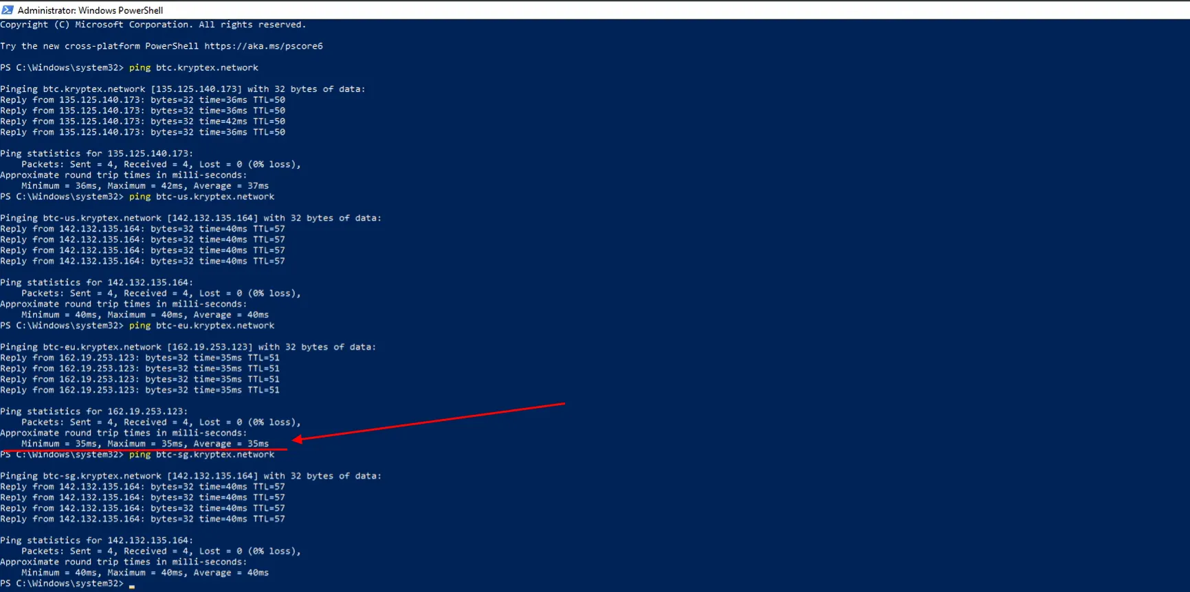

To check ping, use a computer connected to the same network as your ASIC or mining rig.
Open CMD or PowerShell and run:
ping pool_address

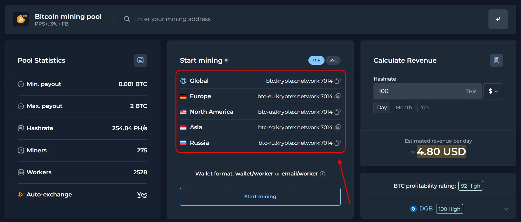

Example for Kryptex Bitcoin Pool:
Visit the pool page — pool.kryptex.com/btc
Test ping to all pool regions:
ping btc.kryptex.network ping btc-us.kryptex.network ping btc-eu.kryptex.network ping btc-sg.kryptex.networkChoose the address with the lowest ping — e.g.,
btc-eu.kryptex.network — 35 ms.

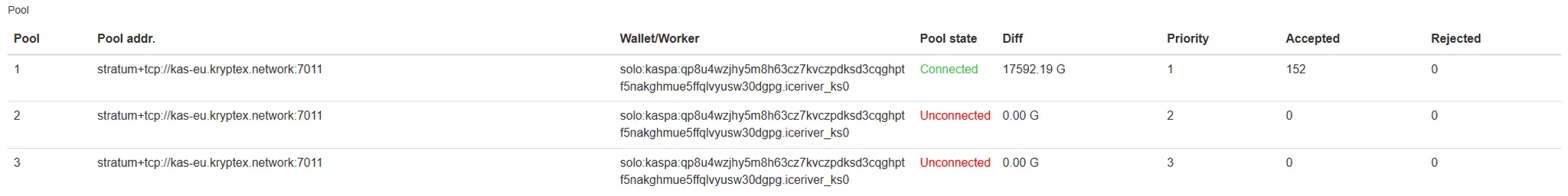

2. Set Up Backup Pools
Most miners allow you to configure three pools: Pool1, Pool2, Pool3.
Use the lowest-ping pool as your primary, and add backup addresses in the other fields.
If the connection drops, your miner will automatically switch to a backup.
