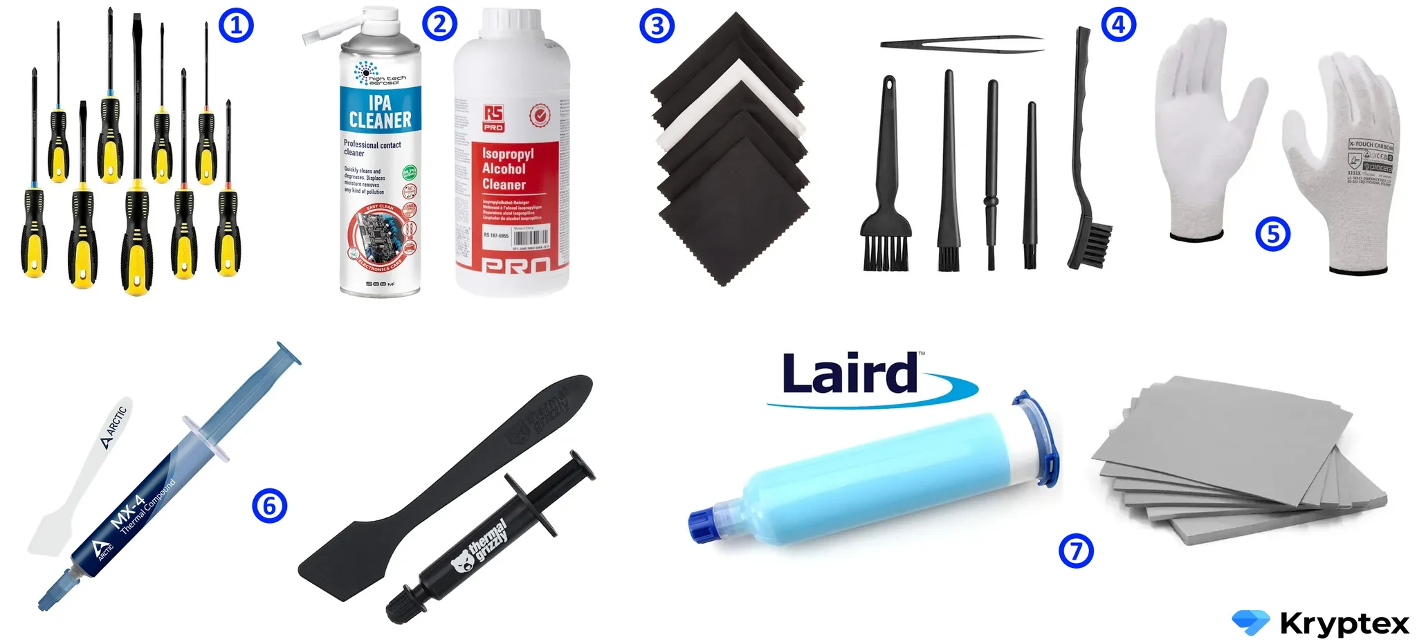

Tools for ASIC Maintenance:
  1. A screwdriver set or a drill with interchangeable bits is needed.
  2. Isopropyl alcohol at least 90% concentration.
  3. Soft cloth or cotton swabs.
  4. Soft brush for dust removal.
  5. Antistatic gloves (recommended).
  6. New thermal paste (e.g., Arctic MX4/MX6 or Thermal Grizzly Kryonaut with high thermal conductivity).
  7. Thermal pads (liquid Laird 607 for universal use, or denser ones if the thickness is known). You can measure pad thickness using a caliper or modeling clay.
  8. A plastic card or plastic spatula (usually included with the thermal paste) is used to remove the old thermal paste and apply the new paste.

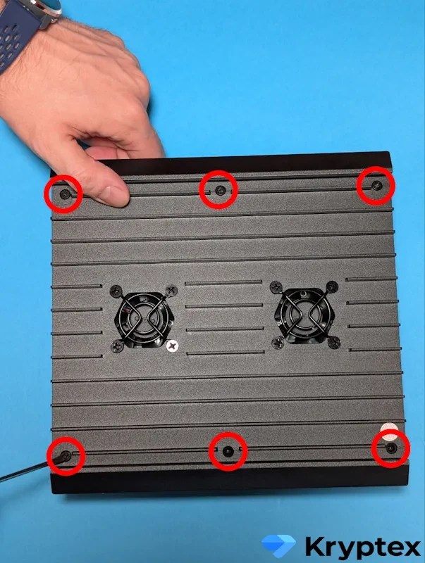

  • Remove the casing cover: It's usually secured with screws.

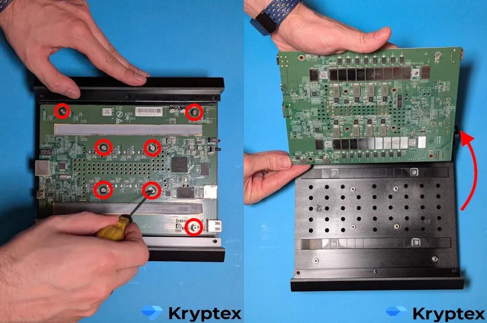

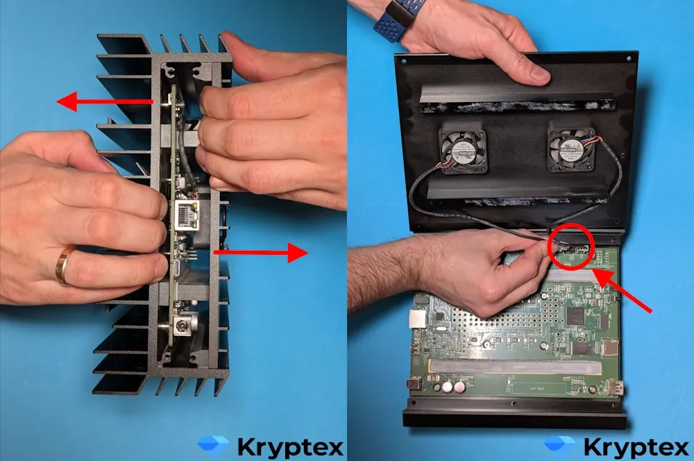

  • Access the motherboard and radiator: Carefully disconnect fans, wires, and other components to clear access.
Removing the Radiator
  • Unscrew the bolts: The radiator is fastened to the chips using mounting screws. Unscrew them in a diagonal (criss-cross) pattern to avoid uneven pressure or damaging the chips.
  • Gently detach the radiator: Don't attempt to force it off if it sticks to the chip. Instead, gently wiggle it from side to side. It may take time, but this method is safer.

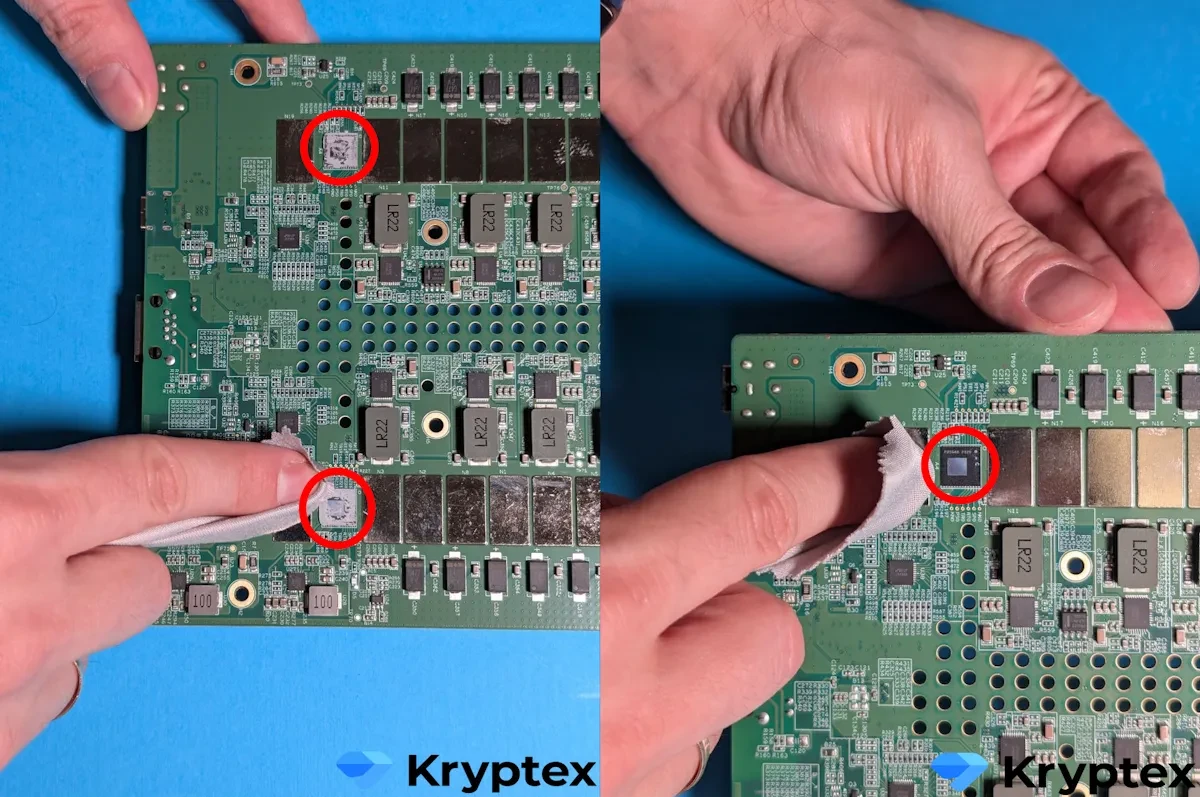

Removing the Old Thermal Paste
  • Clean the chips and radiator: First, remove the old paste with a plastic spatula or card. Then, use isopropyl alcohol and a soft cloth to clean the surface until it shines. Avoid using sharp, metal, or abrasive tools to prevent damaging fragile parts!
  • Ensure no residues of old paste remain, as they may affect heat dissipation.

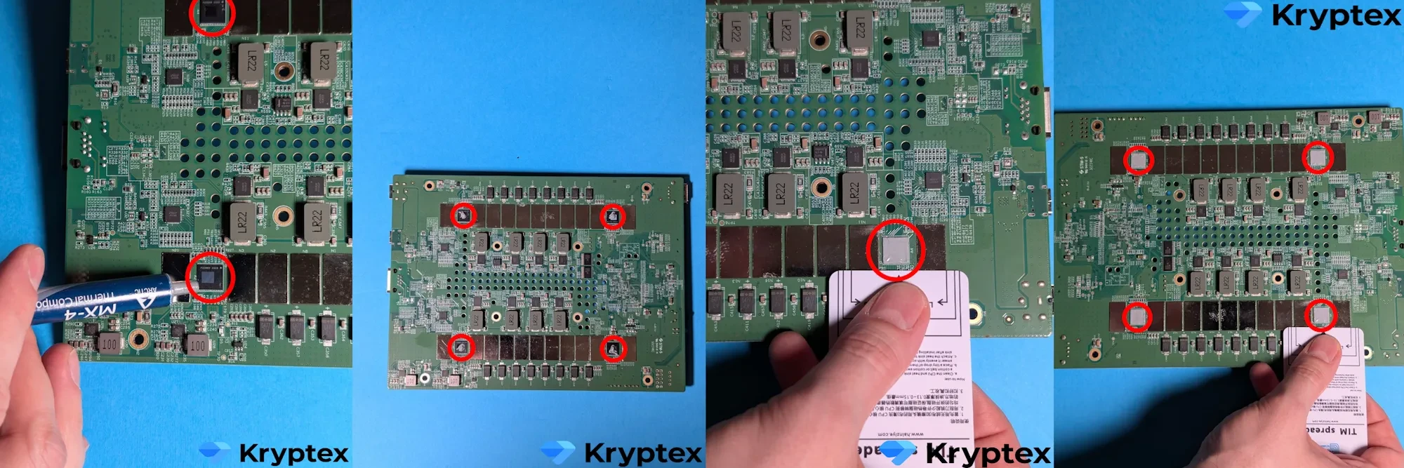

Applying the New Thermal Paste
  • Amount: A pea-sized drop on each chip will suffice.
  • Distribution: You can leave the paste centered as the radiator will distribute it evenly upon installation. Alternatively, carefully spread it into a thin layer with a plastic spatula.

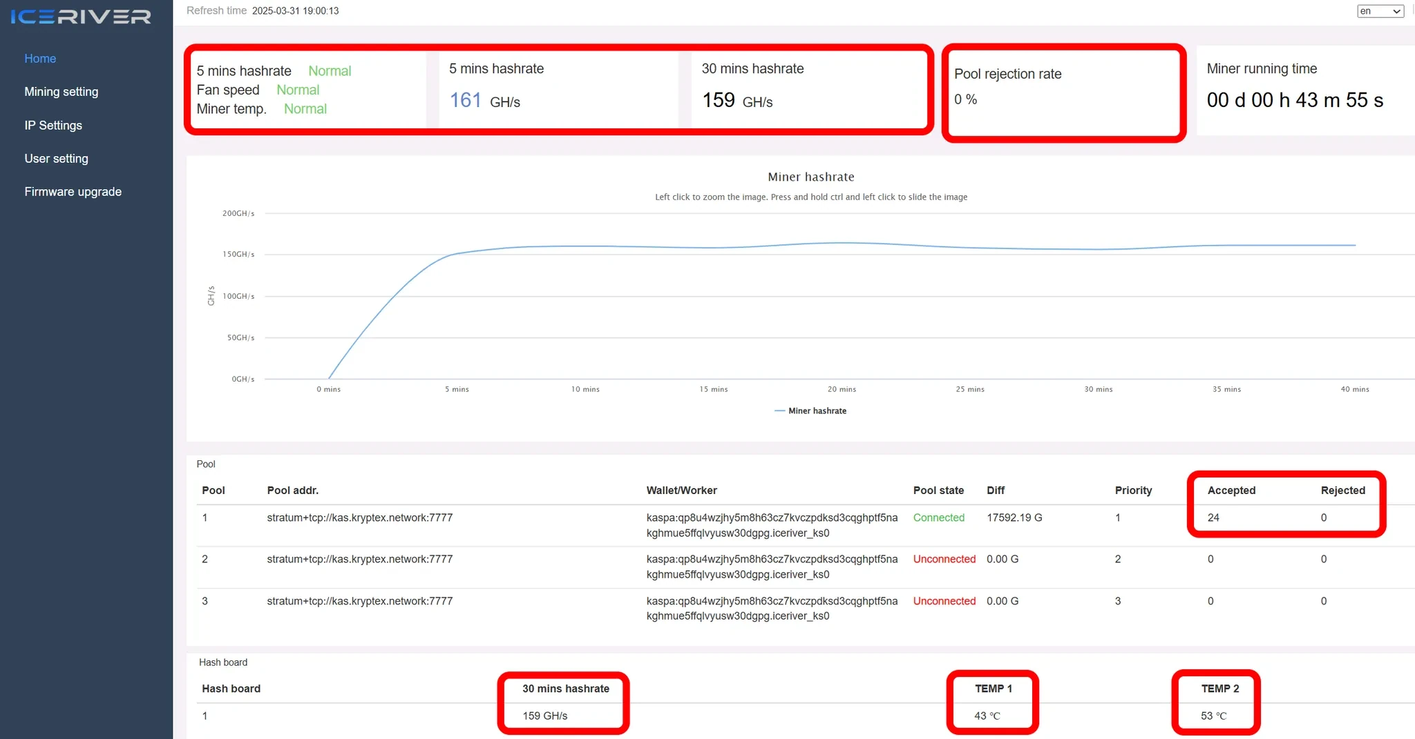

Testing
  • Plug the device in and turn it on. Ensure chip temperatures are stable and fans are working correctly. Observe its performance closely for the first 24 hours.
