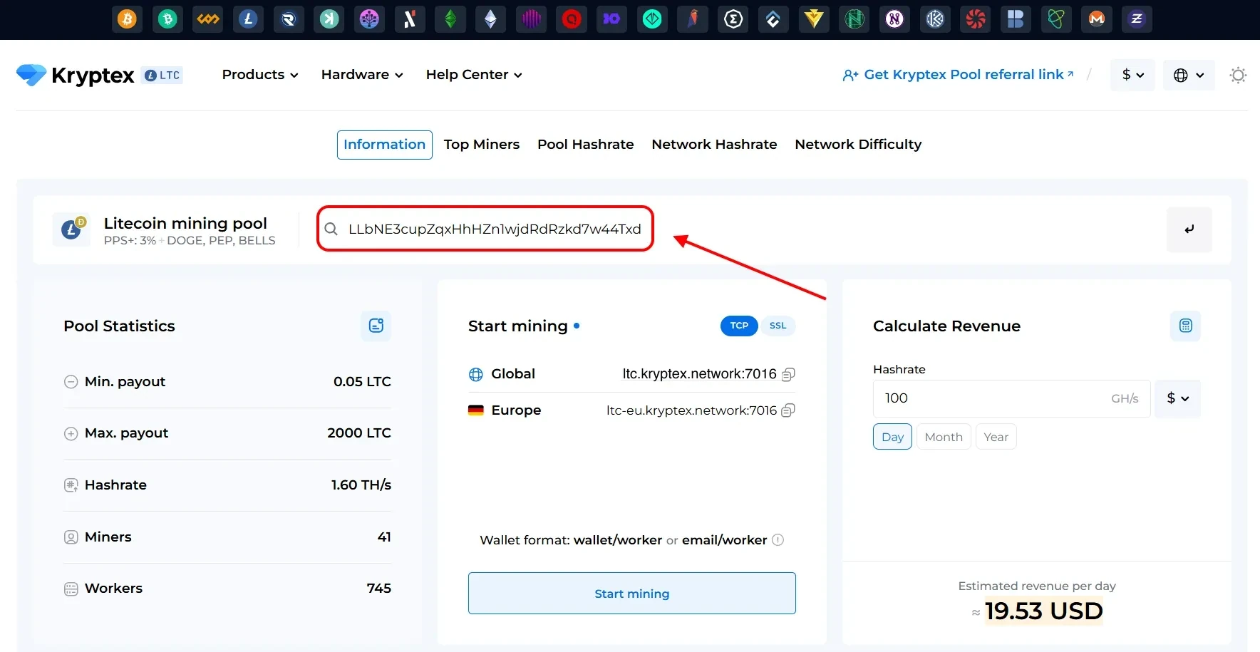

- Get pool address
Go to the main page of Kryptex Pool — https://pool.kryptex.com/
Select the coin you will mine.
Select the pool address in your region (if you are not sure — take the first one on the list).
Copy and paste it into the Pool Address field.

If you mine to a wallet
Open the Kryptex pool — https://pool.kryptex.com/
Select a coin (for example, LTC).
Enter the wallet address in the search and click “Find”.
On the statistics page you will see:
